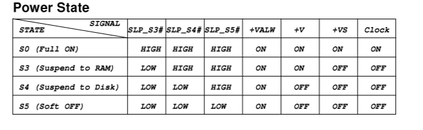

pinag aralan state ng laptop base sa schematic..
at ito yun

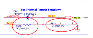

at dito ko nakita wala itong 3v sa S5 state...
trace ko at ito ung faulty component..
RB16 or resistor 16 1K ohms at RB17 or resistor 17 dapat 1M ohms pero 0 ohms
ibig sabihin nag open ung resistor..
see image sa baba yan ung RB17
replace ng exact value and size 0402 ung may arrow nd done..
