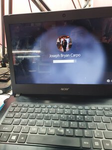

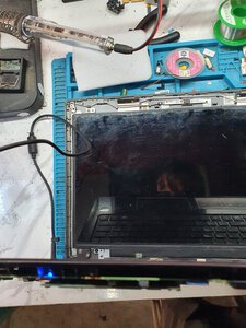

Action taken
Basic trobleshoot
Try external monitor negative
Try ram at lcd negative
Check voltage in ram at mainreg 3v 5v all present

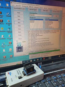

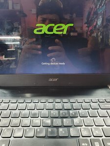

Solution...
Last option flash bios done......
NOTe: backup first the stockrom bios incase na d bios ang cra maibabalik sa dati sa orig, stock bios....
Finesh product...
