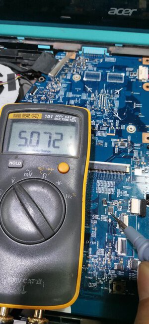

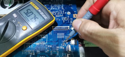

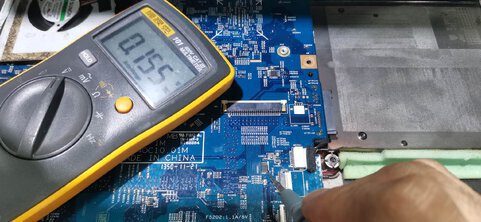

Acer E1 came from the dealer with the issue of the USB port not functioning even though the client tell him..

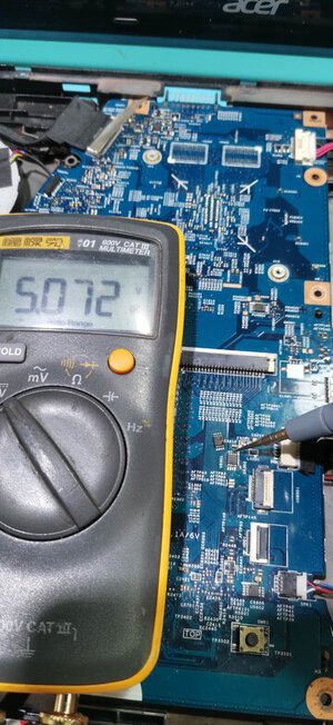

upon checking the said port does nothing even though a lot of USB drive is used to test.
now I decided to open it up to check what the problem is.

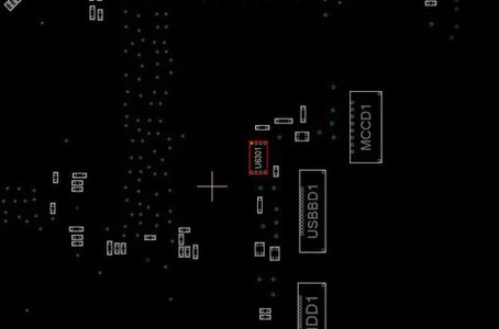

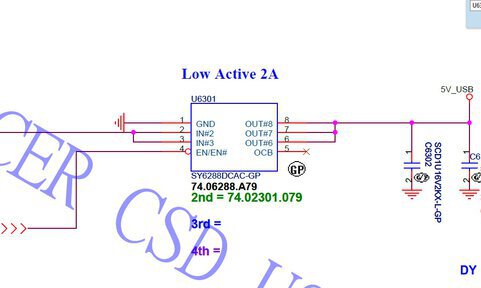

on checking and base in BV and the power of schematic, I found out that these tiny stupid things won't work as is a job. lols

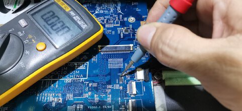

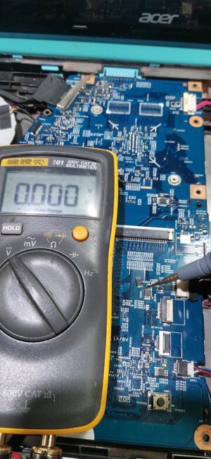

checking those per pin and I got 0.145mv instead of 5v (5v_usb) missing causing both USB ports not to give their job needs to the user.
Solution: Basex time.. replace that fucking tiny ic and solve and pass the mission.. got chaa em al
