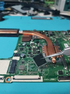

While the client is typing during a call the device gave to the customer various keyboard combination errors before turning off.
Sometimes knowing the truth is necessary to begin the difficult part of being a techie.

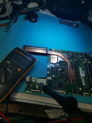

Problem: No electricity or stanby voltage. However, we are aware that in this model, the 3valws always has a reading whether it is plugged in or running on batteries, but this one? Naah..

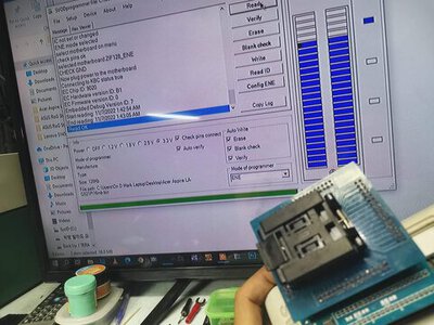

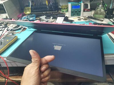

Pull out the sio, flash EC firmware KB9032 using svod and that solved the issue.
