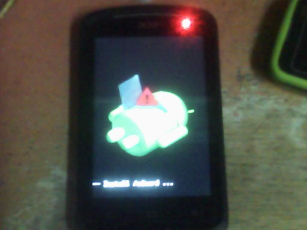

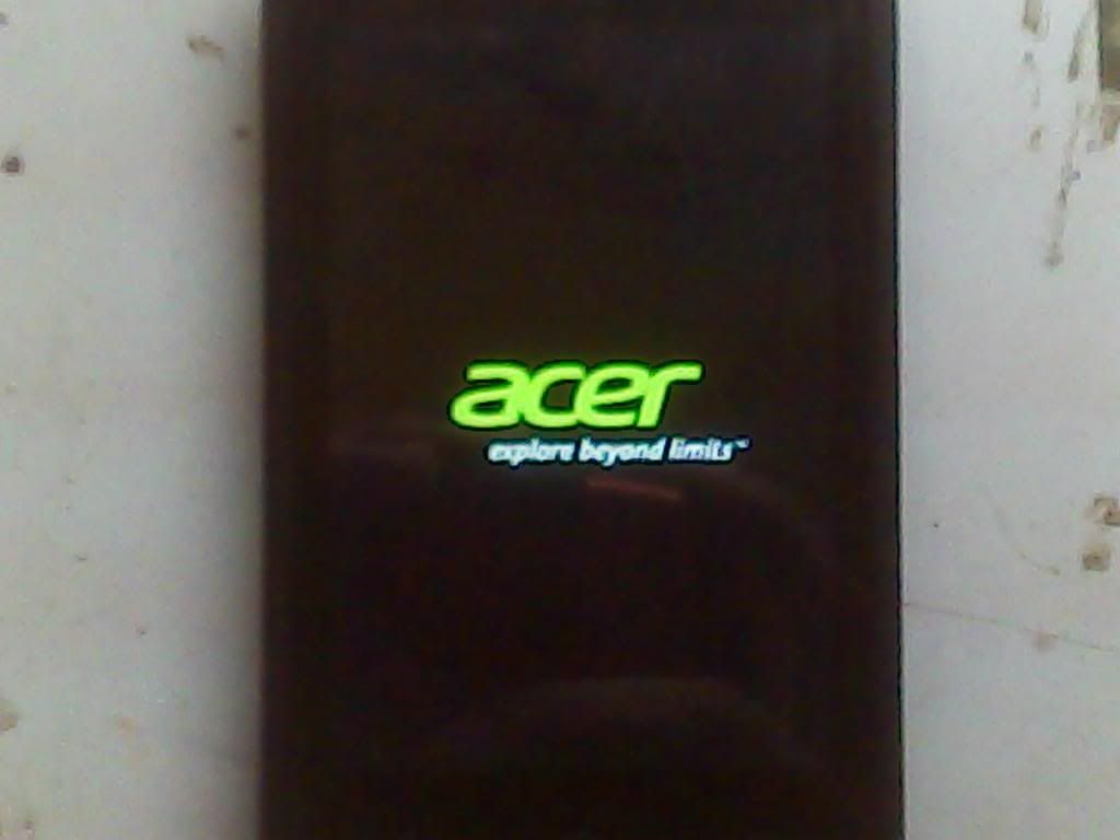

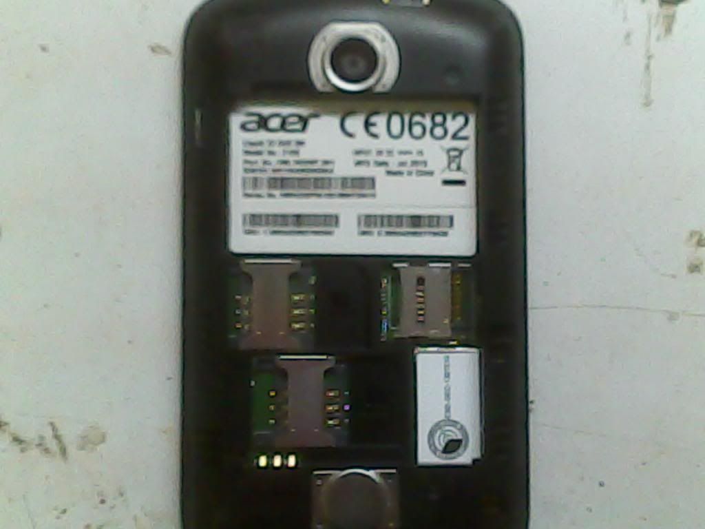

Model : Acer Z120 A.K.A Z2 Duo
Problem: hang on acer logo
look at this pics
yan po yung itsura nya nung madala sakin
so first thing to do hard reset di po ba???
but sad to say hard reset is no luck hang parin :(

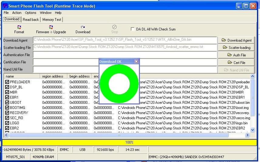

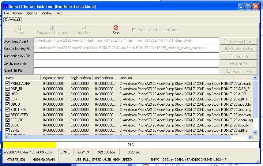

so no possible solution kung hindi flashing so search and tanong ako.... at luckily may isang kaibigan na nag bigay sakin ng firmware...

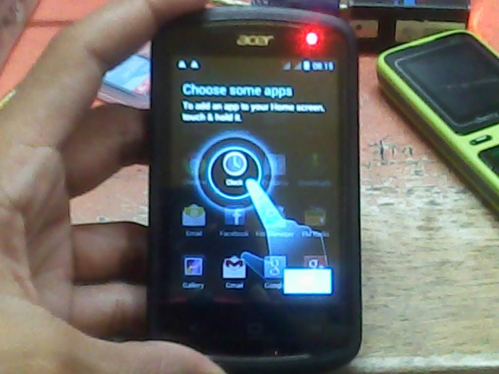

then flash na using SPtool

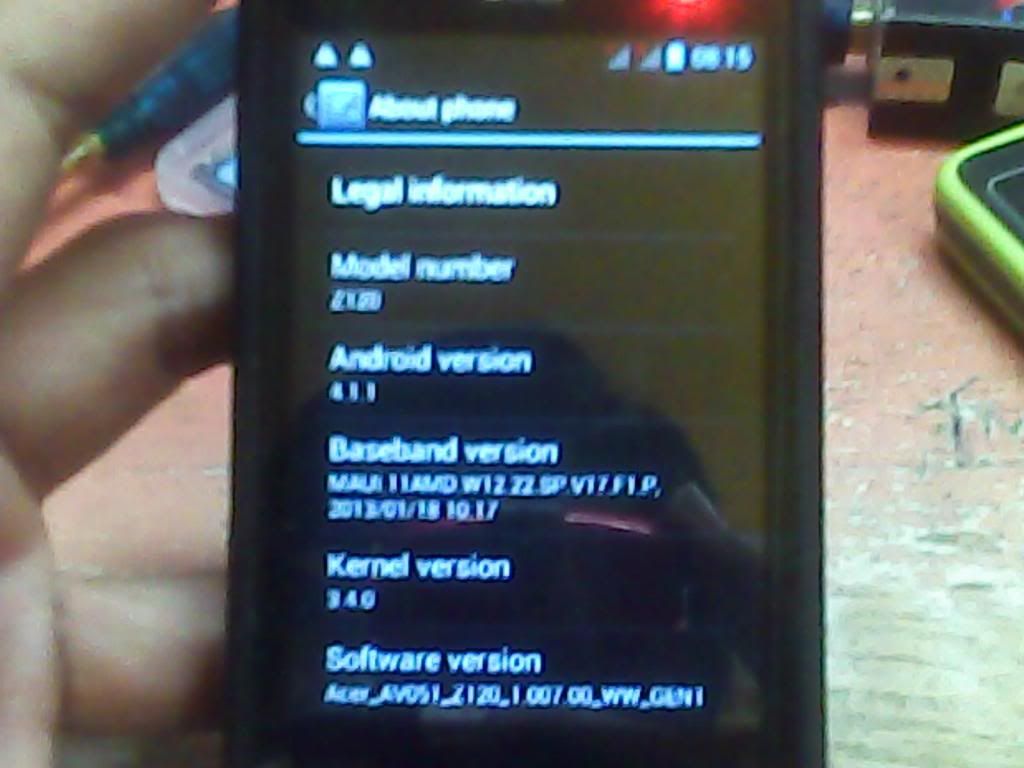

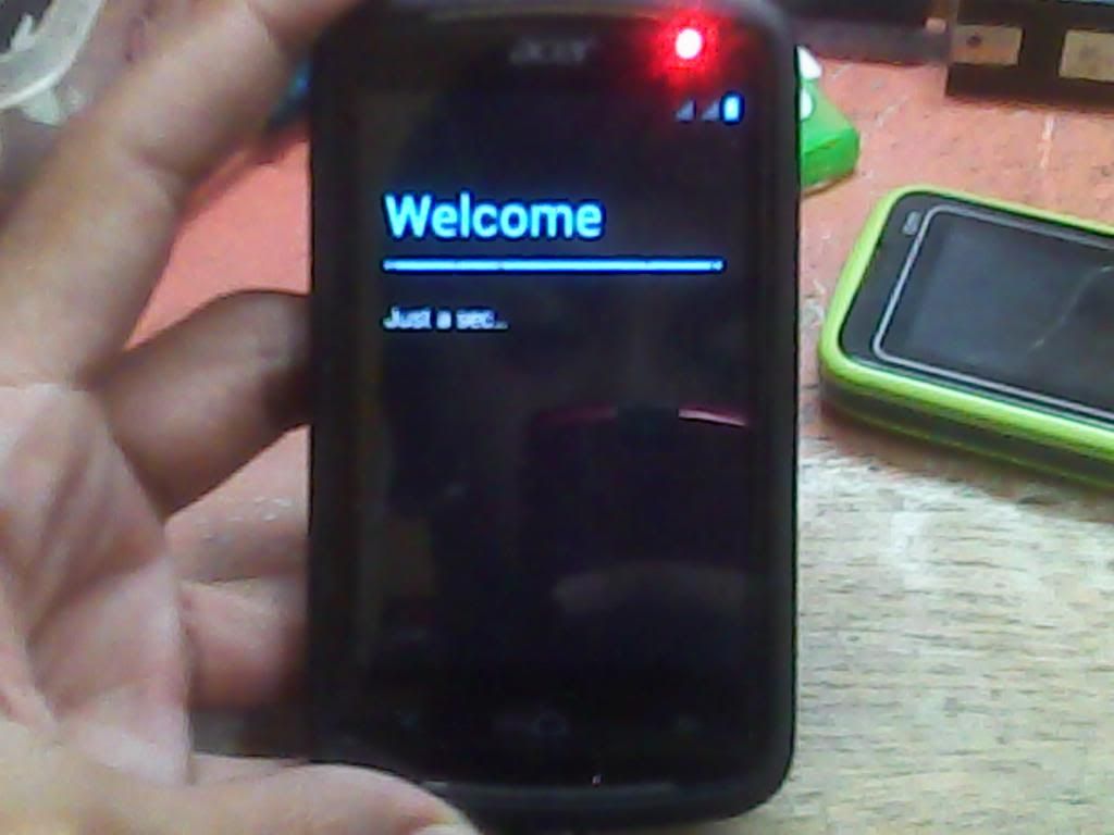

after several minutes of flashing here the finish product
All working fine call, text, wifi, and cam..
