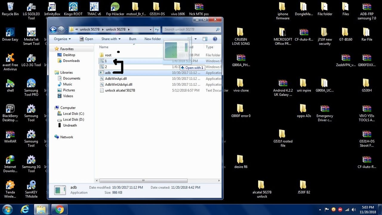

Una Download muna to https://drive.google.com/file/d/13FEp_R6pz7lFq4DvThhHyB10ohjFSPof/view
extract yung nadownload tapos sundan lang nasa picture,need naka debug ang unit at make sure naka install ang driver.
drag nyo yung adb papunta sa number 1 dapat nakakonek na si cp bago gawin tulad ng nasa picture

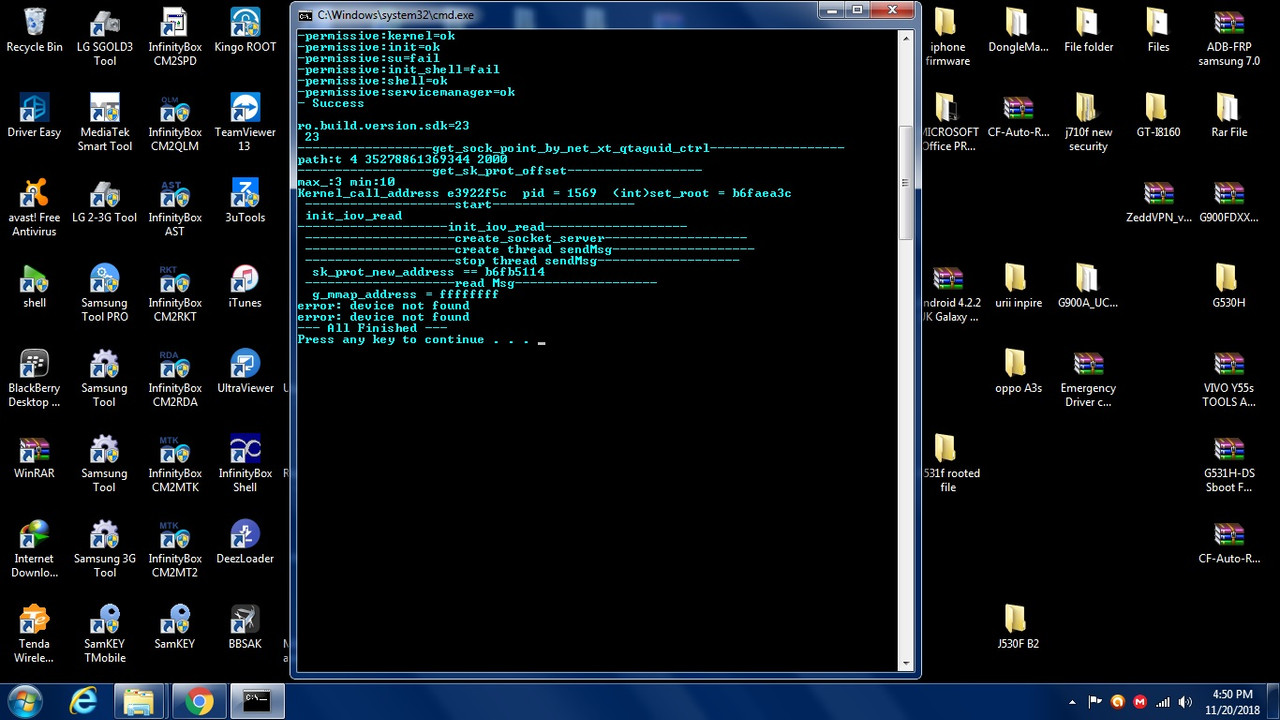

Sunod drag uit si adb papunta naman sa number 2
Hintayin lang matapos
