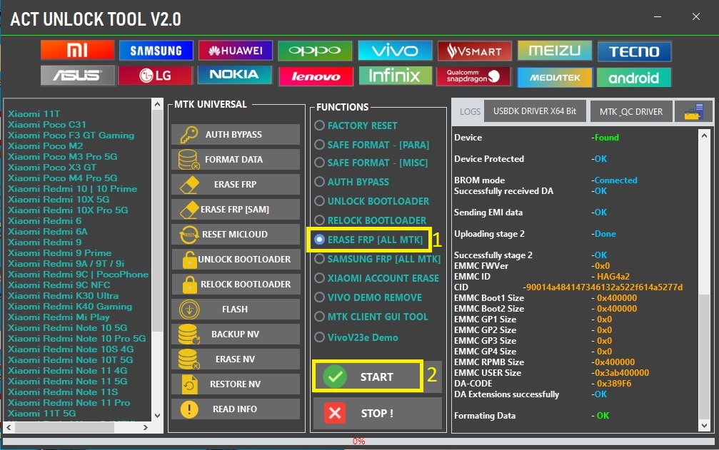

open po yung act unlock tool
select "erase Frp [all mtk]"
click start
off mo yung unit
press boot key
insert usb. antayin matapos

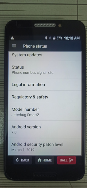

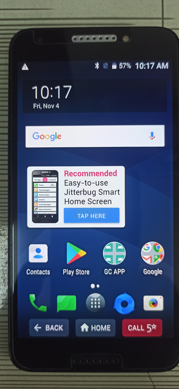

ito ang proof
click start
off mo yung unit
press boot key
ito ang proof
