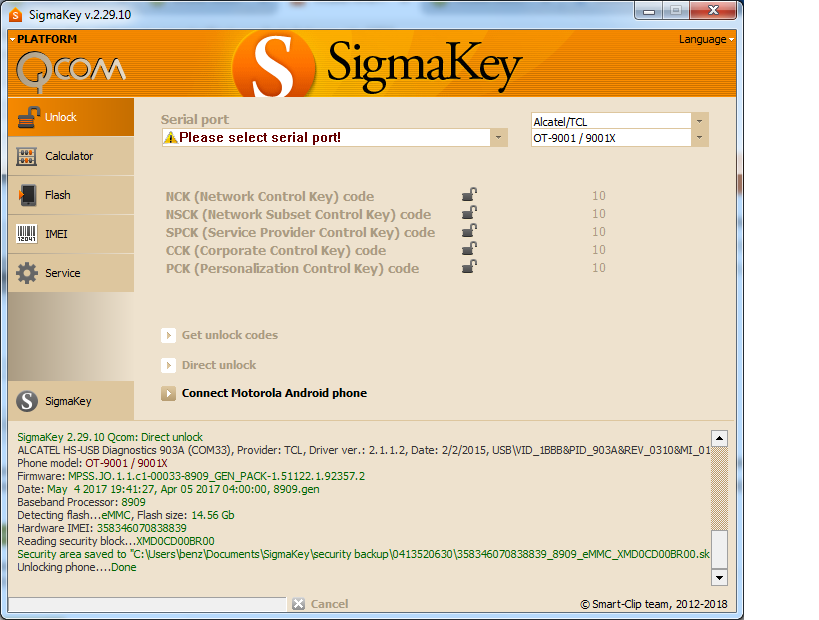

power on phone - in phone dialer dial ###2324# to enable diagnostic port
open sigma key -
platform select qcom
model select ot-9001x
phone power on mode
connect to pc
select alcatel diagnostic port
click direct unlock
wait until done
SigmaKey v.2.29.10
413520630 Sigma dongle 2.29, Initializing...OK
Pack 1: Not activated
Pack 2: Not activated
Pack 3: Not activated
Unique promotional offer for our best clients.
Buy Sigma Pack 1+2+3 Activation for special price - 179.99 USD only.
Get maximum functionality from your Sigma.
--------- 2019-02-04 10:58:46 ---------
SigmaKey 2.29.10 Qcom: Get unlock codes
Phone model: OT-9001 / 9001X
Connecting...Phone not found
--------- 2019-02-04 11:02:21 ---------
SigmaKey 2.29.10 Qcom: Direct unlock
--------- 2019-02-04 11:06:07 ---------
--------- 2019-02-04 11:07:23 ---------
--------- 2019-02-04 11:12:18 ---------
ALCATEL HS-USB Diagnostics 903A (COM33), Provider: TCL, Driver ver.: 2.1.1.2, Date: 2/2/2015, USB\VID_1BBB&PID_903A&REV_0310&MI_01
Firmware: MPSS.JO.1.1.c1-00033-8909_GEN_PACK-1.51122.1.92357.2
Date: May 4 2017 19:41:27, Apr 05 2017 04:00:00, 8909.gen
Baseband Processor: 8909
Detecting flash...eMMC, Flash size: 14.56 Gb
Hardware IMEI: 358346070838839
Reading security block...XMD0CD00BR00
Security area saved to "C:\Users\benz\Documents\SigmaKey\security backup\0413520630\358346070838839_8909_eMMC_XMD0CD00BR00.skb"
Unlocking phone....Done
