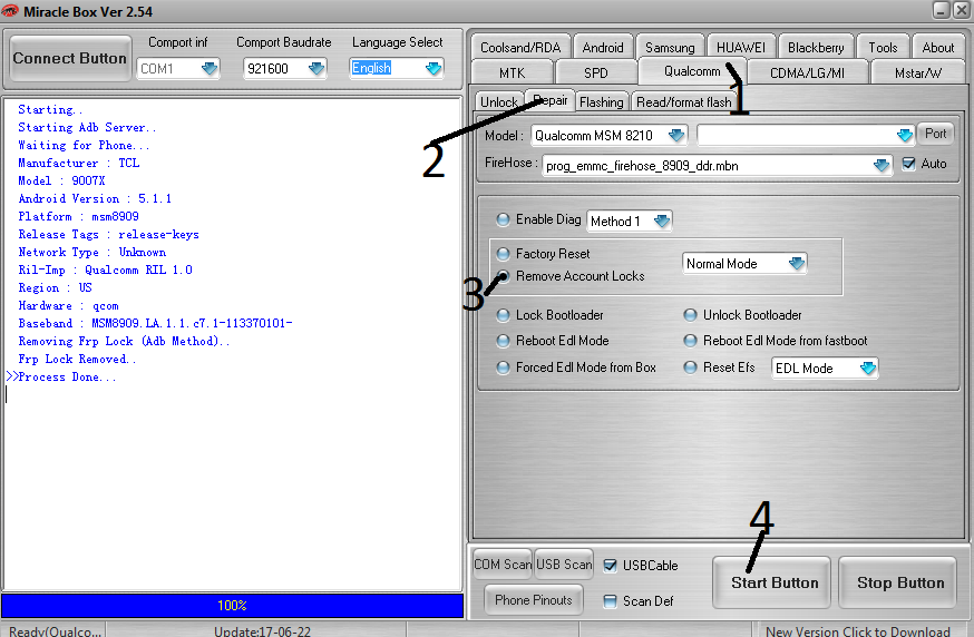

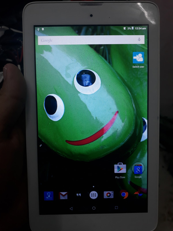

Share Ko lang ONE TOUCH ALCATEL TAB 9007X FRP problem....
talagang problema kala ko diko magagawa na try ko kay CM2,UMT..bibigay kuna sana,naiisip ko
Kay MIRACLE CRACK.at di nman nabigo...tyamba mode
procedure
install driver ADB
Open Miracle
Click Qualcomm
Click Repair
Model : Quanlcomm SMS 8210
FireHOSE :prog_emmc_firehose_8909_ddr.mbn
Click Auto
Click Remove Account locks
Hit start button

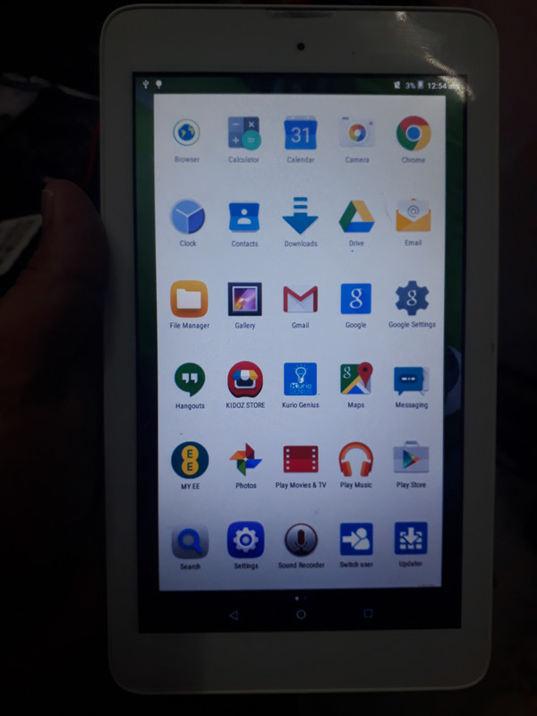

DONE!!
