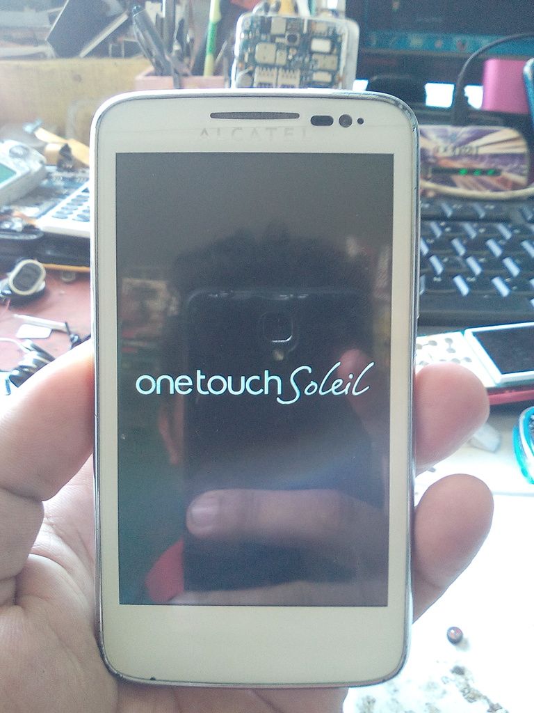

default-kusang mag restart pag open ng PHone.
ito c alcatel 5021e lock for Sun..
kapag may sftp tool na po kayo,sama muna ang sangkap nito.
download for this very tested firmware, Credit to the Orig uploader,
http://www.mediafire.com/download/40mkm7vivcgex28/OT-5021E+firmware.rar
PROCED TO FLASH,

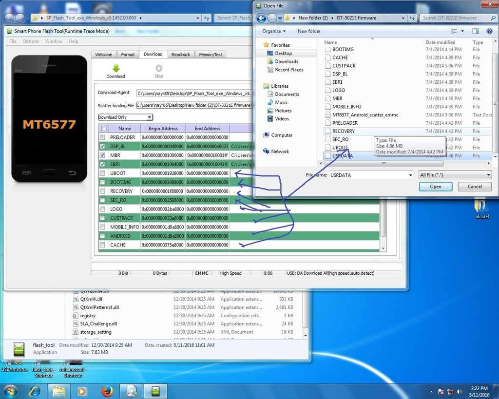

OPEN SPFT,LOAD SCATTER FILE,ganito po tingnan ang screen shot
load mo bawat isa yong empty file.
kapag tapos na ma load lahat,tick download only.then hit download.

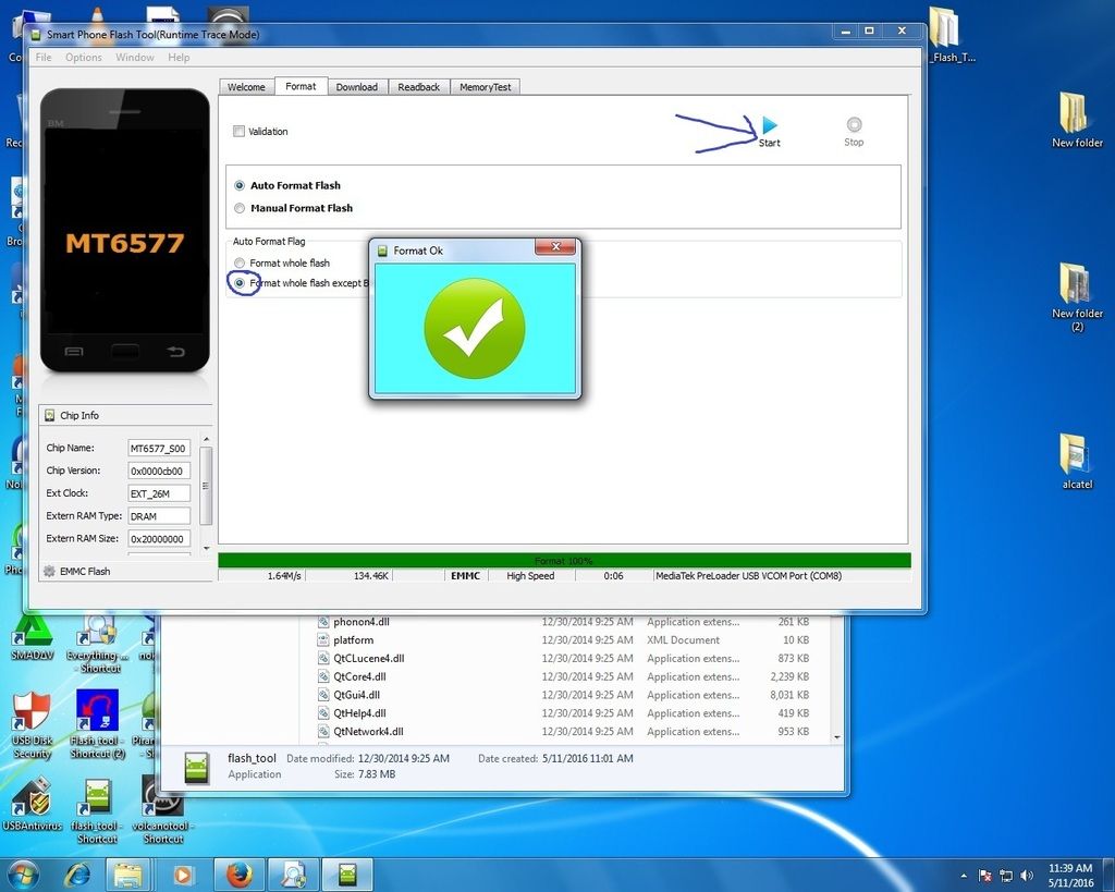

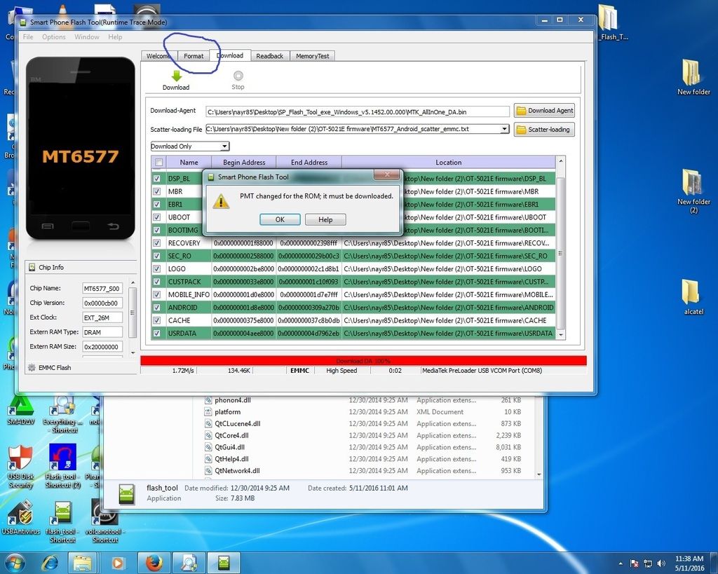

kapag ganyan po lumabas,go to Tab Format nasa screen shot
format,tick START.

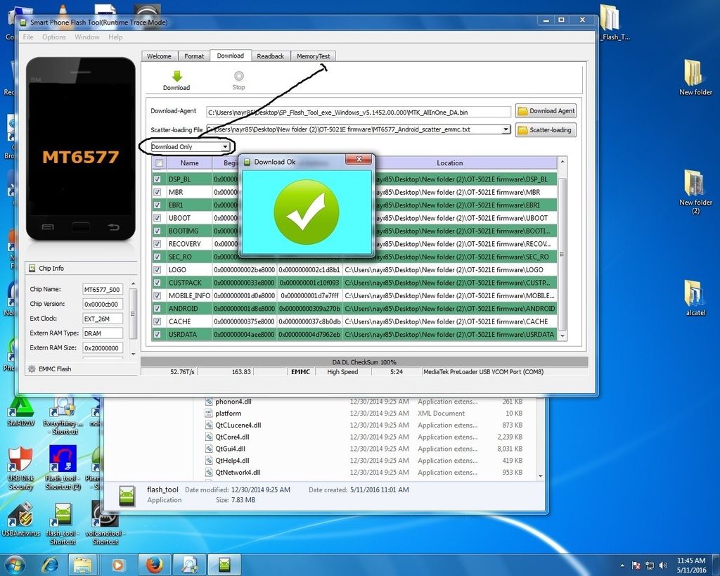

tapos,proced to flash after format,select Download only.then hit download.
finish flashing..

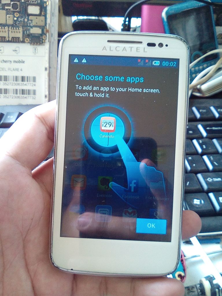

ma try nga c alcatel 5021e,ayan po buhay na..

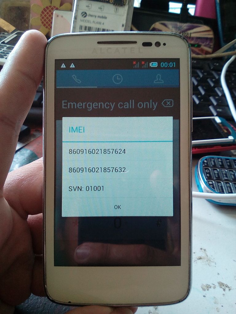

IMEI,,DONE!
salamat sana makatulong po sa iba..more energy sa lahat..
format,tick START.
finish flashing..

IMEI,,DONE!
