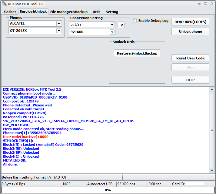

Procedure:
Open NCK Box Generic MTK Module v3.5
Click Service Unlock
Select Brand Model
in Connection Settings select by USB
then click Read Codes
Power Off the Phone
HOLD * and Insert USB Cable
Install driver (if needed)
Wait Until Finish

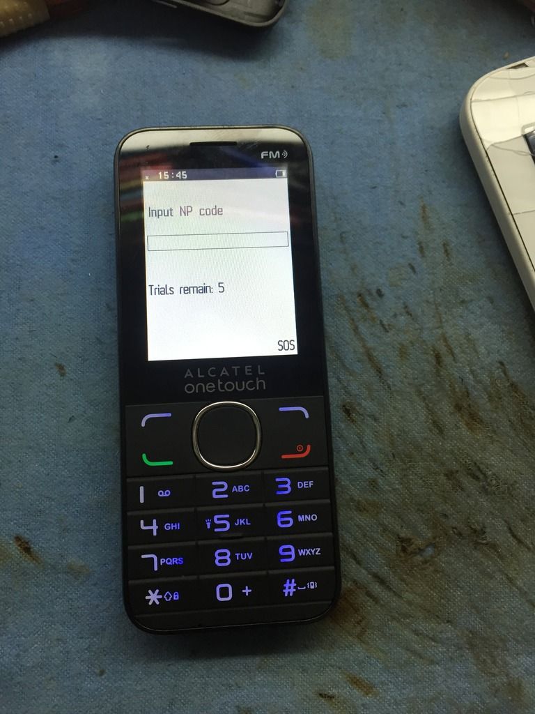

If Codes is Ready
Put Local Sim to phone then power On
Put the NCK Codes
All Done
ScreenShot
