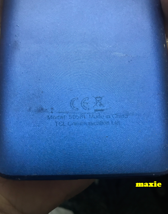

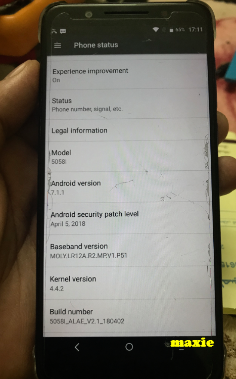

Unit: ALCATEL
Model: OT-5058I

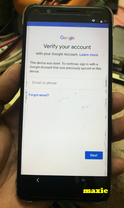

Problem: FRP or google account

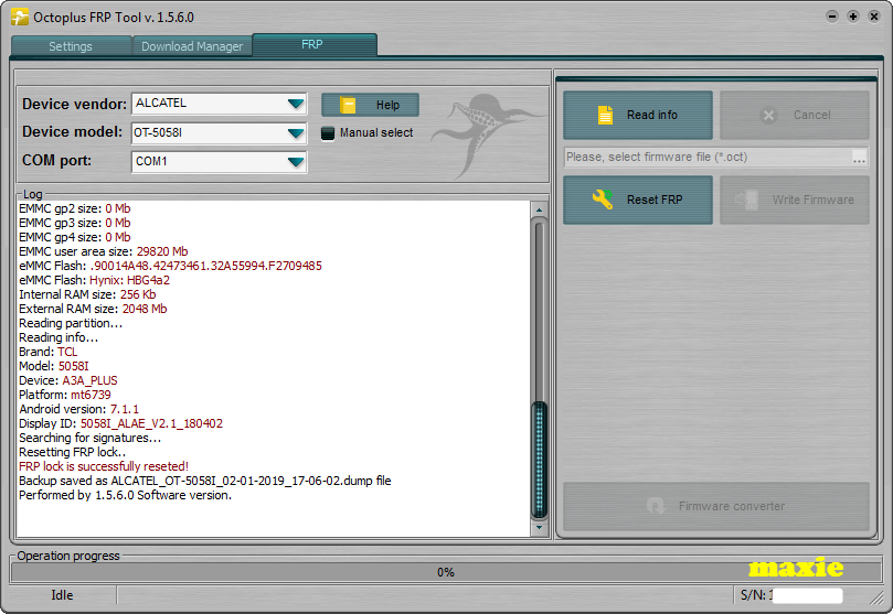

Solution: unlock via octoplus frp tool
Procedure:
  1. Octoplus box must be activated
  2. Open software
  3. Select unit
  4. Select model
  5. Power off phone
  6. Click Reset FRP
  7. Insert Cable into phone
  8. Wait Until process to be Finish
  9. Done

Before
Logs
Code:
Platform: ALCATEL
Selected model: OT-5058I
Please, power phone OFF and connect USB cable.
Searching for a phone. Please wait...
Found phone on COM44
Detecting Chip Version...
HW Chip: MT6739: 0699.0000
HW Version: 8A00.CA00.0000.0000
Connecting...
Brom Version: FF
BootLoader Version: 02
Searching Download Agent...
Selected DA: MTK_AllInOne_DA_v3.3001.2017/12/18.17:41_393798, n.0
Sending Download Agent...
DA sent successfully
Initializing DA...
Synchronizing with DA...
Mobile Status: SYNC
Mobile Status: preloader
Initializing Memory Flash..
Initialization successfully completed
Sending loaders...
Mobile Status: SYNC
Reading Flash Info...
EMMC rpmb size: 4 Mb
EMMC boot1 size: 4 Mb
EMMC boot2 size: 4 Mb
EMMC gp1 size: 0 Mb
EMMC gp2 size: 0 Mb
EMMC gp3 size: 0 Mb
EMMC gp4 size: 0 Mb
EMMC user area size: 29820 Mb
eMMC Flash: .90014A48.42473461.32A55994.F2709485
eMMC Flash: Hynix: HBG4a2
Internal RAM size: 256 Kb
External RAM size: 2048 Mb
Reading partition...
Reading info...
Brand: TCL
Model: 5058I
Device: A3A_PLUS
Platform: mt6739
Android version: 7.1.1
Display ID: 5058I_ALAE_V2.1_180402
Searching for signatures...
Resetting FRP lock..
FRP lock is successfully reseted!
Backup saved as ALCATEL_OT-5058I_02-01-2019_17-06-02.dump file
Performed by 1.5.6.0 Software version.

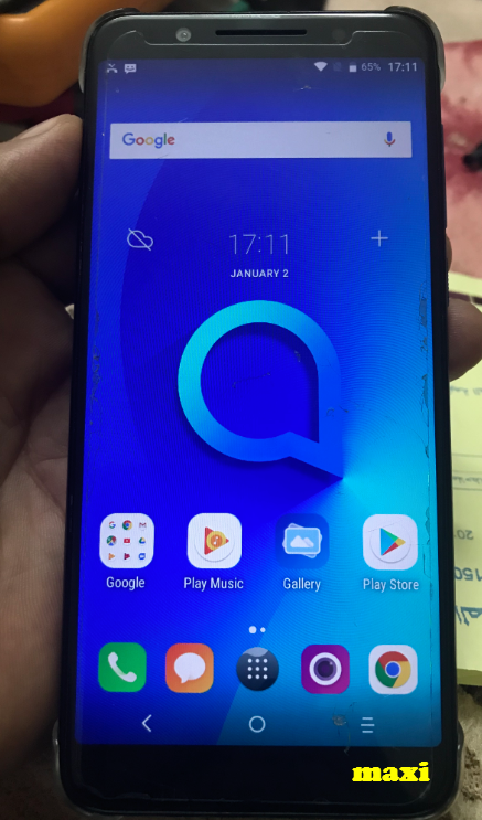

After :
