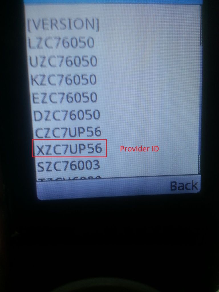

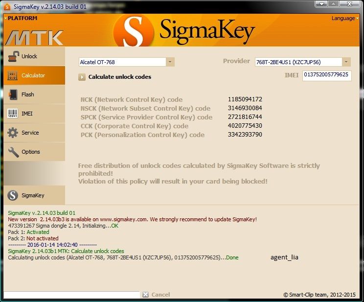

Gadget Used:
Sigma Box
Requrements:
Phone IMEI No.
Phone PID
Usually nasa sticker sa likod nakasulat ang PID at Imei.
This time IMEI lang nakita ko
Kaya kailangan natin buhayin ang unit i dial ito *#837# hanapin ang *XZ
kapag nakuha na iopen ang Sigma Software.
open ang MTK Tab>Calculator fill the Imei and Pid hit calculate
Lagyan ng unaccepted SimCard ang Phone and you will be asked to enter Code
enter NCK Code or SPCK Code calculated by SigmaBox.
and you are Done.
