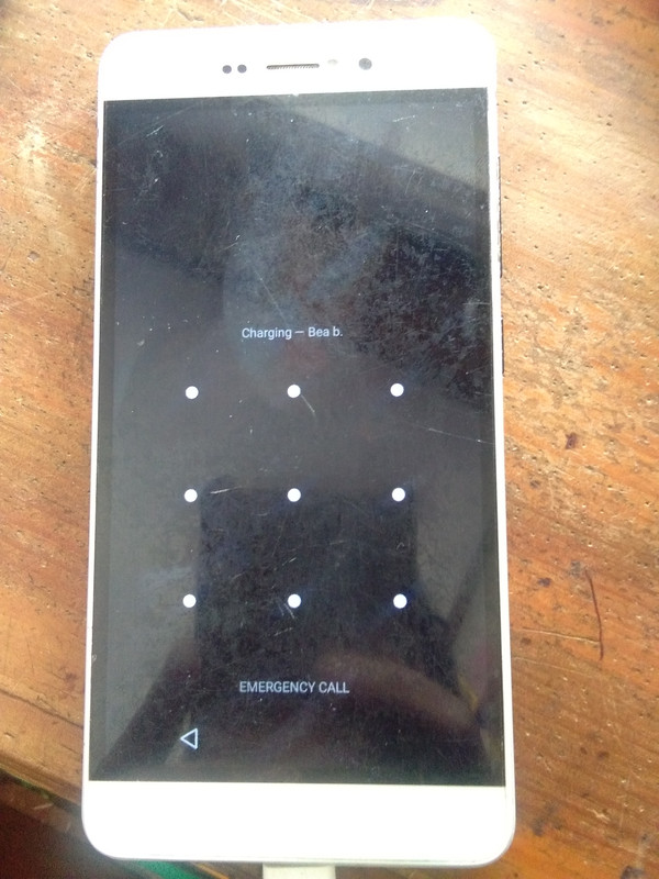

ASK SP528 4G Pattern at frp Done kay NCK Crack

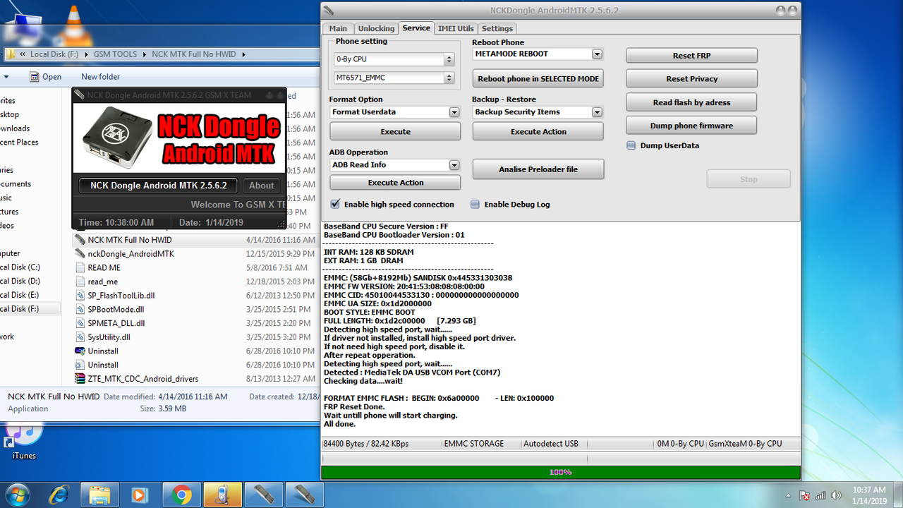

Procedure::D:D:D:D
Open NCK CRACK
Service
Format Userdata
Execute
Saksak ang usb salpak battery :D:D:DDone
:Para sa FRP
Click Reset FRP

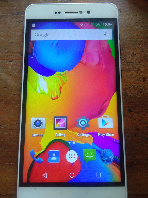

boss keep posting po pinalaki ko lang yung picture di kc makita
