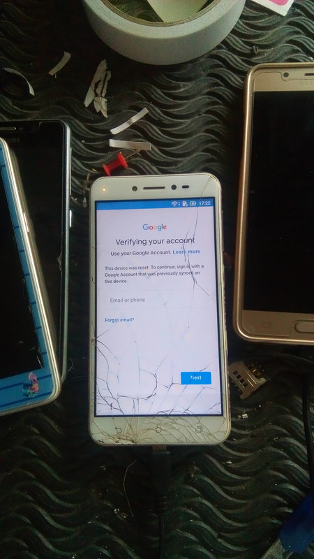

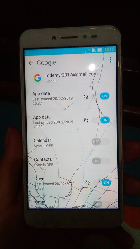

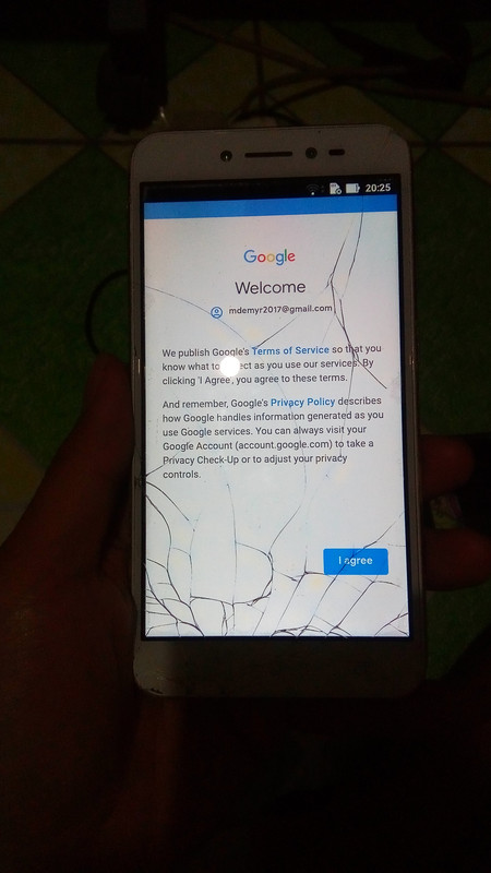

nakalimutan ang google account
download muna yung dalawang apk file at ilagay sa memory card​
apk​

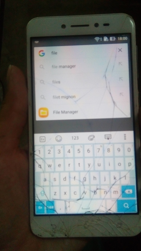

type file manager and open it

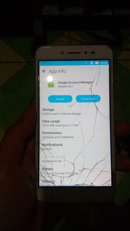

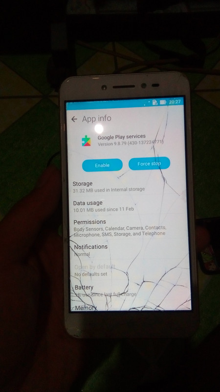

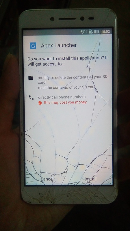

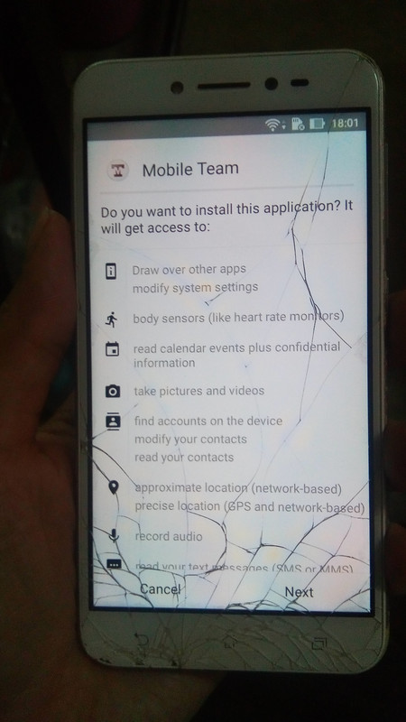

install first "Mobile Team Frp Patch" and "com.anddoes.launcher-3.1.0-3101-minAPI15" after installed the launcher, open it

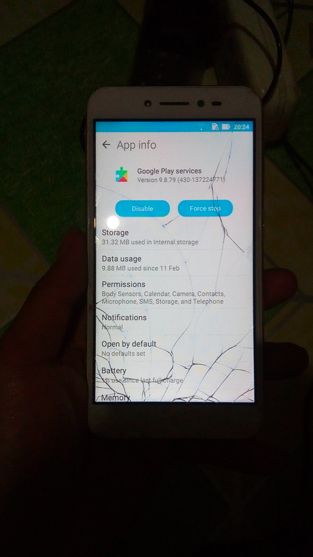

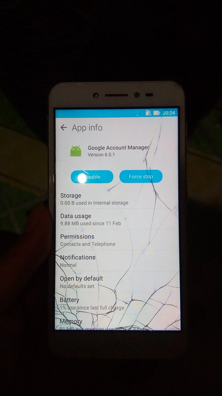

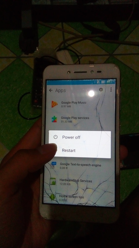

go to settings, apps, show system settings, disabled "google account manager" and "google play service"

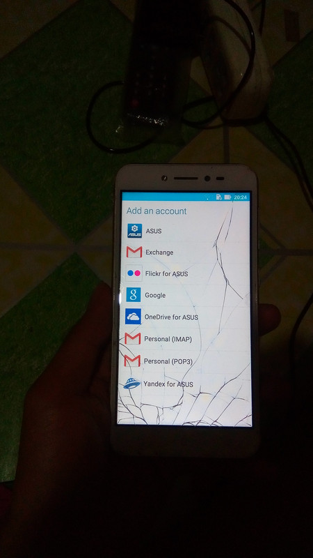

go back to settings, account, add account, google
enable "google account manager" ang "google play service"
restart the phone and un installed "Mobile Team Frp Patch"
