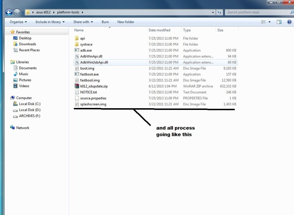

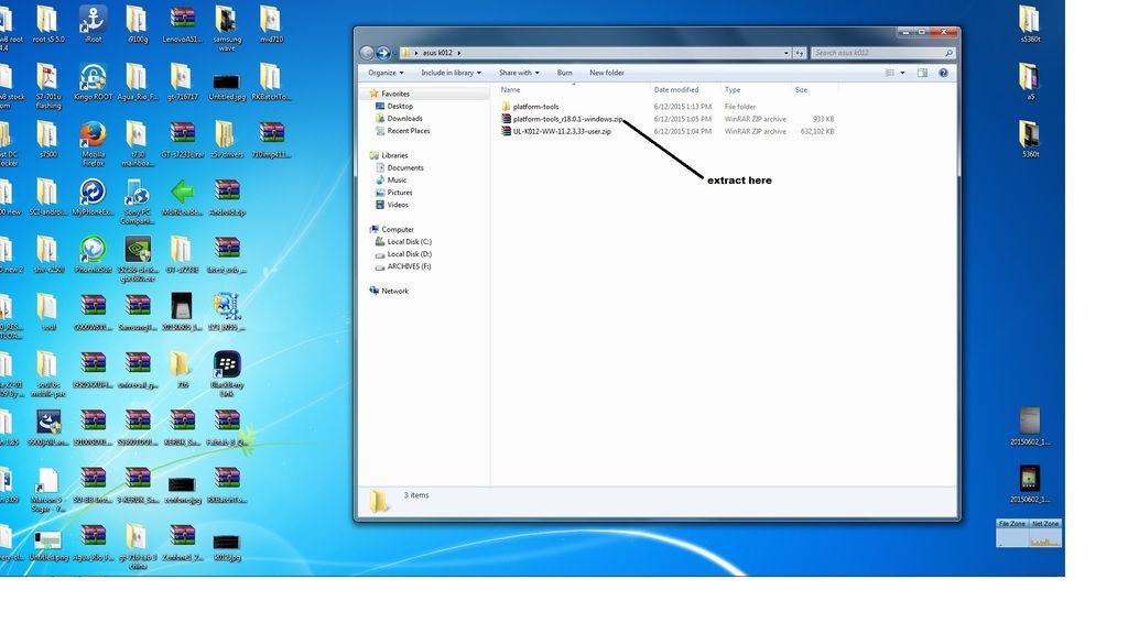

1. idownload ang firmware at tools at pagsamahin sa iisang folder parang ganito
<textarea style="width: 500px;" readonly="readonly" class="ncode_imageresizer_warning" id="ncode_imageresizer_warning_1">Click here to view the original image of 879x494px.</textarea>
AT EXTRACT ANG TOOLS sa parehong folder..

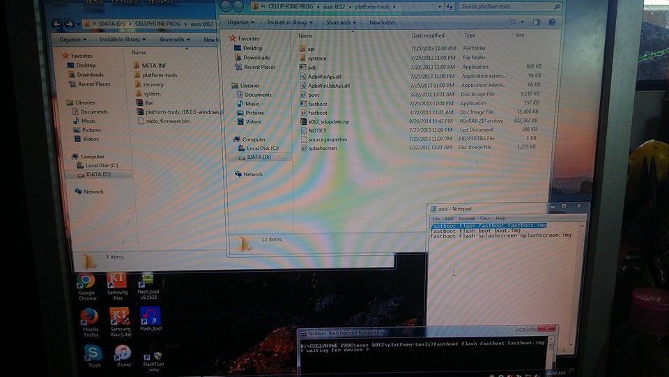

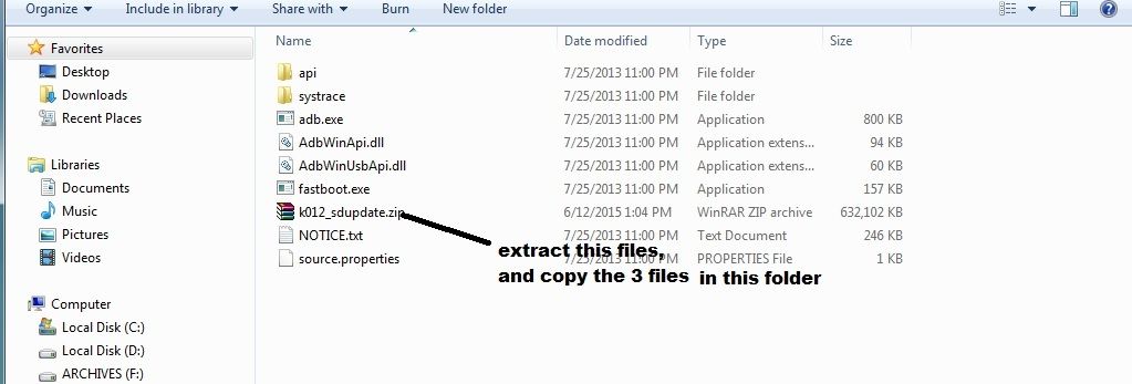

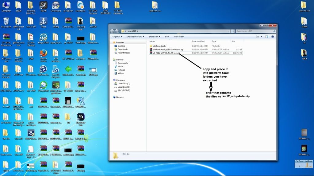

2.i copy ang FIRMWARE at ipaste sa PLATFORM-TOOLS na folder na naextract natin
<textarea style="width: 500px;" readonly="readonly" class="ncode_imageresizer_warning" id="ncode_imageresizer_warning_2">Click here to view the original image of 879x494px.</textarea>

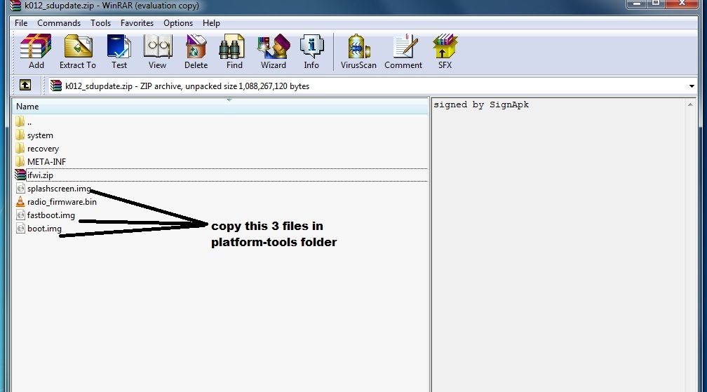

3.irename ang FIRMWARE na kinopya natin, gawin nating k012_sdupdate.zip..at pagkatapos irename,buksan ang files at extract natin yung tatlong files sa kaparehong folder
<textarea style="width: 500px;" readonly="readonly" class="ncode_imageresizer_warning" id="ncode_imageresizer_warning_3">Click here to view the original image of 879x298px.</textarea>
4.eto po oh

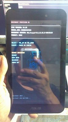

6.connect the tablet sa computer in fastboot mode, by pressing volume up at power.. ganito po

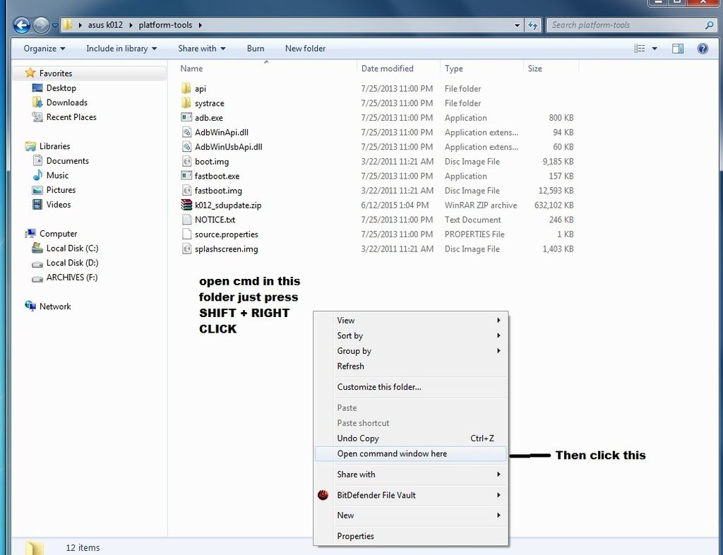

7.sa PLATFORM-TOOLS na folder pindutin po natin ang " SHIFT at RIGHT CLICK at open natin yung cmd ganito po..
<textarea style="width: 500px;" readonly="readonly" class="ncode_imageresizer_warning" id="ncode_imageresizer_warning_7">Click here to view the original image of 879x675px.</textarea>

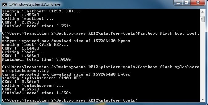

8.paglabas ng cmd itype po natin ang fastboot flash fastboot fastboot.img hintayin mtapos sunod ay fastboot flash boot boot.img at ang huli ay fastboot flash splashscreen splashscreen.img ganito po ang kalalabasan

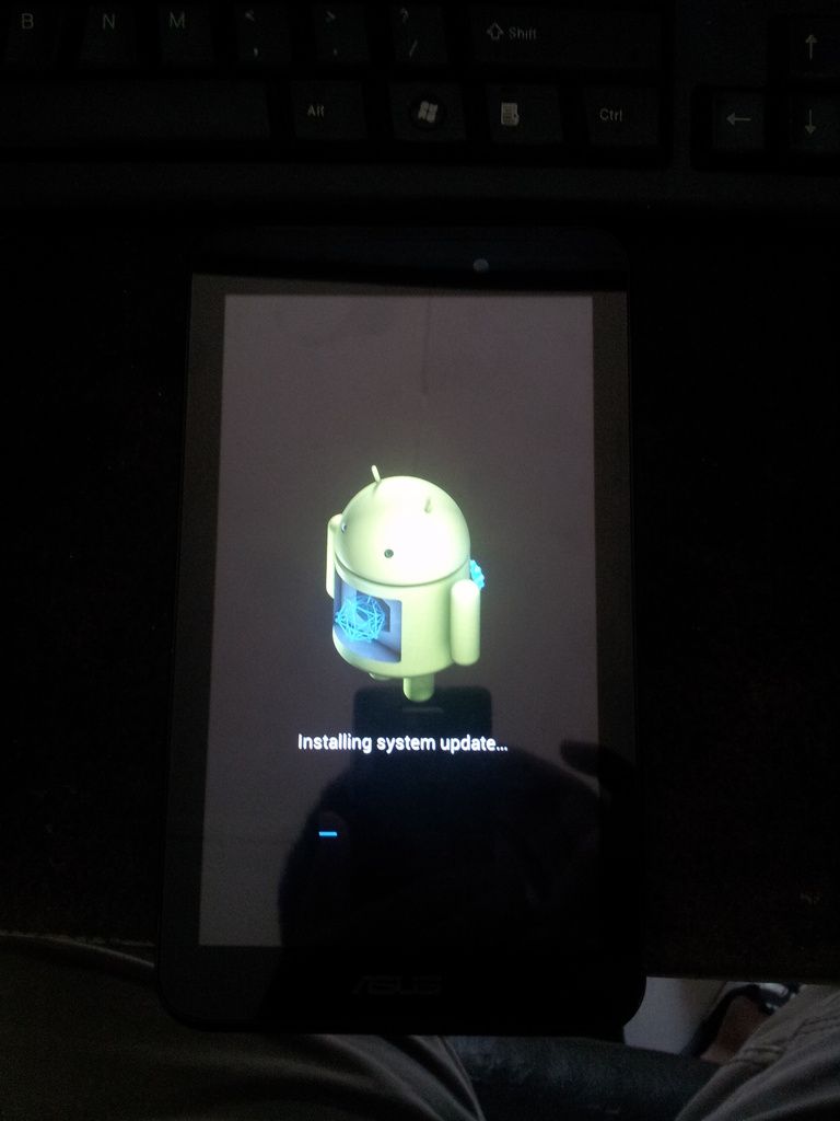

9.pumunta sa PLATFORM-TOOLS na folders at kopyahin ang " k012_sdupdate " at ilagay sa memory card,,note sa labas lang po,.tapos isalpak sa tablet ang memory card at pindutin ang VOLUME UP at POWER wag bibitawan hanggang hindi lumilitaw to
<textarea style="width: 500px;" readonly="readonly" class="ncode_imageresizer_warning" id="ncode_imageresizer_warning_9">Click here to view the original image of 768x1024px.</textarea>

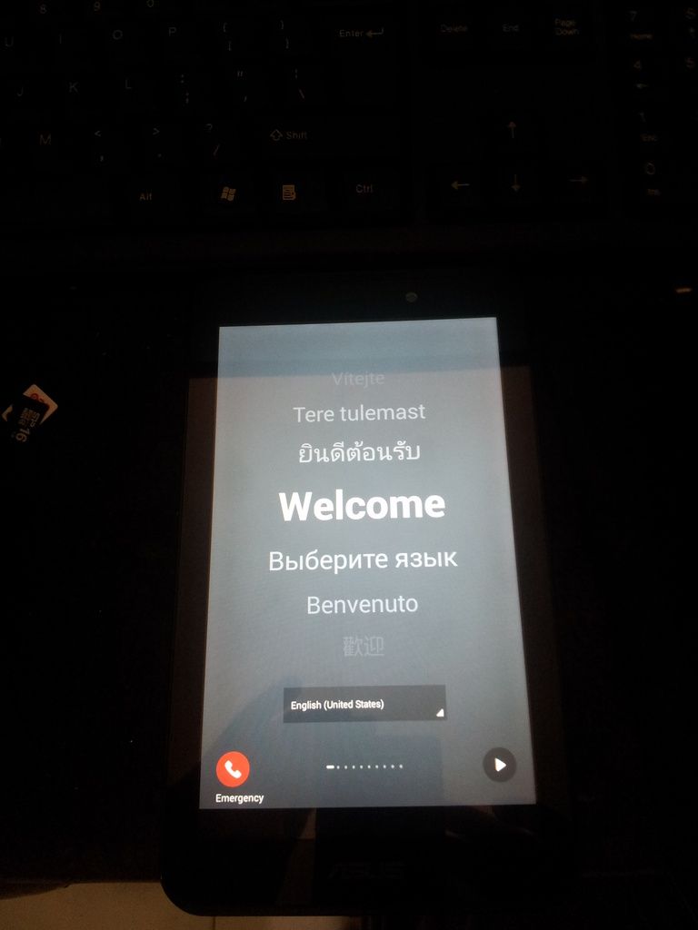

hintayin lang magreboot medyo matagal.. and done
<textarea style="width: 500px;" readonly="readonly" class="ncode_imageresizer_warning" id="ncode_imageresizer_warning_10">Click here to view the original image of 768x1024px.</textarea>
