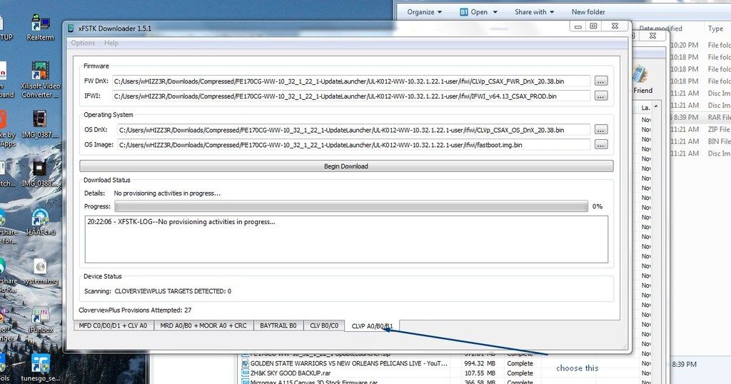

run xfstk downloader

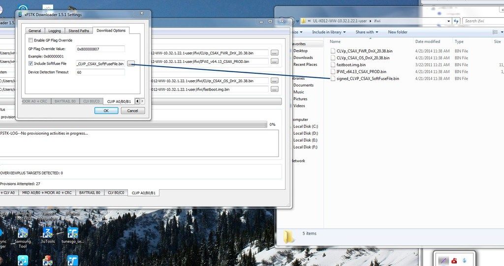

select option>modify setting>download option>check include softfuse file

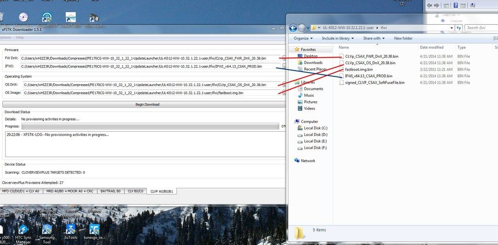

enter yng apat na file nsa pix

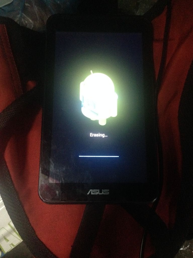

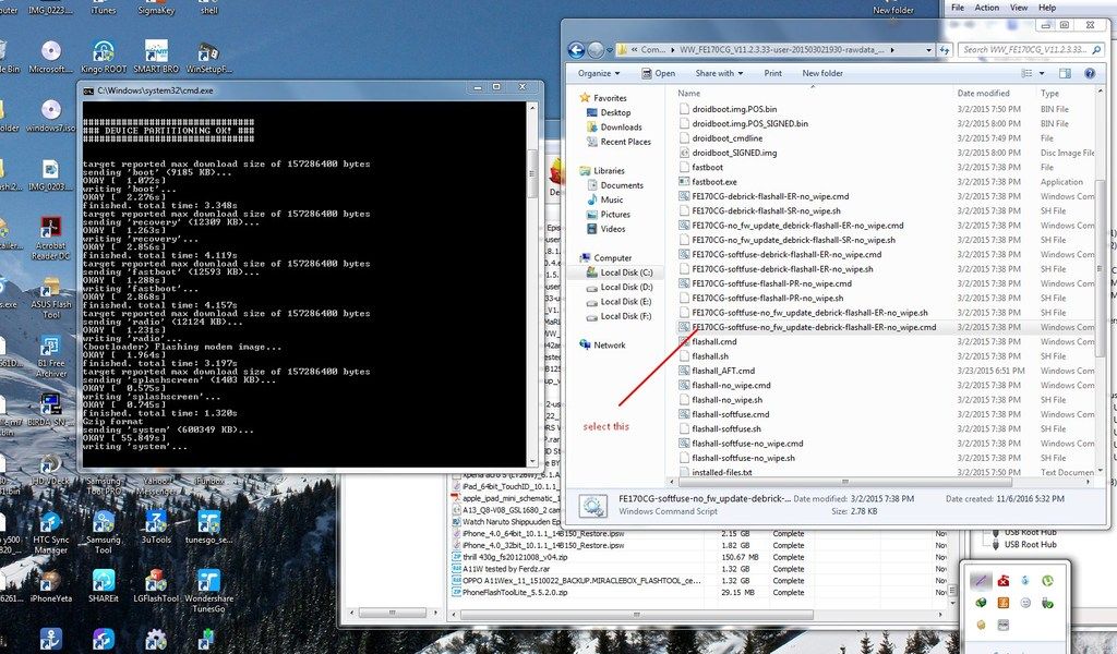

next extract firmware tapos run FE170CG-softfuse-no_fw_update-debrick-flashall-ER-no_wipe.cmd
wait matapos

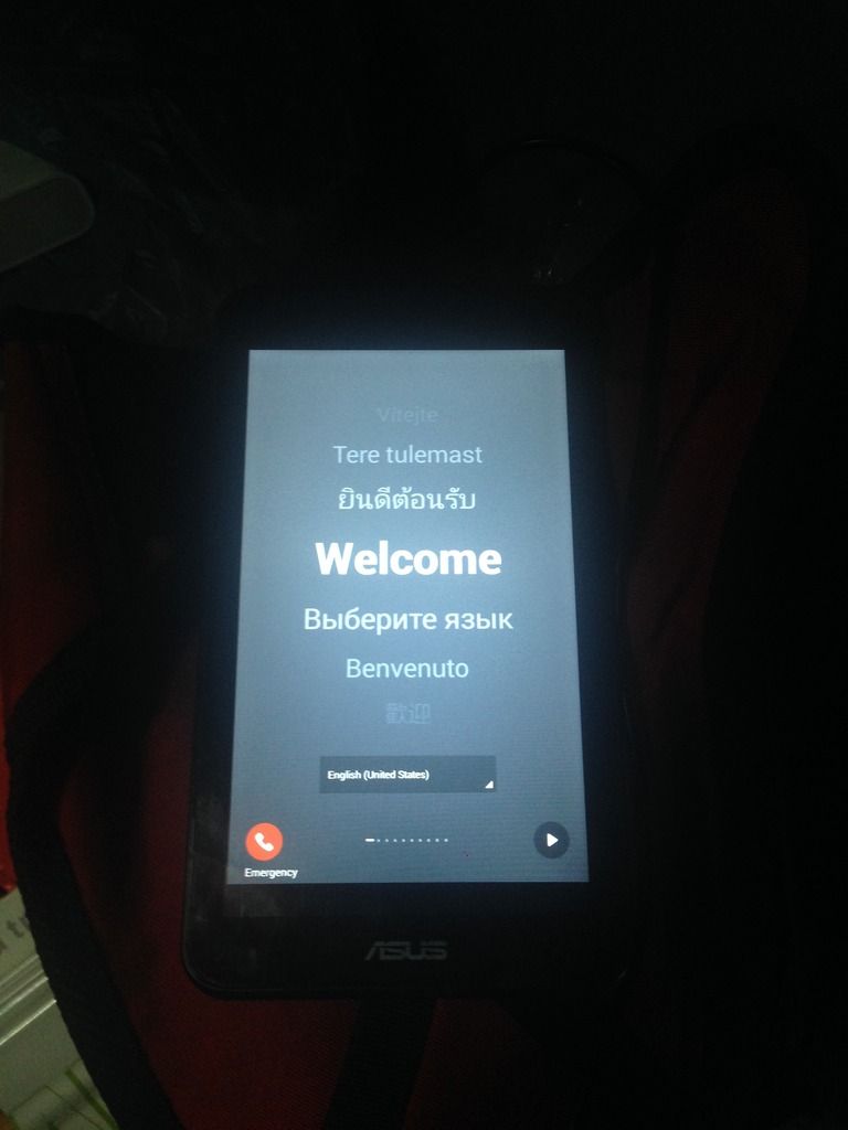

finish product
wait matapos
finish product
