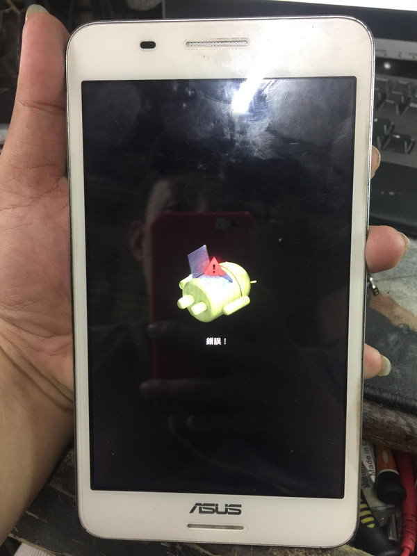

Asus Fonetab 7 (K01Q) Hang Logo
Nadali po ang Unit via Hard reset.

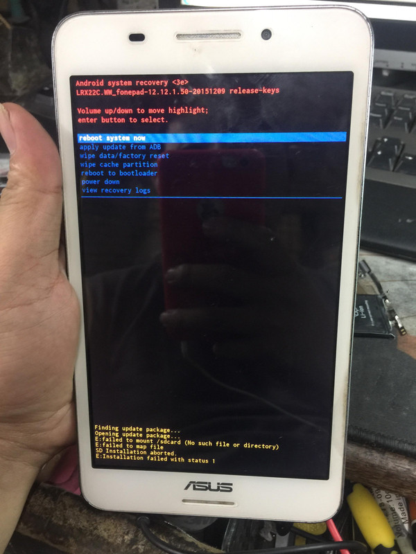

First Recovery po muna using vol up + power button lalabas po ito:

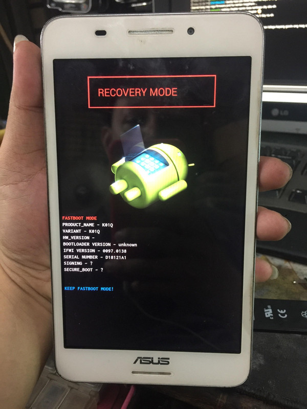

Then Select po natin RECOVERY using vol key for selecting power button for ok...
after ma select yan na po lalabas :
Now Press All button (volup,voldown,&power button) at the same time 4X...

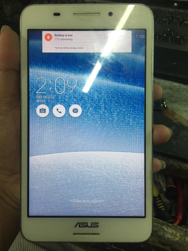

Select wipe data factory reset then ok hintayin lang po magrestart mga 2-5 mins bago mag open...
finish na for REFERENCE lang po...salamat
