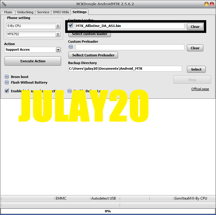

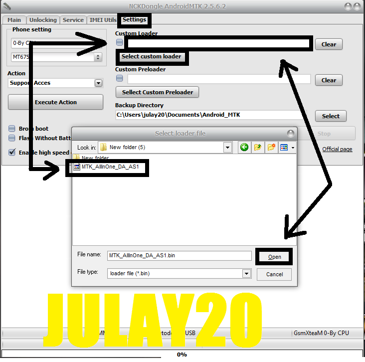

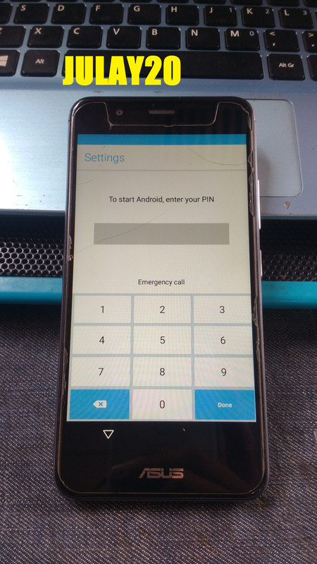

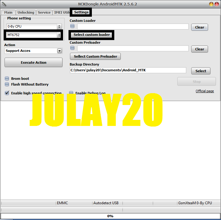

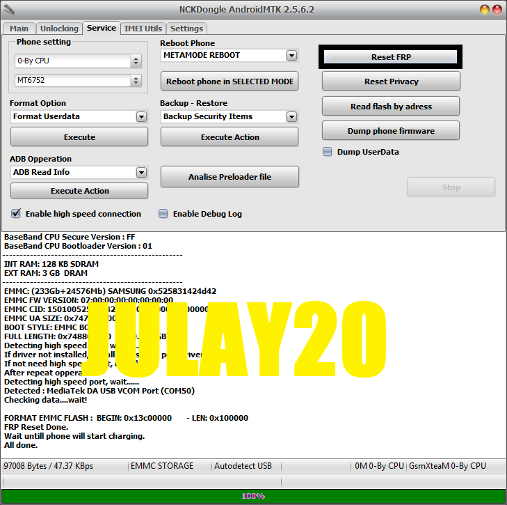

ASUS X008D PASSWORD AND FRP DONE SA NCK CRACK
post ko lang mga boss ayaw sa cm2 e kaya hanap ako paraan pano ma tangal ito ohh
DOWNLOAD MONA ITO: FILE HARE!

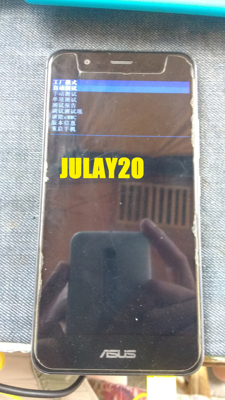

dahil ayaw ma tangal sa cm2 ginawa ko hard rest ko gamit voll down and power button lalabas to piliin mo yung clear emmc
sondan mo lang ito ohh nasa ss alam mo na gagawin mo :D
salamat sa oreg uploader ng file my pass po yan tatsulok mo lang :D

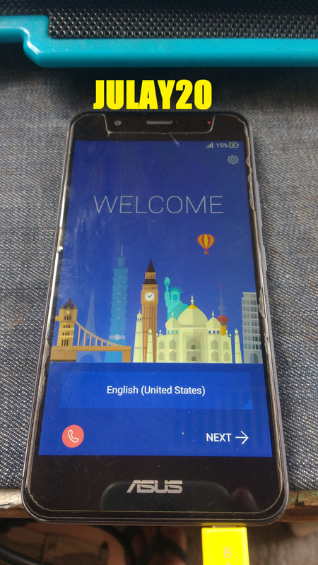

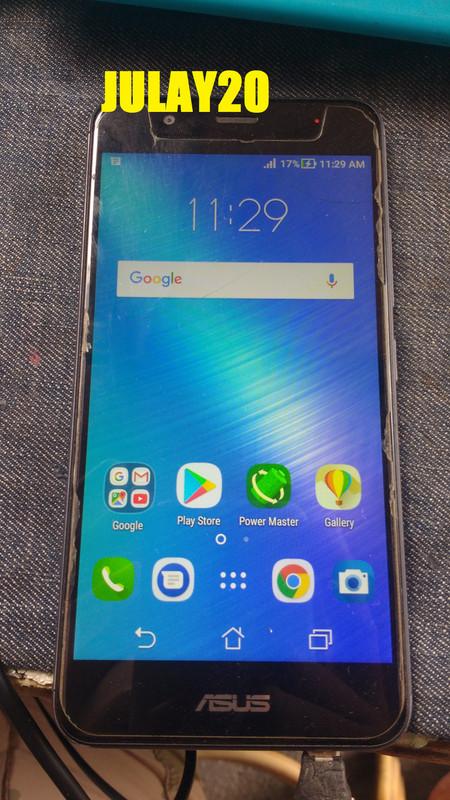

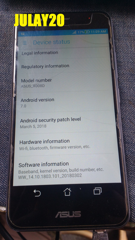

unit: asus x008d
problem: frp
action taken: format reset frp via nck crack
status: working successfuly done
