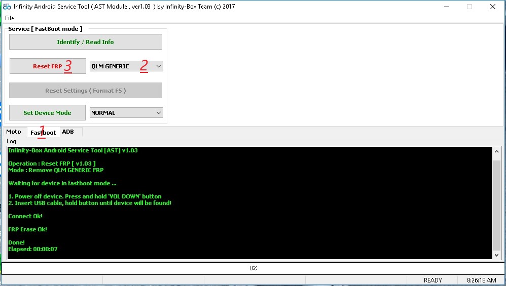

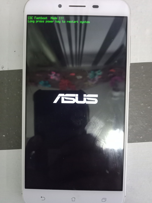

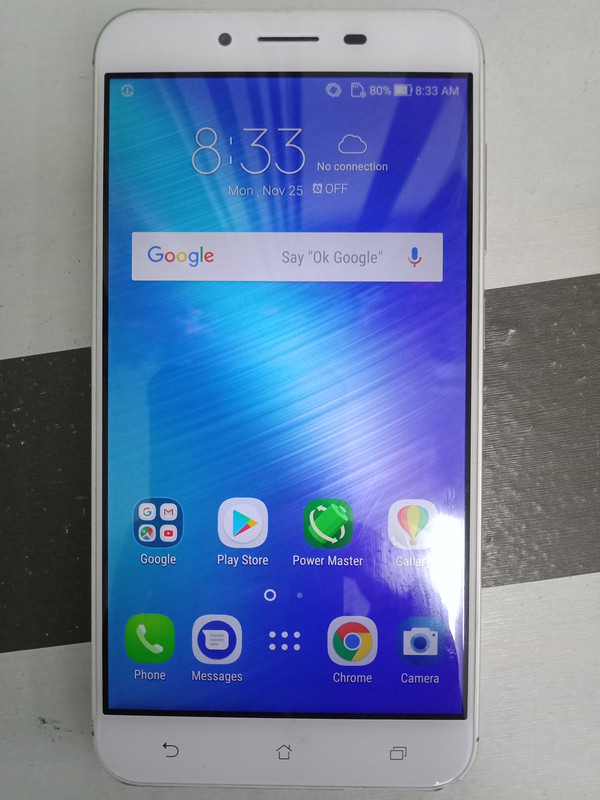

andreivi Registered Joined Jul 30, 2014 Messages 1,986 Reaction score 271 Points 381 Location Sison, Pangasinan/ Rosario, La Union Nov 25, 2019 #1 share lang mga boss for reference Asus Zenfone 3 Max (X00DDA) FRP done sa CM2 AST turn off phone Press Vol Up + Power to put phone in Fastboot mode open CM2AST click on fastboot tab select type QLM Generic click reset antayin matapos done
