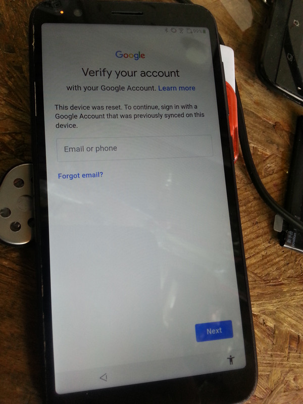

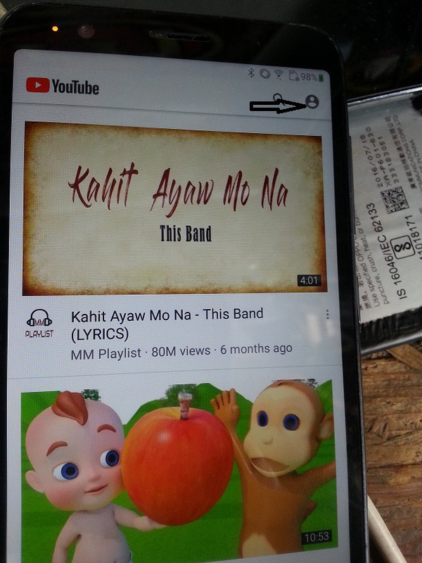

nais ko lang po ulit ibahagi Frp bypass po ng Asus X00RD
1. connect po muna s wifi tpos next next lng at ito po may google account

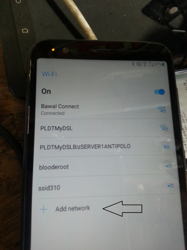

2. blik s wifi settings tap add network.
3. type po ang youtube.com then tap & hold po tpos tap youtube

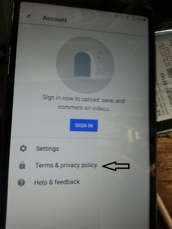

kgya po ng nsa picture
4. tpos po nyan sundan lng ang nsa picture hanggang mkrating s google.com

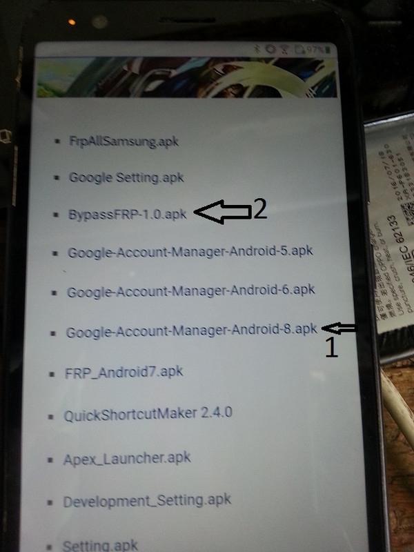

5. type nyo po s url frpfile.com/bypass at idownload at install itong 2
unahing idownload at install ang google account manager bago ang bypass frp

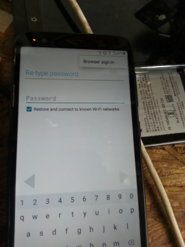

6. pagka-install ng bypass frp iopen po click ung 3 dots s tass tpos browser sign in
then log in n po ang account nyo. then restart po

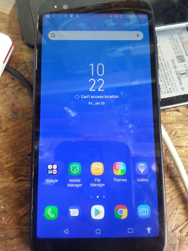

7.e2 n po done...
