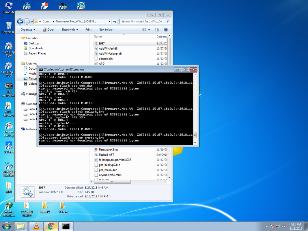

stuck xa s Fastboot
khit ireboot xa ganyan p din kya try ko iflash hanap ako kay
google ng firmware pero 2 pla ung asus X00RD n unit
ZA550KL at ZA551KL d ko n mkita kung anong version nya
khit s recovery ndi lumlbas kya sinubukan kong iflash ung ZA551KL via fastboot
success s flashing pero ndead ung unit pero detected p rin nmn xa computer

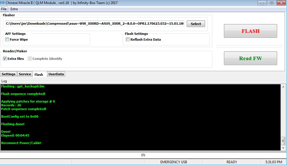

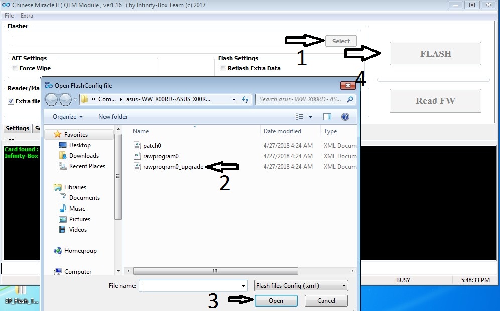

tpos sinubukas ko iflash s CM2 QLM
e2 po ung nsa pics ung procedure
extract muna ung ndownload n firmware

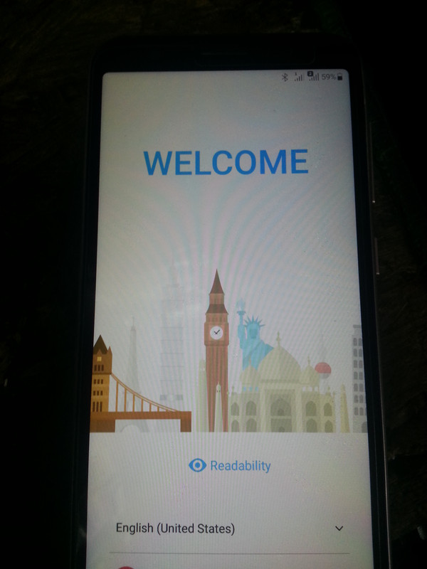

e2 po tpos n ung flashing success nmn
ok n po pero may FRP p

stuck xa s Fastboot
