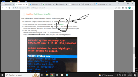

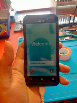

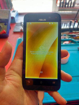

1. DOWNLOAD NYO MUNA FIRMWARE: https://flash-er.com/asus-x014d-zenfone-go-firmware/ NASA PICTURE KUNG SAN NYO MAKITA ANG FIRMWARE
2. LAGAY NYO SA MEMORY CARD. YUNG NA DOWLOAD NYONG FIRMWARE

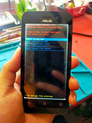

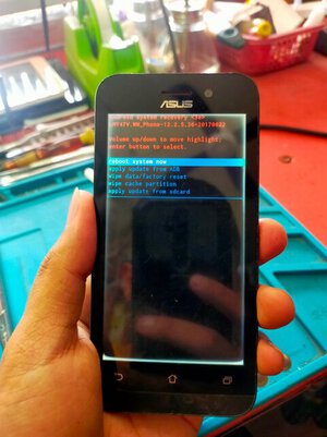

3. POWER OFF UNIT. PRESS VOLUME DOWN AND POWER BUTTON. WIPE DATA/FACTORY RESET NYO MUNA

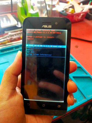

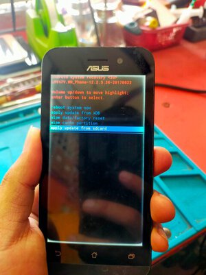

4 .APPLY UPDATE FROM SD CARD PRESS POWER BUTTON TO SELECT. AND SELECT NYO YUNG FIRMWARE NA DINOWNLOAD NYO

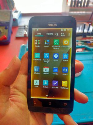

5. WAIT NYO MATAPOS . THEN REBOOT SYSTEM NOW. . DONE !!
