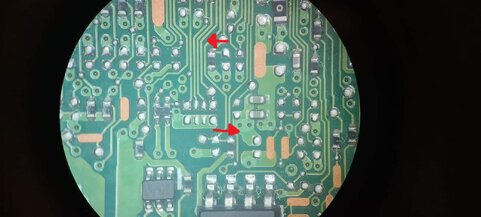

Problem found.
Dramrst# missing due to defective on board ram..

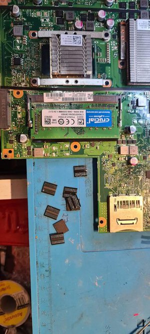

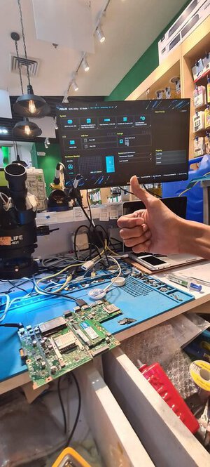

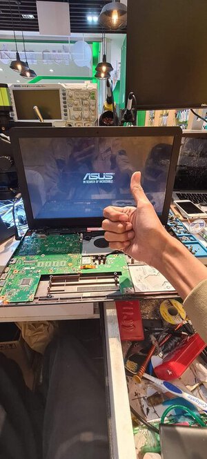

As there is no available ram chips to do a direct replacement i just removed the onboard ram chips and re configure the ram configurarion straps to allow the system to boot with only the extra ram slot papulated..
