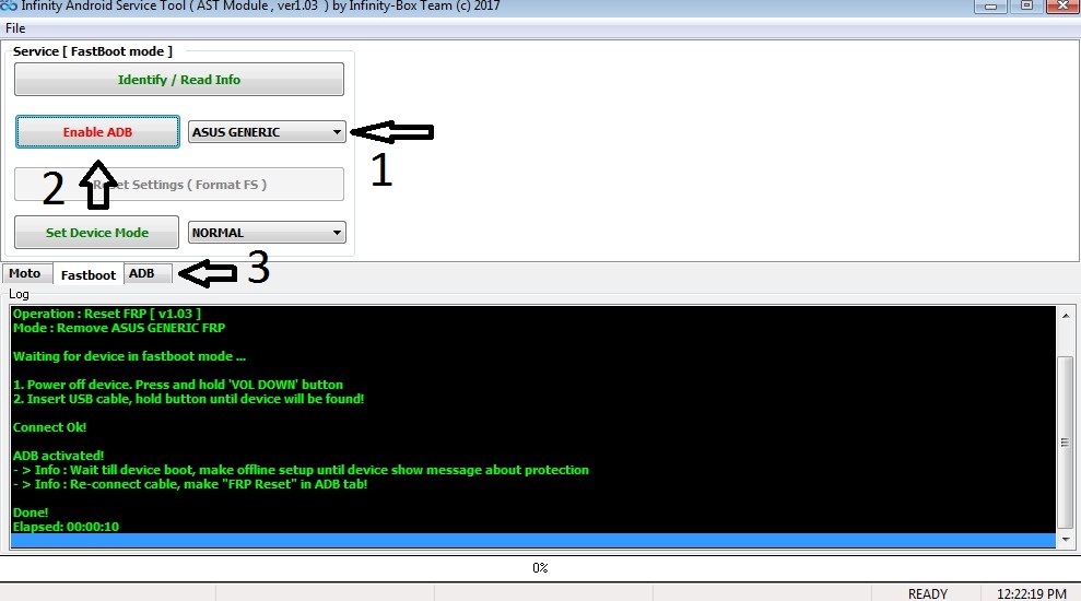

share ko lang po Asus hang logo po bigla n lang daw

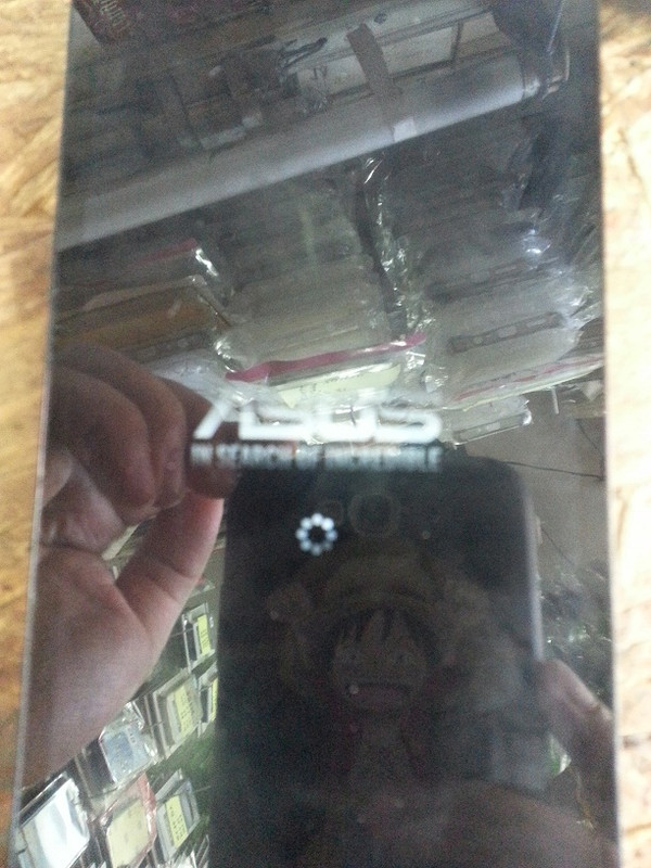

ndali s hard reset pero may FRP done kay CM2
e2 po nung dinla sken

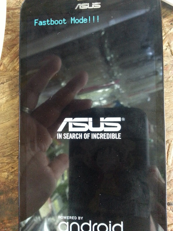

after hard reset ok n pero may frp p kya boot ntin s fasboot
volume up + power

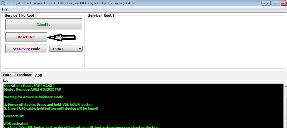

after nyan open CM2 ung AST po at sundan ito
after mkreboot at maopen adb e2 nmn

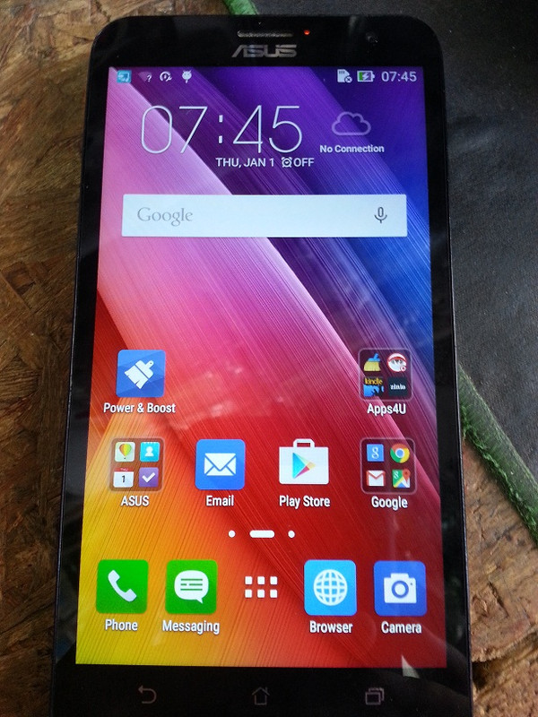

after nyan e2 po done n
