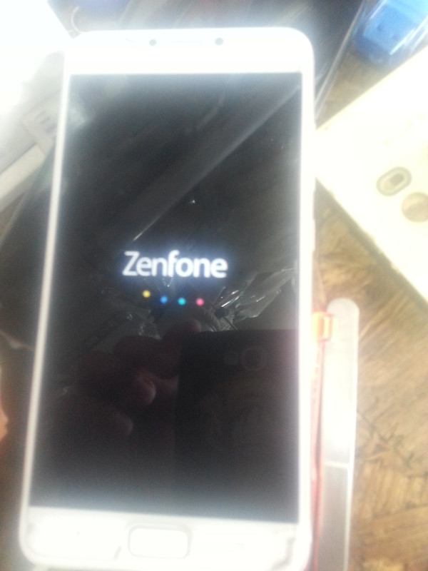

share ko lang po Asus X00id hang logo tpos may frp
ngupdate daw po si tumer tpos tumigil kya aun tulala
search ko d2 s at e2 po nkita ko slamat po s thread n 2
tested po...jn n din po ung frimware at ung pangbypass ng FRP
http://antgsm.com/showthread.php?t=248220&highlight=x00id
e2 po nung hang p

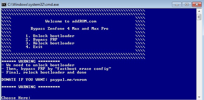

flash lang gmit ung ndownload n file at run ung flashall_AFT.bat

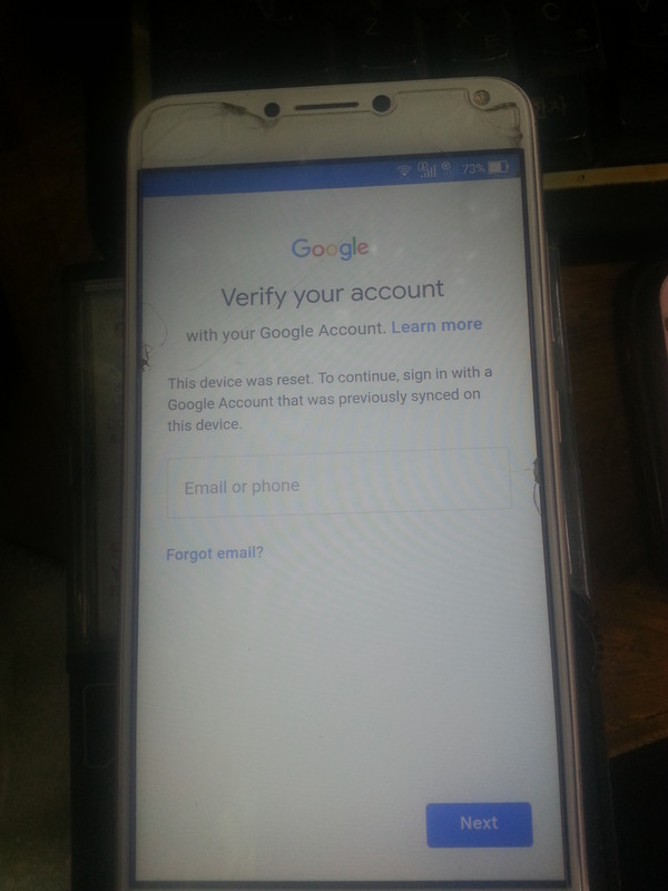

e2 nmn po may frp p after flash
run nmn po ung pang bypass at piliin lng ung 1-2-3-4
bwat execute ng number magrereboot po xa

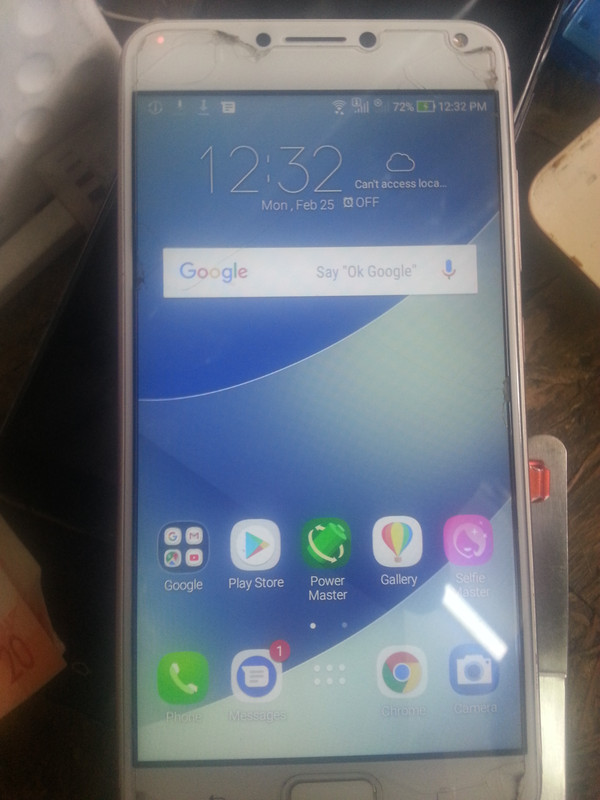

e2 po done na
