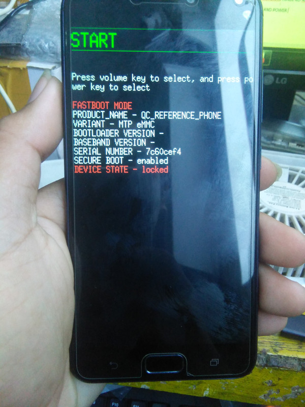

NXT STEP PO AY POWER OFF PHONE
THEN HOLD VOL UP AND POWER DAPT GANITO ANG LUMABAS

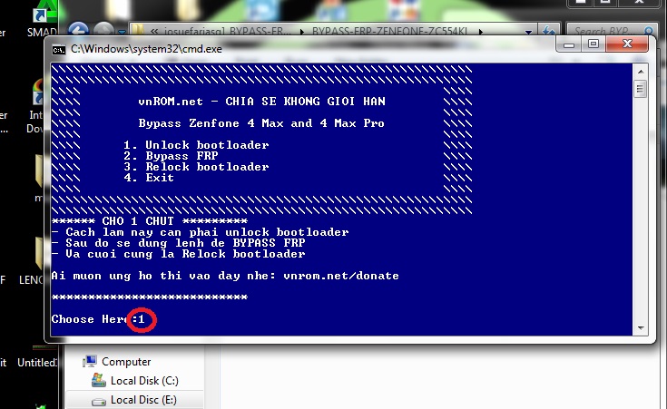

THEN SALPAK USB INSTALL IF NEEDED OPEN TOOL
TYPE 1 AND ENTER AFTER DONE CP WILL REBOOT
TYPE 2 AND ENTER AFTER DONE CP WILL REBOOT
TYPE 3 AND ENTER AFTER DONE CP WILL REBOOT
AND TICK VOL DOWN AND SELECT RWCOVERY

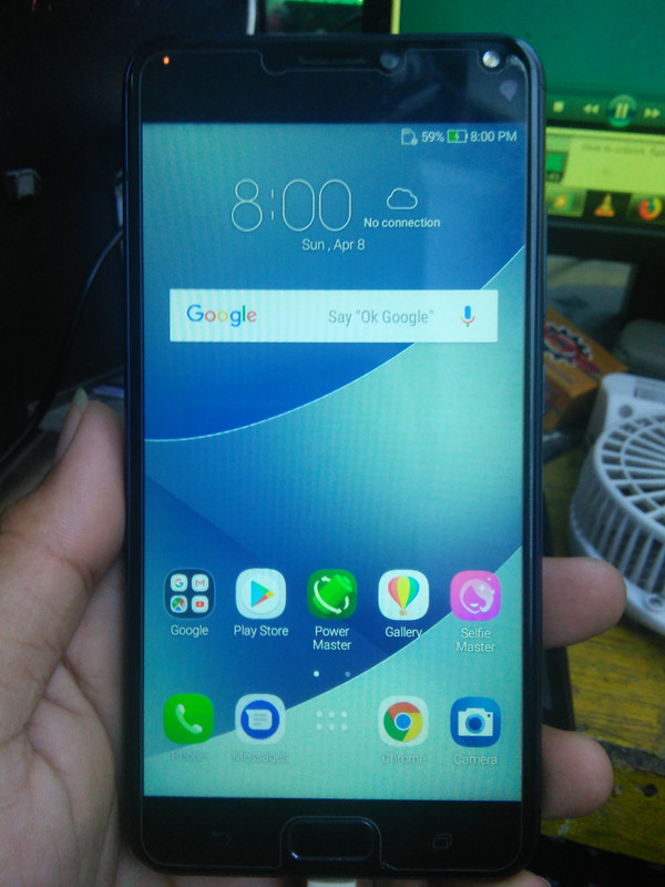

AND WIPE FACTORY DATA AND RESET DONENA LAHAT YAN
DONE
