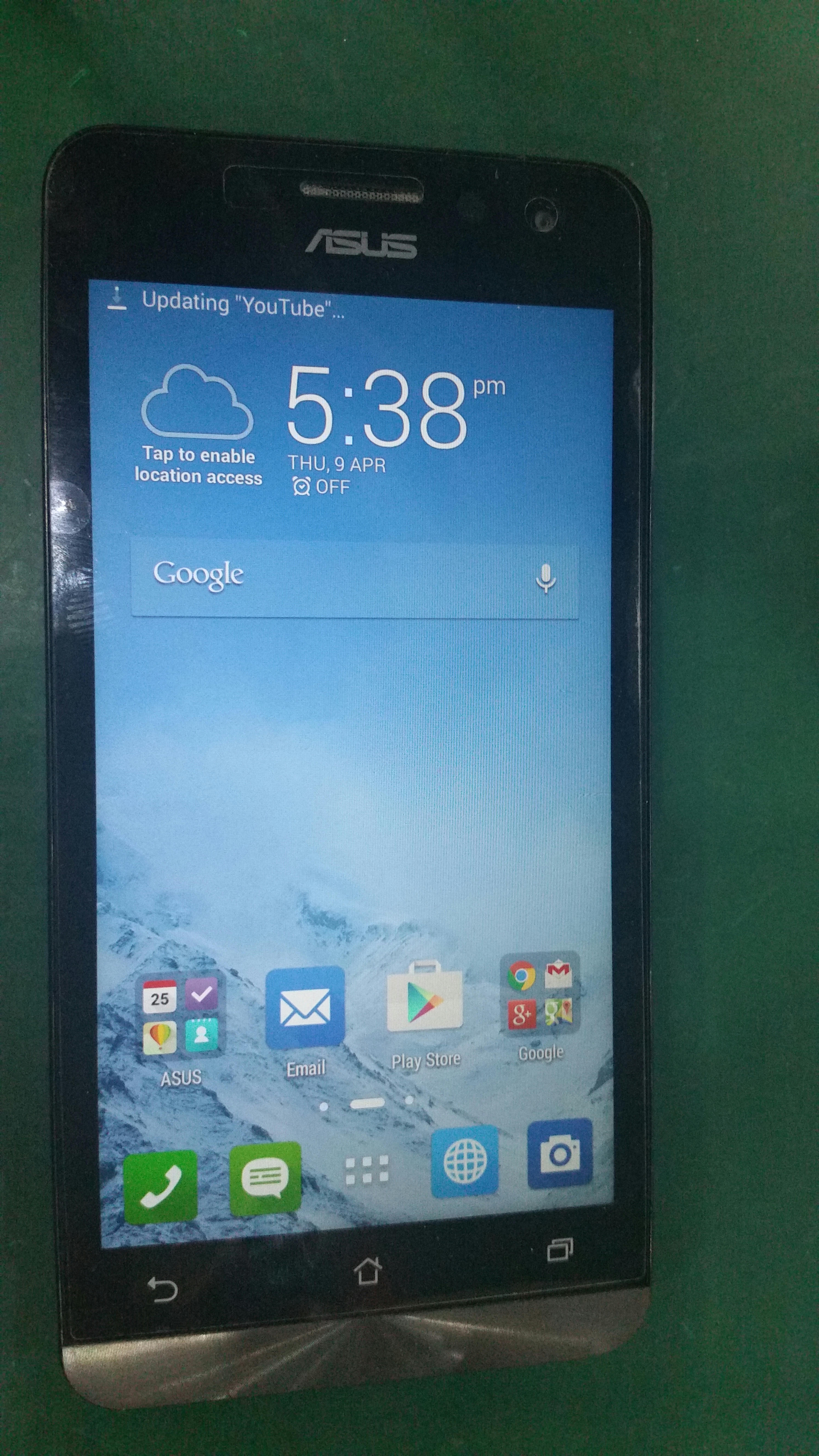

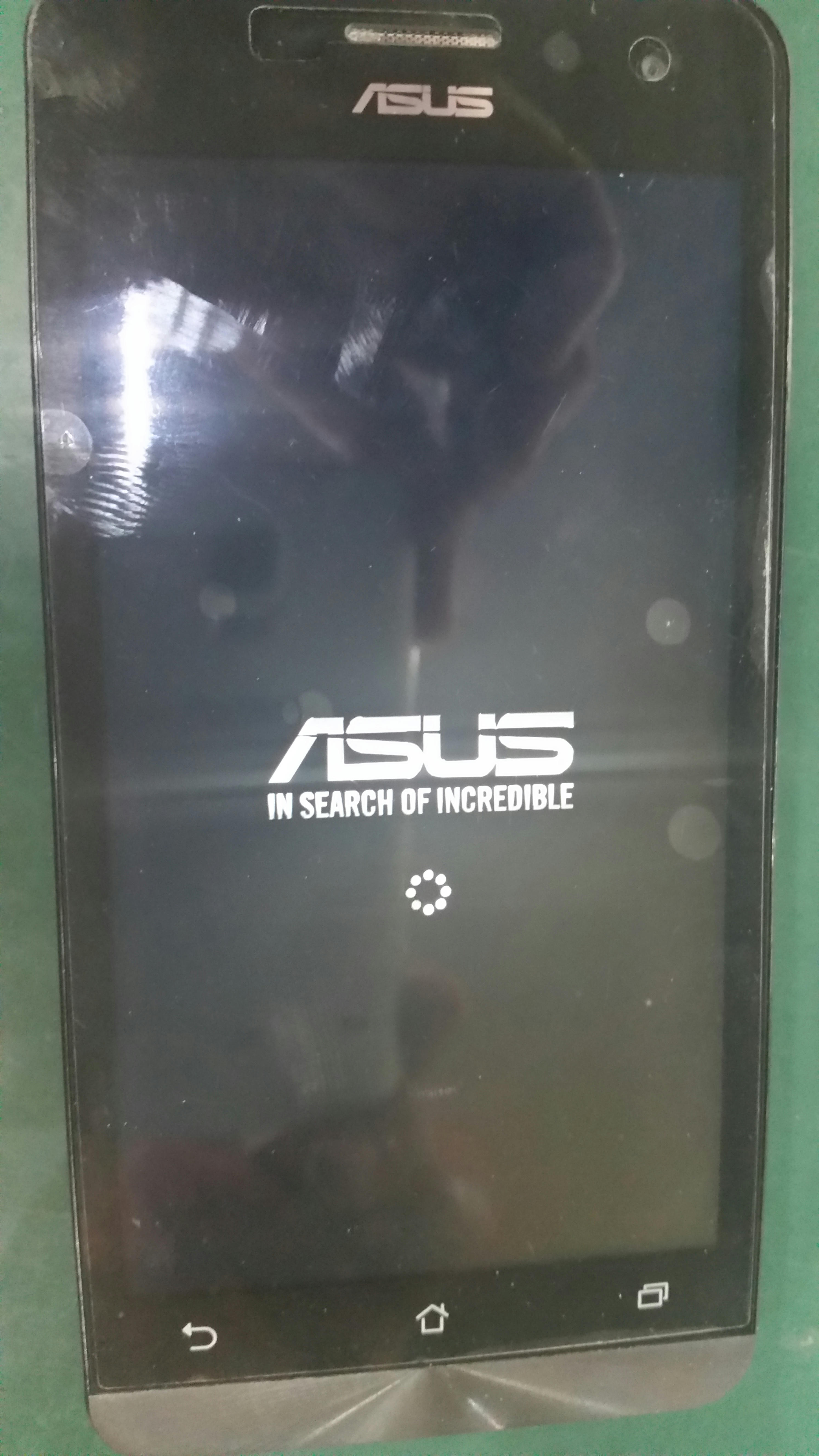

Gud pm mga boss share ko lng ung gawa ko zenfone 5 (t00j_tw )hang s logo...:D:))

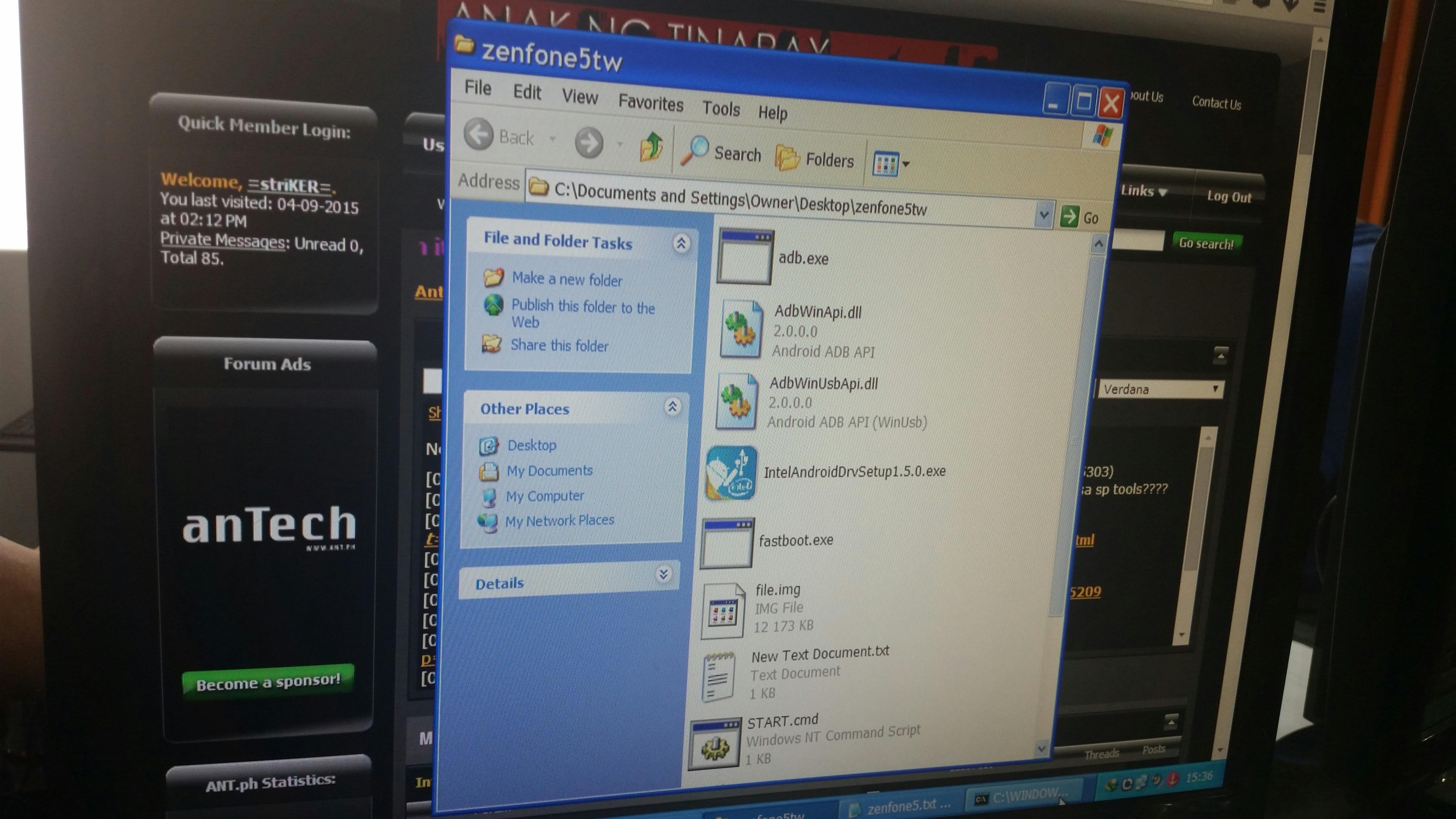

eto po ginamit ko firmware at tools..pinagsama ko n pti file image at ung firmware para ms madali...
http://www.mediafire.com/download/u98asudcizowhof/zenfone5tw.rar

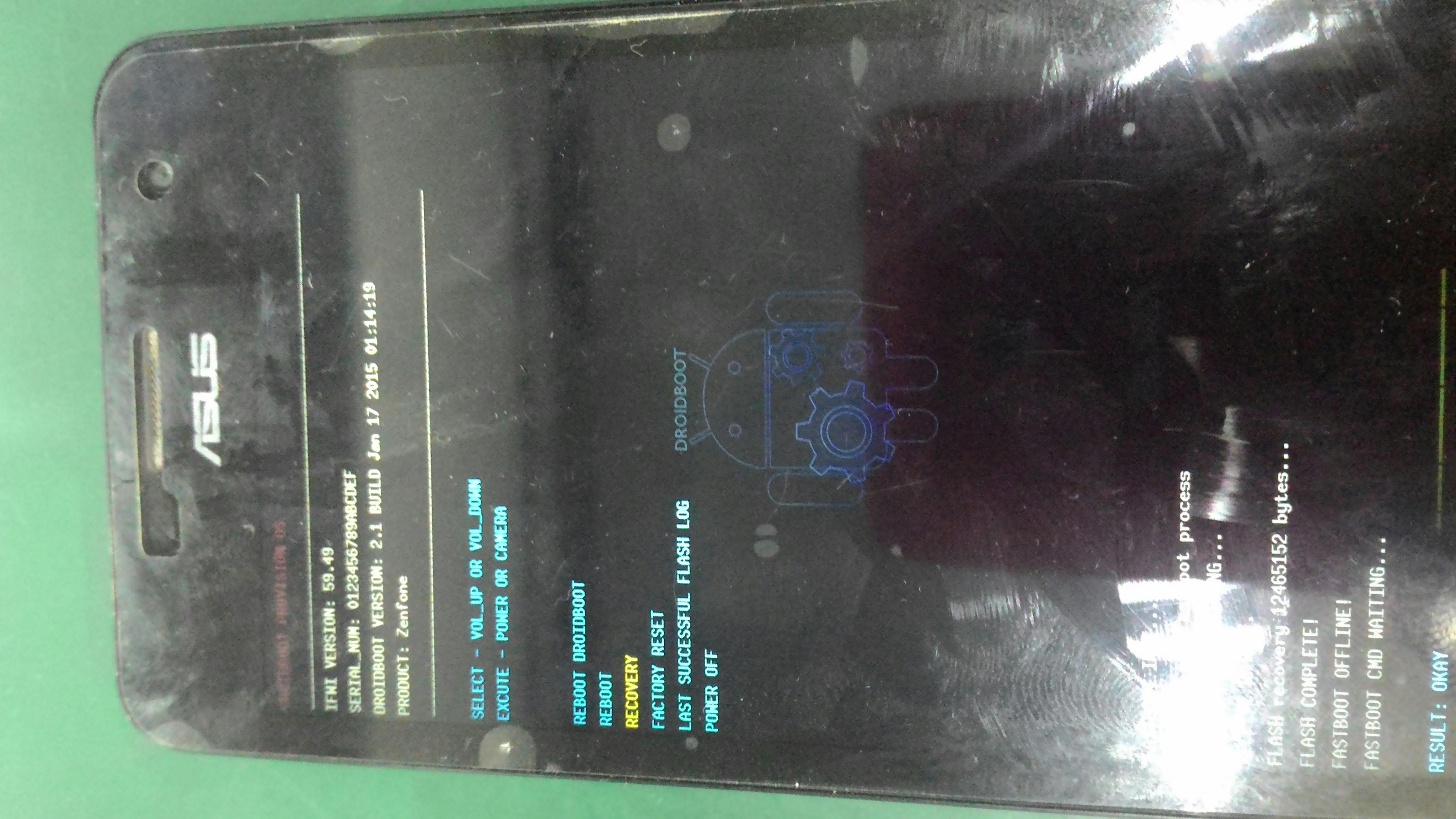

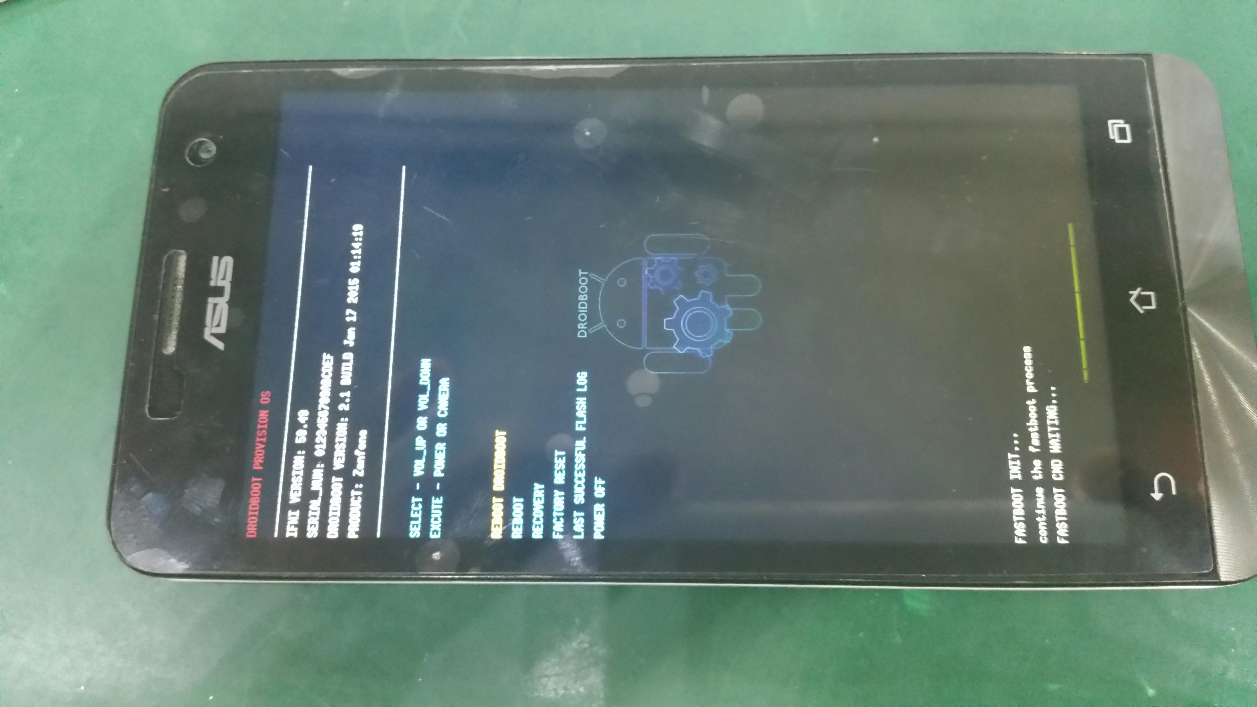

hold volume up + power on para po mg droidboot...
open nYo po ung ndownload nyo s taas..eto po laman nun narename ko n din po para ms madali..

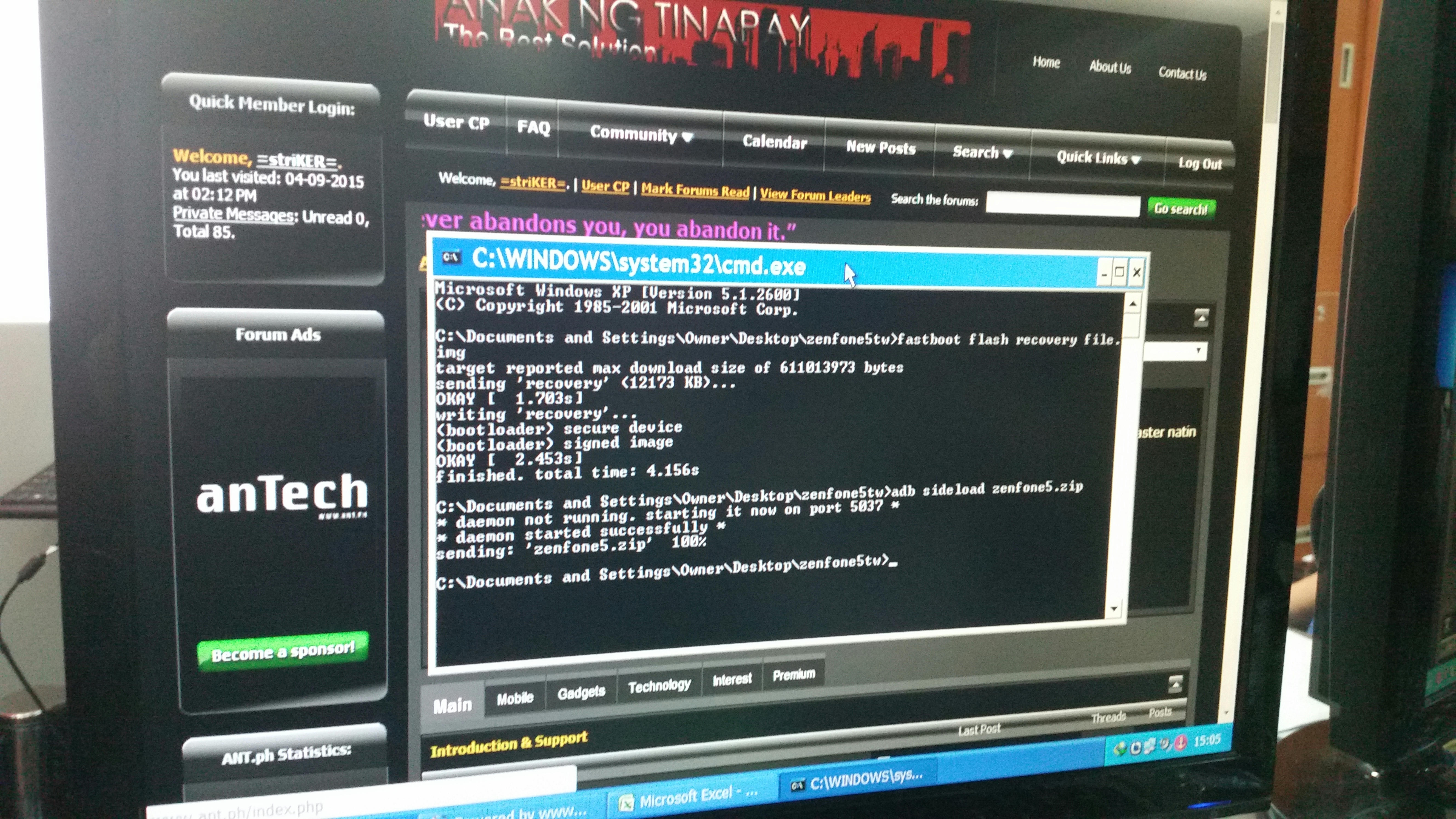

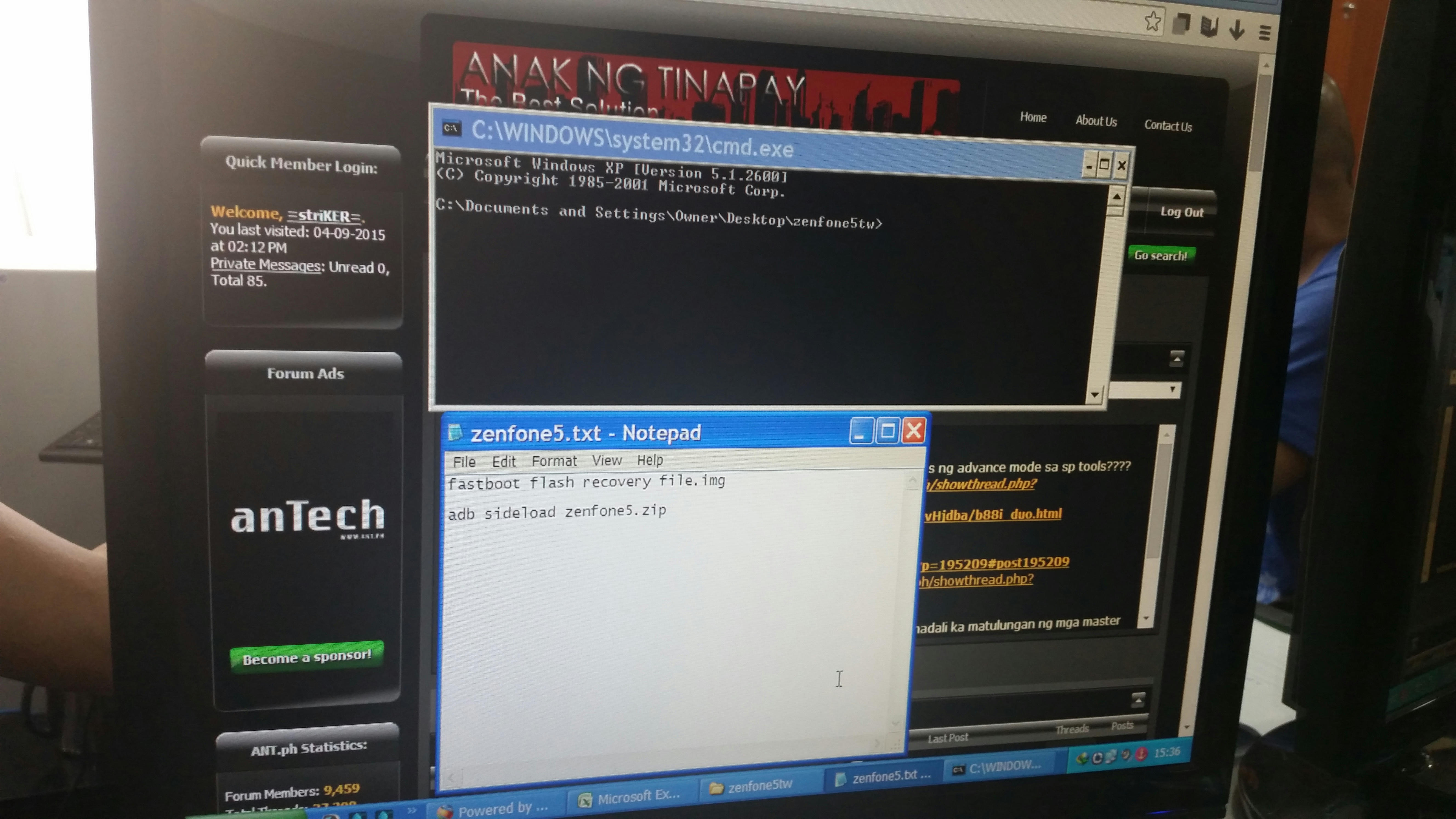

RUN NYO PO UNG START CMD..
MY NILAGAY NA DIN PO AKO TEXT S FOLDER..

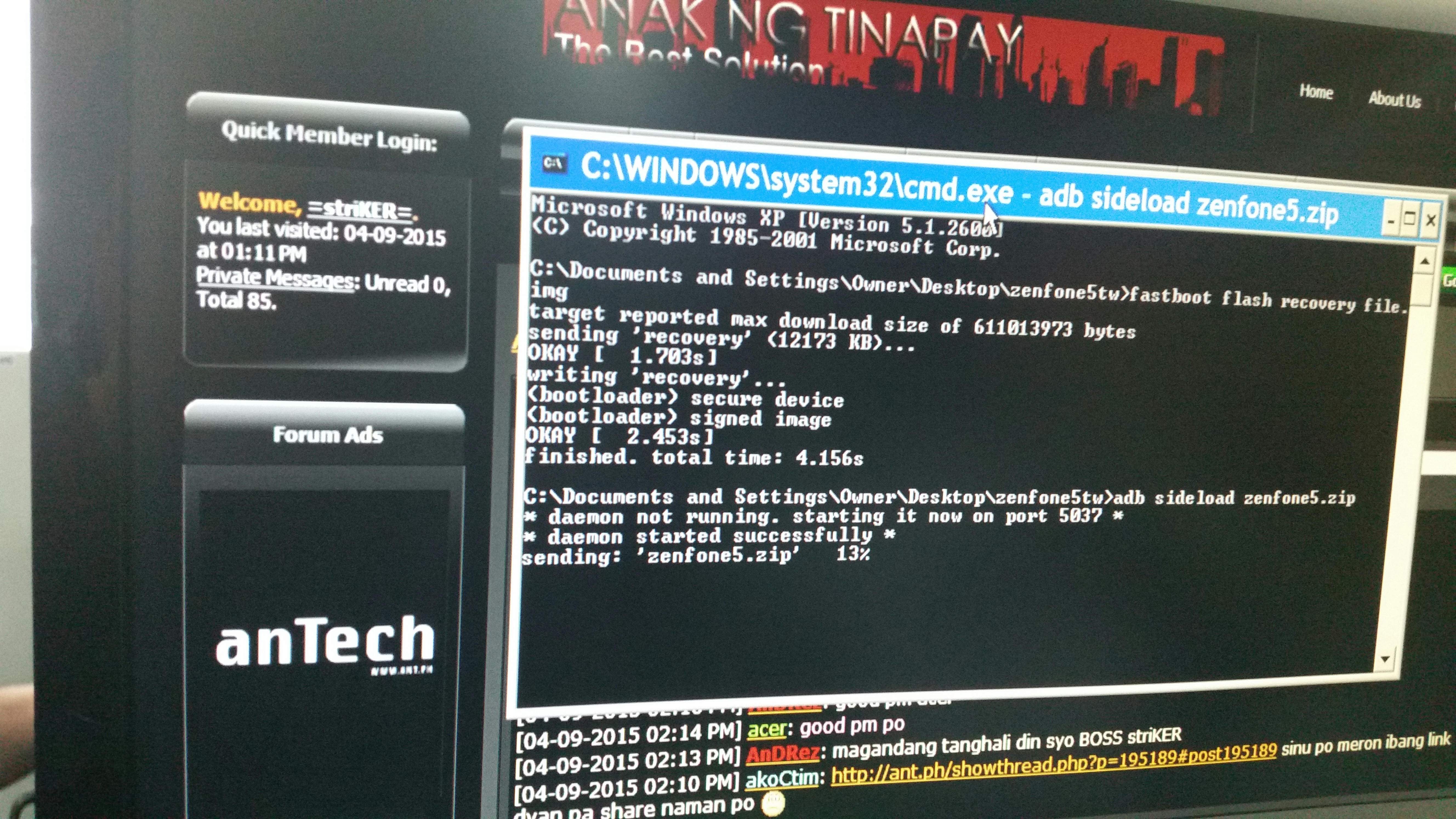

AFTER NG START CMD TYPE NYO "fastboot flash recovery.img" press ENTER
ETO SCREENSHOT PGTAPOS

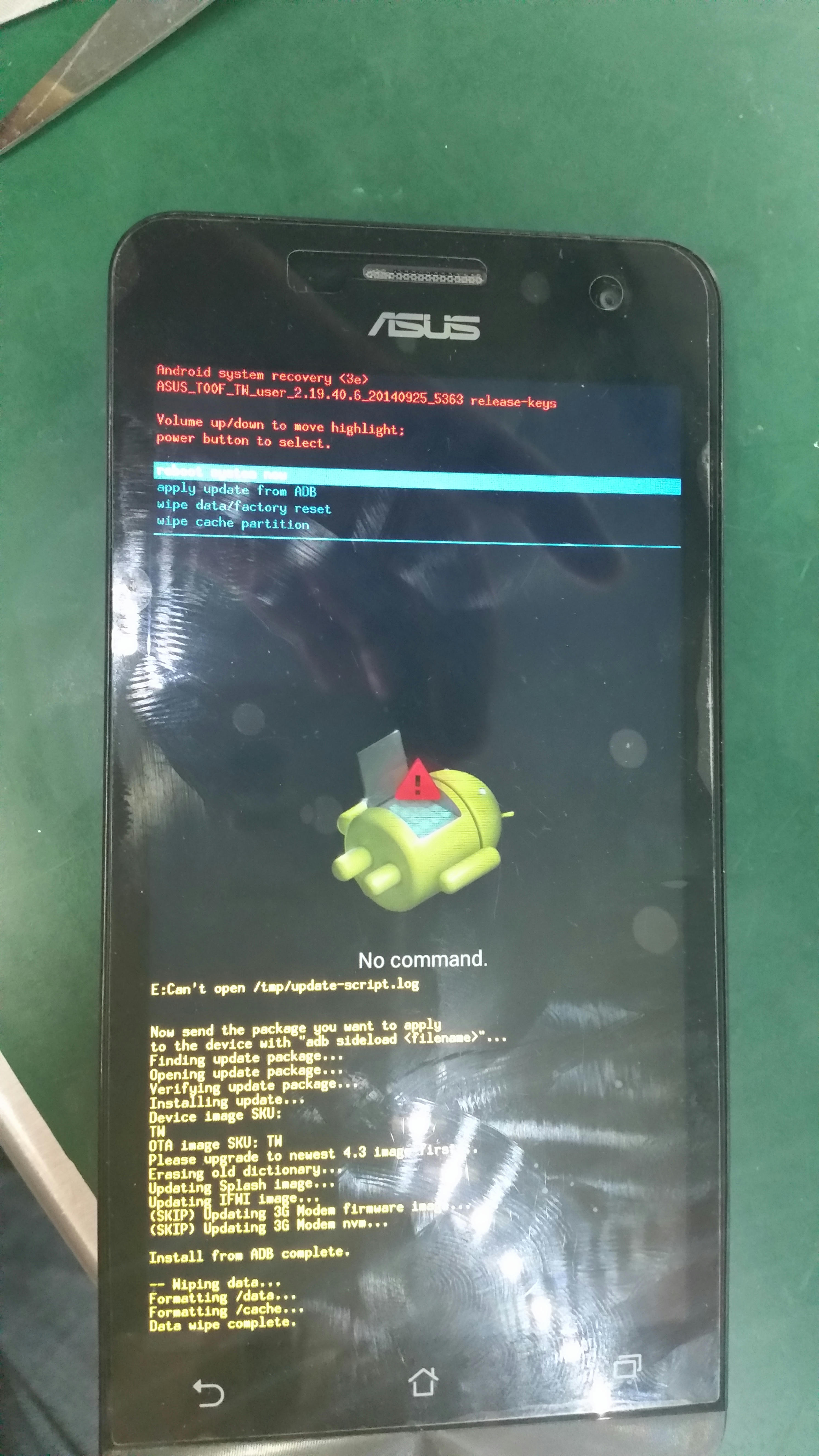

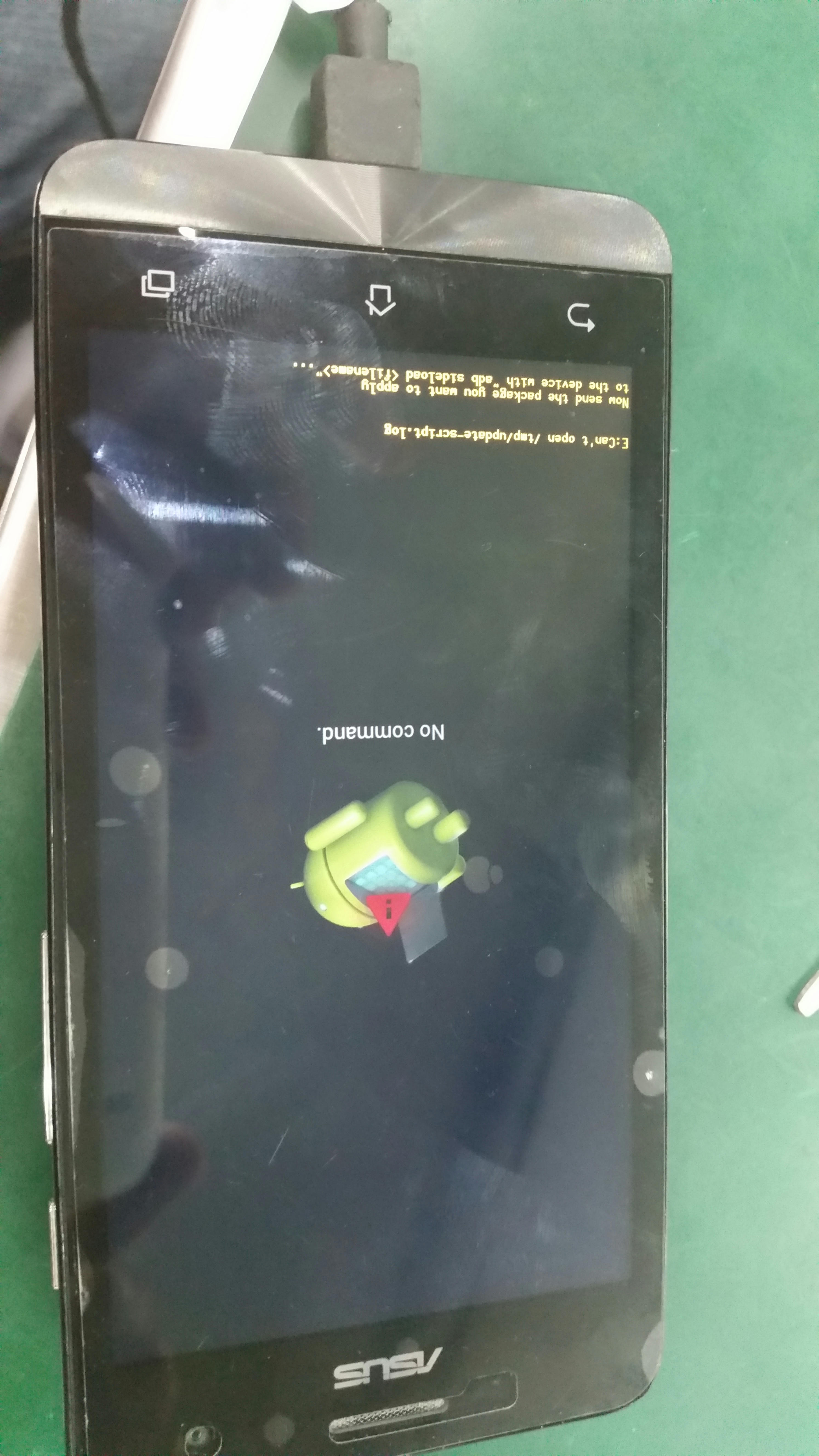

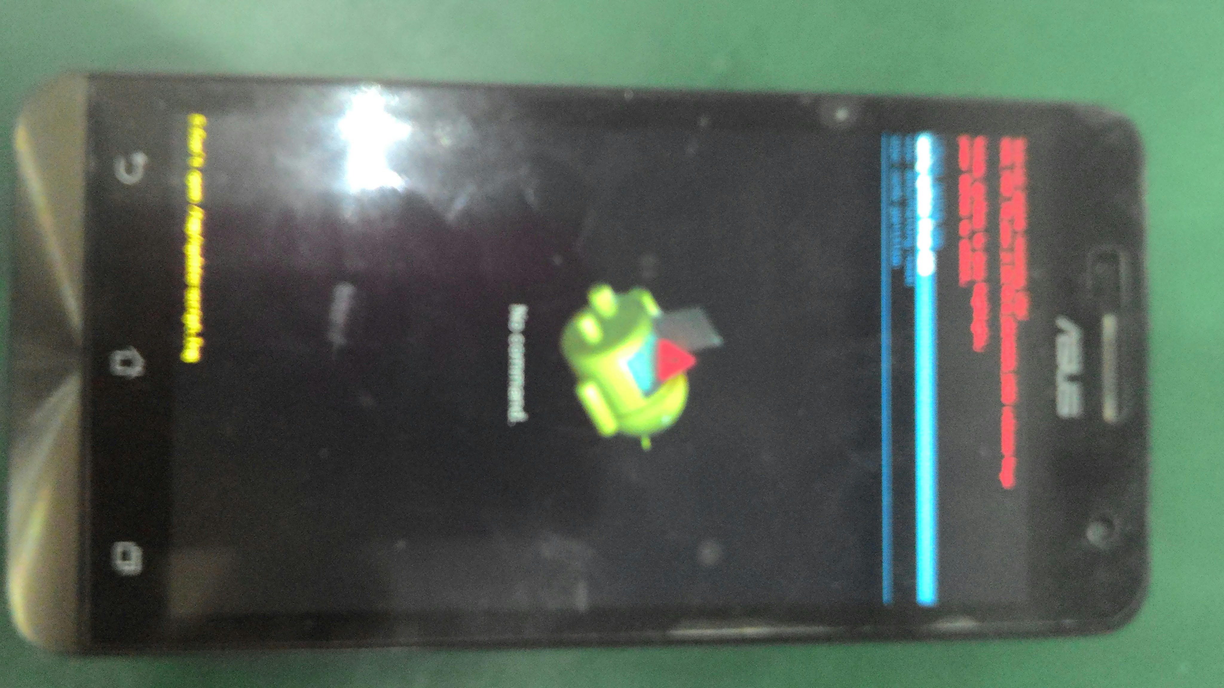

AFTER MG RUN PUNTA PO KAYO S RECOVERY..NO NEED TO TURN OFF THE PHONE
ETO PO LALABAS..
HOLD VOLUME DOWN + UP PARA LUMABAS MENU..SELECT APPLY UPDATE FROM ADB
AFTER PO NUN TYPE NYO NAMAN "ADB SIDELOAD ZENFONE5.ZIP" THEN ENTER
W8 LNG MG 100 PERCENT..
MAG INSTALL PO UN S PHONE..
PGKATPOS WIPE DATA FACTORY AND REBOOT..:D:D
OK N PO....SANA MAKATULONG...:D:D

Maraming salamat po sa pagshare ng firmware, tools at TUT sir!..Nagawa ko po yung Zenfone 5 ng customer!..HAPPY ANT!..
