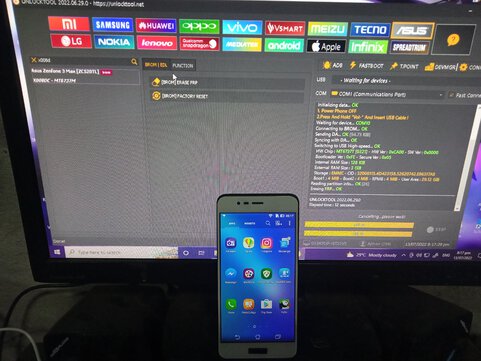

Asus zenfone max 3 frp done by unlock tool
1. open unlock tool
2. select asus
3. select Asus zenfone 3 max x008d mt6737m
4. download this da file. https://drive.google.com/file/d/18EXWE61ftxdJUwDkyQwO4IFt2MTMYGQL/view
5. put mtk all ine one da bin to unlock tool to DA.
6. thick erse frp
7. hold volume down then insert usb cable.
see picture:
1. open unlock tool
2. select asus
6. thick erse frp
see picture:
