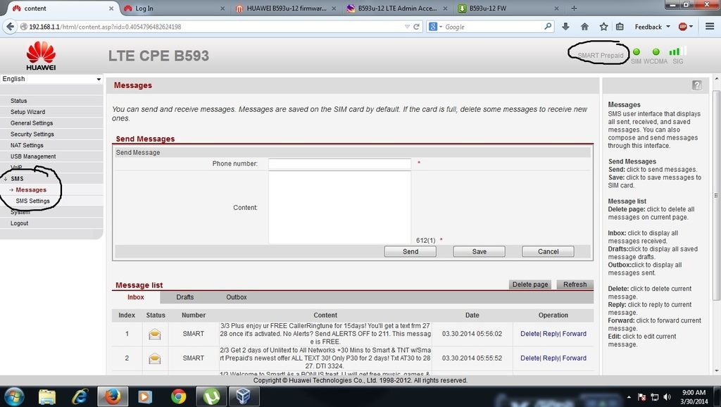

For SMS FEATURE ng B593u-12
Firmware upgrade — Quick Guide for upgrade
1) Download the latest HUAWEI B593u-12 firmware upgrade> (. zip 26 Mb) http://4gltemall.com/ftp/files/B593u...01C26SP054.zip
2) Save the file to your desktop and unzip the file when you are finished.
3) Open your browser and log into your router via 192.168.1.1
Username: admin
Password: xxxx
4) Select S ystem > Upgrade > select tar. (The file you just extracted from the zip. file)> press Upgrade, then wait for few minutes, the system will auto upgrade the firmware of the HUAWEI B593u-12.
By: teerfz
