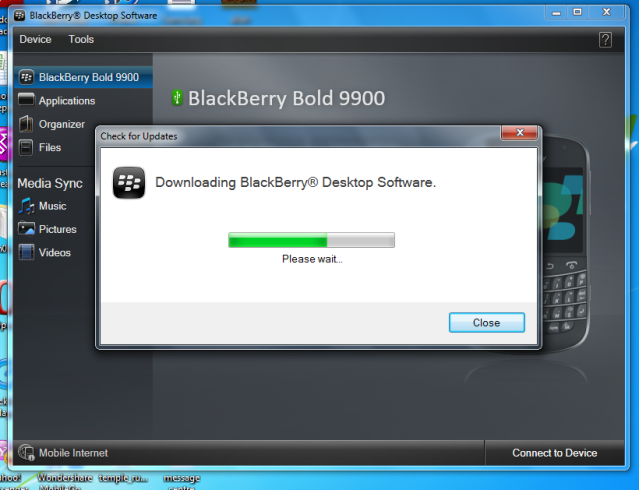

download the latest blackberry desktop download me and install
connect micro USB cable to PC

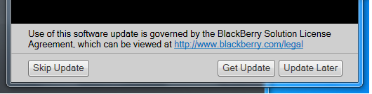

open bb desktop icon
pagbukas mo ng bb desktop
ito makikita mo

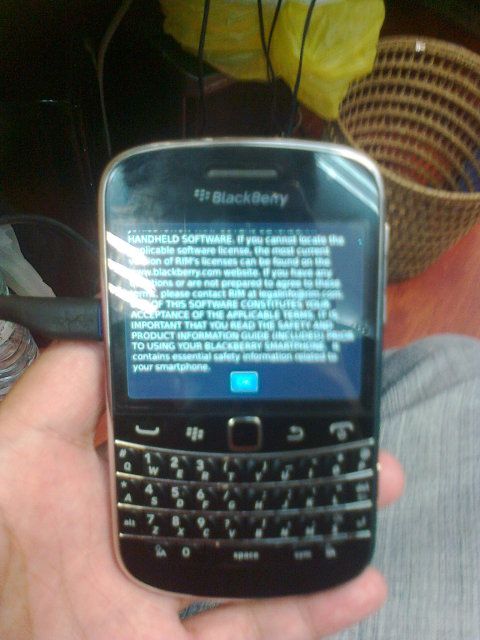

just click update

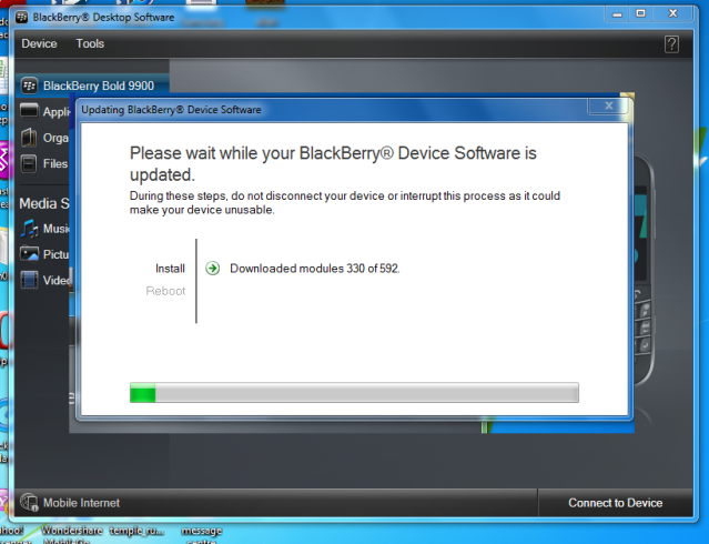

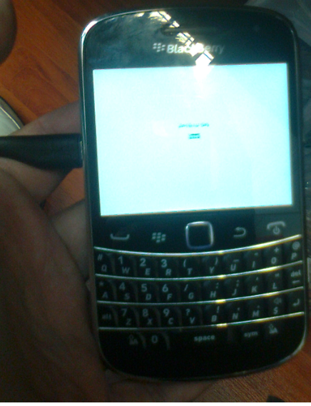

antayin matapos ang downloading ng file usually 30 to 40 menutes depende sa bilis ng internet mo

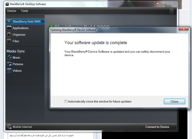

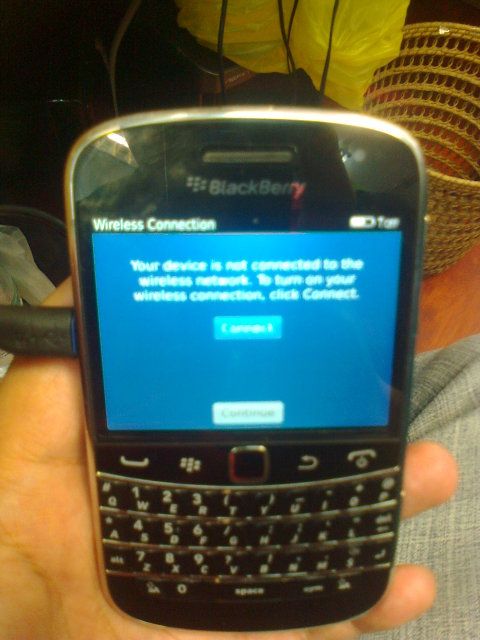

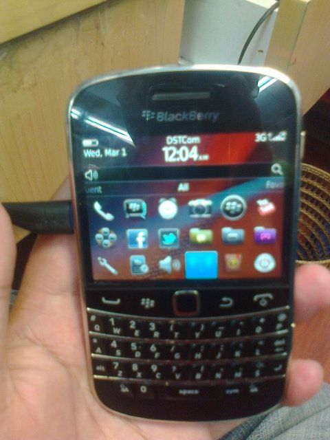

flashing done

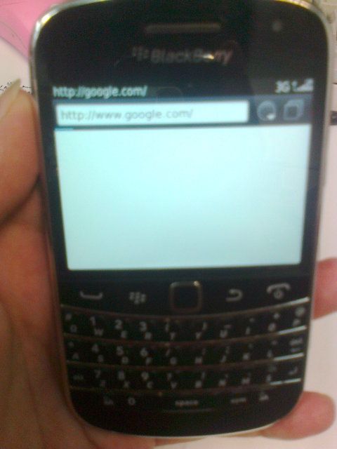

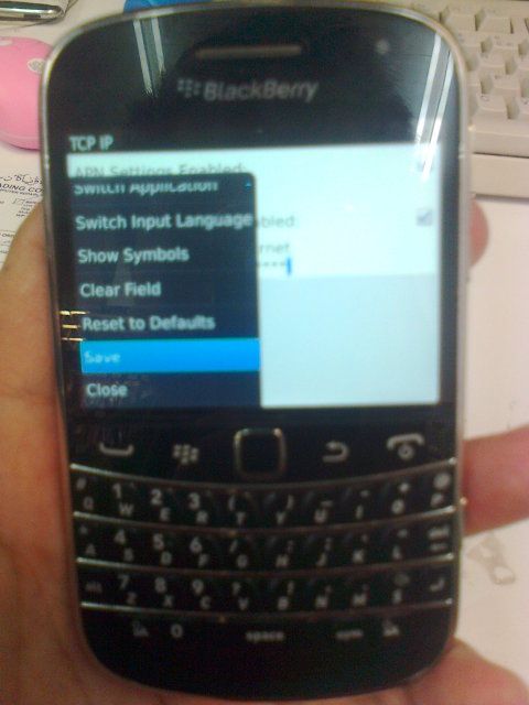

for internet settings > BRUNEI SIM

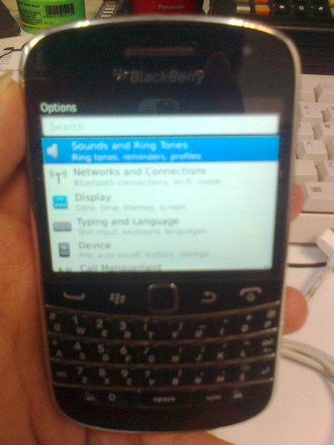

Go to your home screen and select (Options)
Then Select (Device)

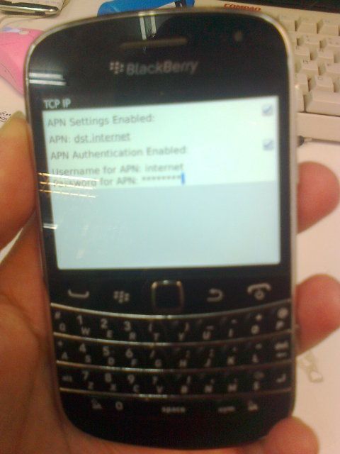

Then Select Advanced System Settings > (TCP/IP)
Then Enter the APN : dst.internet
user name: internet
password: internet

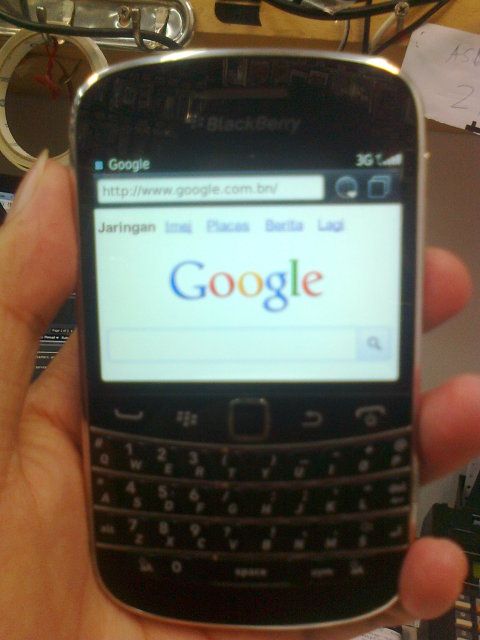

Press the BB Menu key and select (Save)
done na..
ito makikita mo
just click update
flashing done
user name: internet
password: internet
done na..
