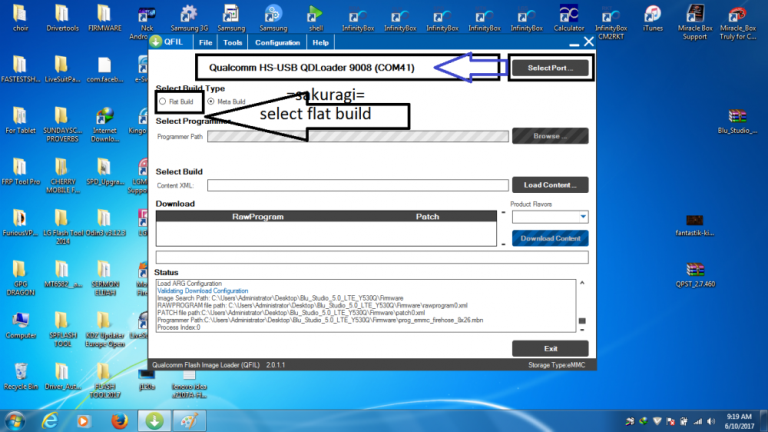

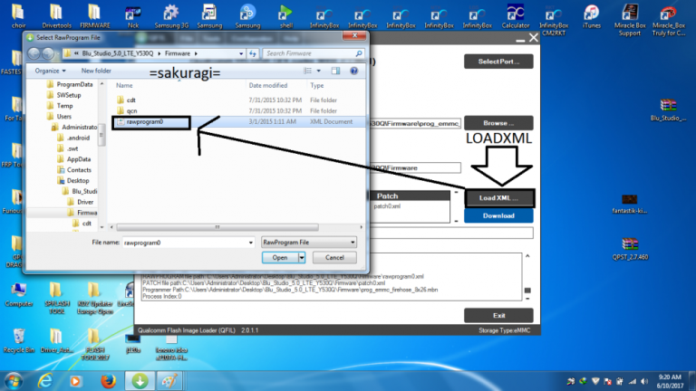

Procedure follow SS:
1. Download first the necessary files
2. install driver if necessary

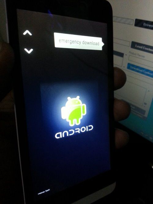

3. put device in "EMERGENCY DOWNLOAD"
How to put device in EMERGENCY DOWNLOAD
* Press Volume up & down together and insert usb cable to deviceand connect to Laptop or Pc then choose Emergency Download
use volume key to "SCROLL" and power key to "OKEY"
your device is now in Emergency download "BLACKSCREEN STATUS"
4. Now open QFIL

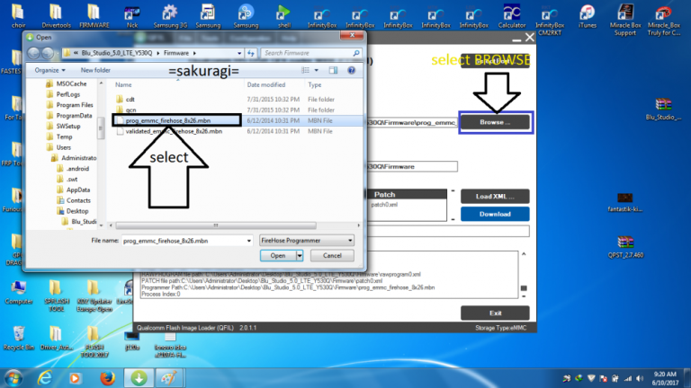

5. Load 3 files
prog_emmc_firehose_8x26.mbn
rawprogram0
patch0

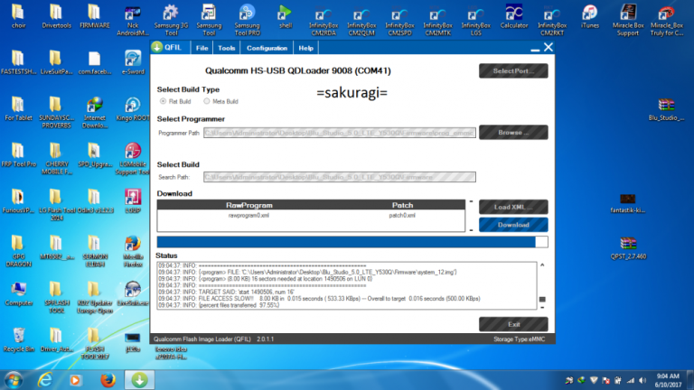

6. Hit DOWNLOAD
FINISH DOWNLOAD
Now your Done

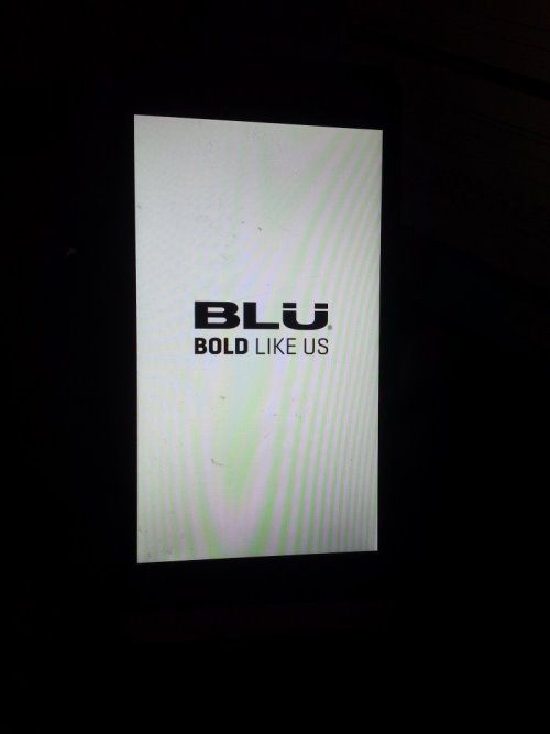

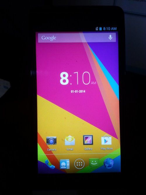

and try open the device
RESULT
