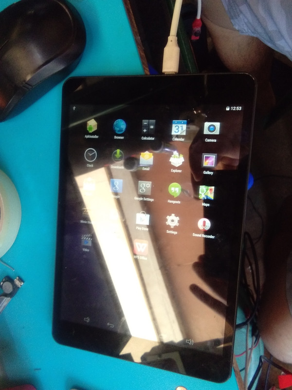

bluewave tab hung on logo done!!
dinala ni 2mer sakin hung ong logo na cya
bigla nalang daw nag hung nung nag laro cya
ito po gamit kung firmwere kasama na ang tools na gamit ko
use tatsulok for password nalang po mga sir...

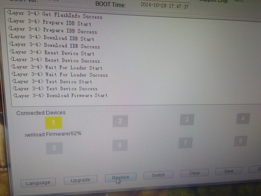

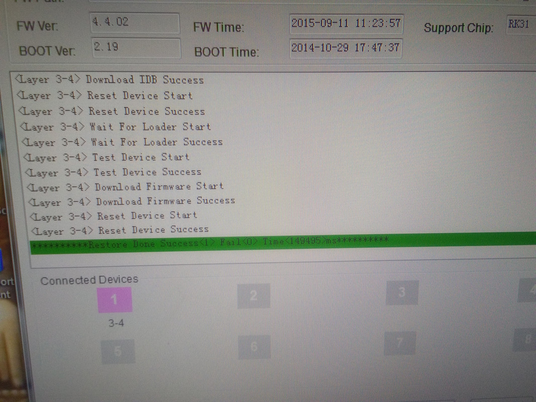

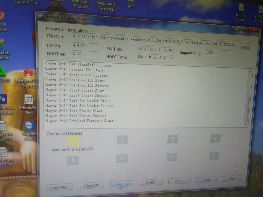

ito po ang procedure
Power of the tab.
Run RK Batchtool
Click firmware patch and Open update firmware
Press & hold back button and connect usb cable
done po..
