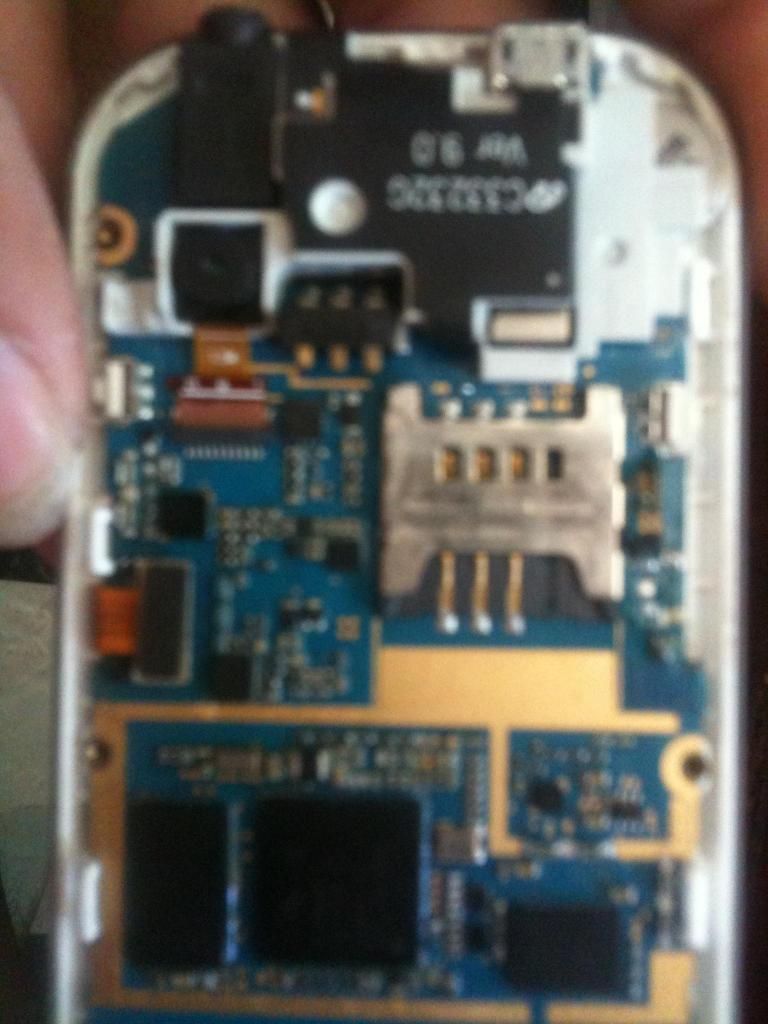

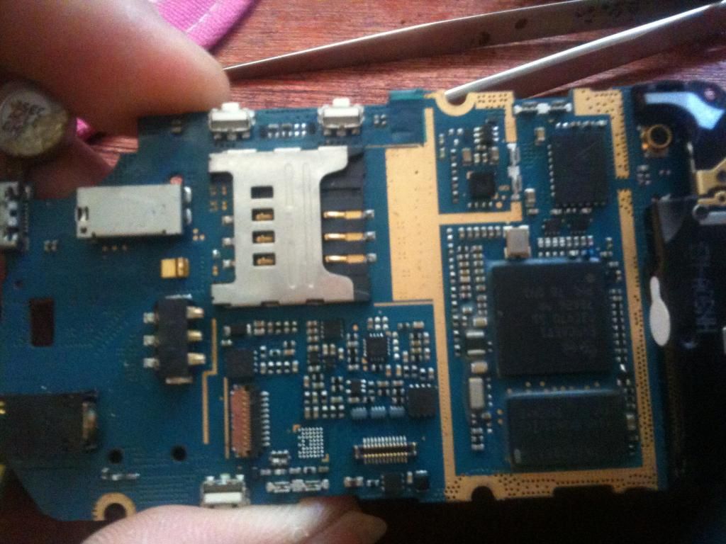

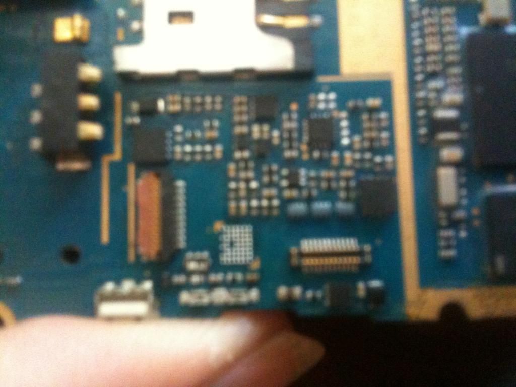

share koh lang mga boss..
c3303k umiinit ung buong board pero hindi naman shorted..
history:galing nah ng ibang technician..
action :replace radio and bluetooth ic
kaya may reheat nah ang touchscreen ic at iba't ibang ic..
kaya ginawa koh kinapa kung saan ang umiinit..
kaso un nga unang tingin koh sah may touchscreen banda..
kaya first option koh use Search button..kaso walang nakapost.
kaya 2nd option full cleaning koh muna..kaso no luck..
3rd option medyo kinalog koh ung malapit nah ic sah touchscreen connector..pero no luck
aun nadali sah 4th option.. naalala koh ung nokia..pag umiinit pero hindi shorted radio at bluetooth ic..kaya search koh kay pareng google c radio at bluetoot ic..
e2 nah poh ung ginawa koh..
bali pwede ding hindi xa palitan..kaso hindi nga lang gagana ung bluetooth at radio nya..
pero dahil my pamalit akoh..
kaya e2 nah poh xa..ilang oras nah xang nakaopen..hindi nah xa umiinit..
done nah poh xa..
sana makatulong sa mga newbie nah katulad koh..
thanks for viewing..
