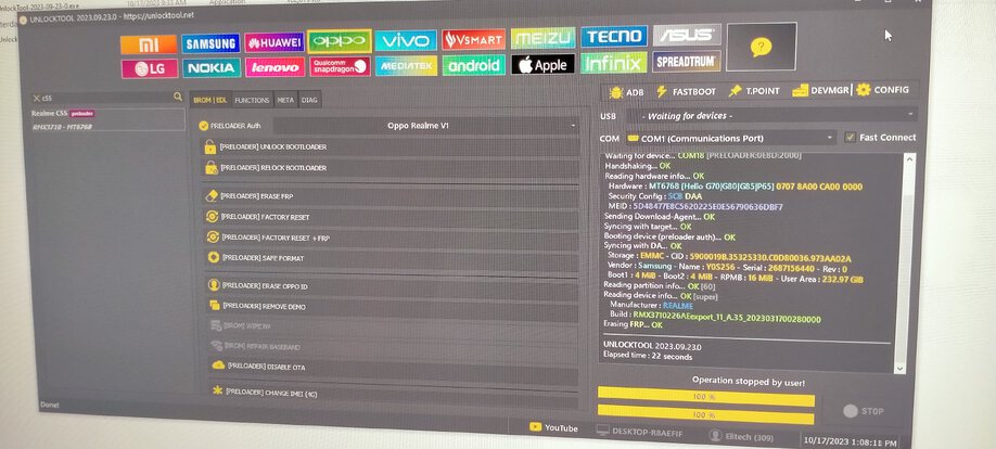

troy18 Premium 2024 Joined Aug 20, 2014 Messages 505 Reaction score 83 Points 81 Location Sorsogon City Oct 17, 2023 #1 Open UT select model C55 (preloader) Erase FRP HOLD vol up + VOL down insert USB TYPE C DONE :
JULAY20 Moderator Staff member Joined Aug 6, 2014 Messages 10,044 Reaction score 2,716 Points 1,611 Location KORONADAL CITY Oct 17, 2023 #2 how to ss pic on loptop or pc pag nag post ka dol try mo ito para mas malinaw yung pic
J JAY18 Expired Account Joined May 22, 2018 Messages 215 Reaction score 72 Points 201 Location Quezon Province Dec 19, 2023 #3 troy18 said: Open UT select model C55 (preloader) Erase FRP HOLD vol up + VOL down insert USB TYPE C DONE : View attachment 28670 Click to expand... thanks idol
