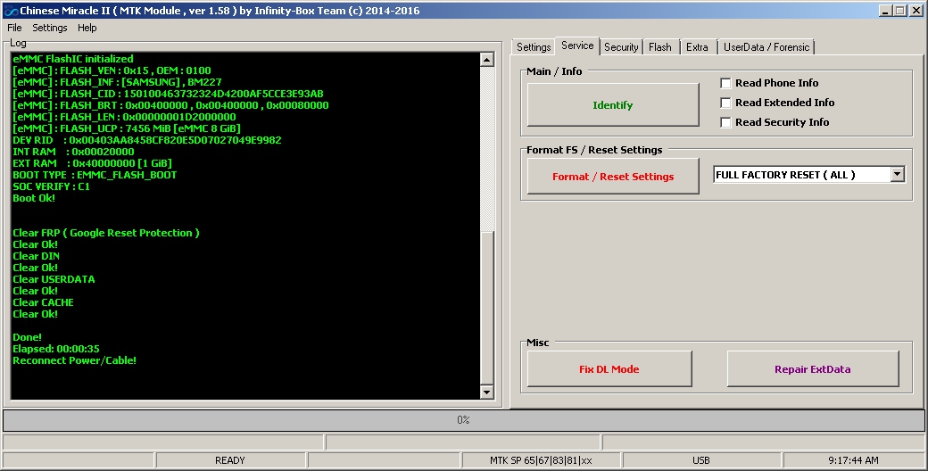

andreivi Expired Account Joined Jul 30, 2014 Messages 1,986 Reaction score 271 Points 381 Location Sison, Pangasinan/ Rosario, La Union Mar 8, 2019 #1 share lang for reference mga boss Cherry mobile flare A3 pattern lock done sa CM2MTK open nyo po CM2MTK select platform click service tab click format/reset settings salpak yung unit sa usb ng nakaoff antayin matapos done
