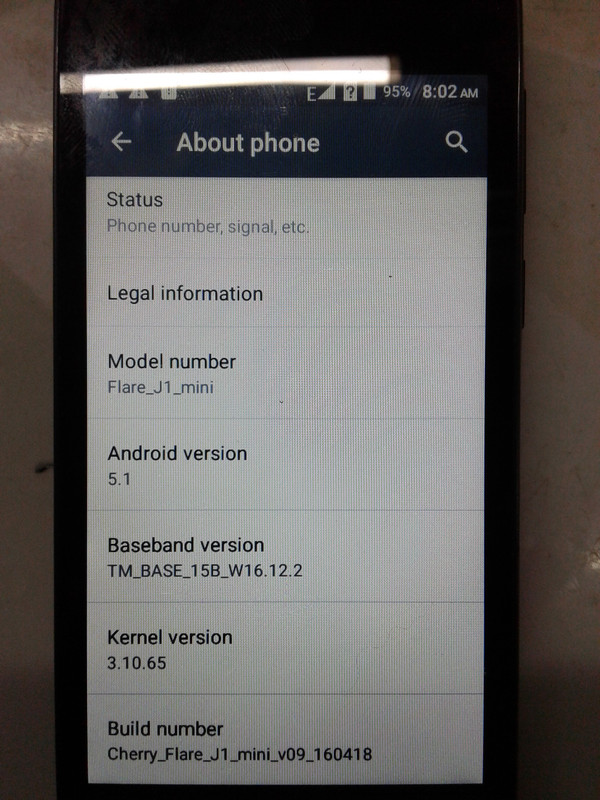

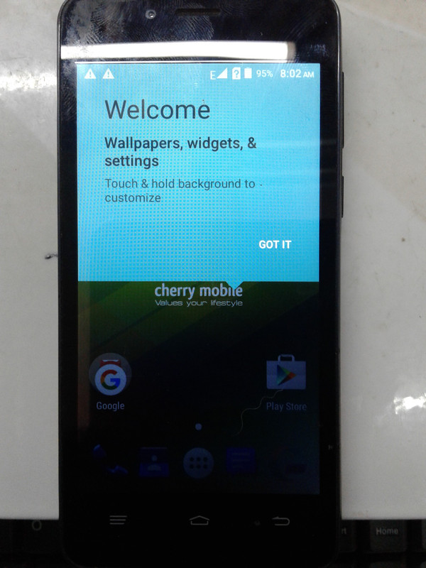

andreivi Expired Account Joined Jul 30, 2014 Messages 1,986 Reaction score 271 Points 381 Location Sison, Pangasinan/ Rosario, La Union Sep 12, 2019 #1 for reference Cherry Mobile Flare J1 Mini FRP done sa CM2 open cm2spd select correct platform click service tab click format fs / reset phone / clear frp connect unit (turned off) to usb done
