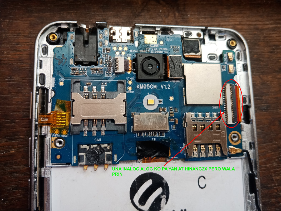

HISTORY DINALA SAKIN WALANG ILAW LCD PERO TUMUTUNOG PAG INUPIN M,,
NGAYON PALIT AKO AGAD LCD..NKA DALAWANG LCD N AKO BNEW AT 2HAND
PERO WALA PARIN..KYA NAPAISIP N AKO BUKSAN C UNIT NA..UNA ITO MUNA GINAWA KO

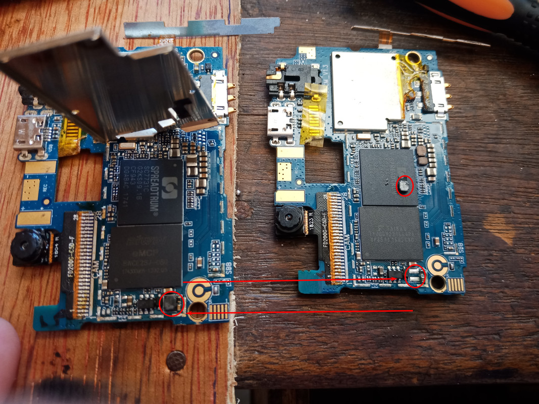

NO LUCK D NADALA SA GANUN..KYA BAKLAS KO N ANG LIKOD NYA..
AT TRY KUNG PAG PALITIN SILA NITO SAME UNIT PARIN..

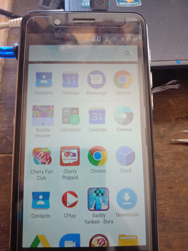

AFTER PALITAN..SALPAK N LCD NG M TRY..
AYUN UMILAW RIN...
NEW B LNG PO SANA MAKATULONG DN PO SA INYO..
