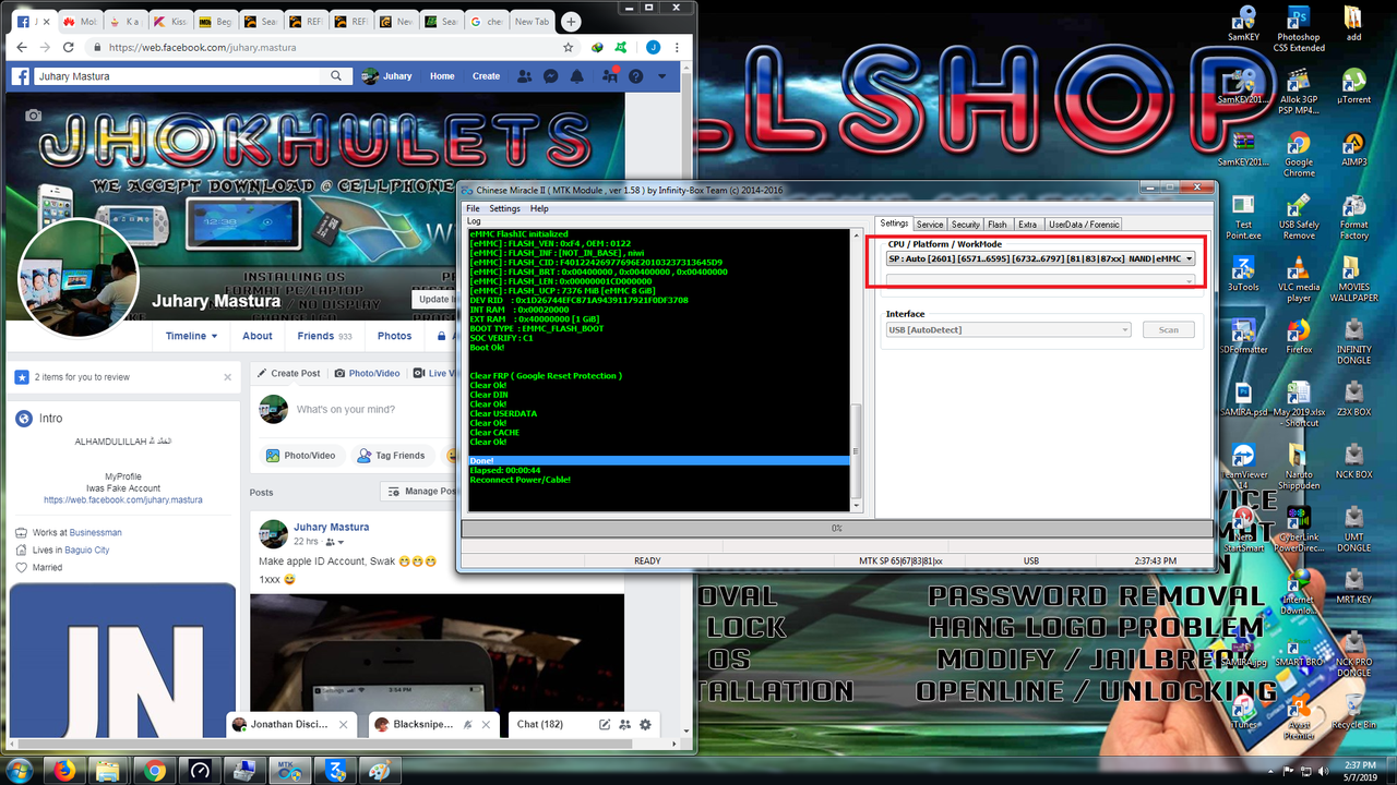

Infinity CM2 Dongle

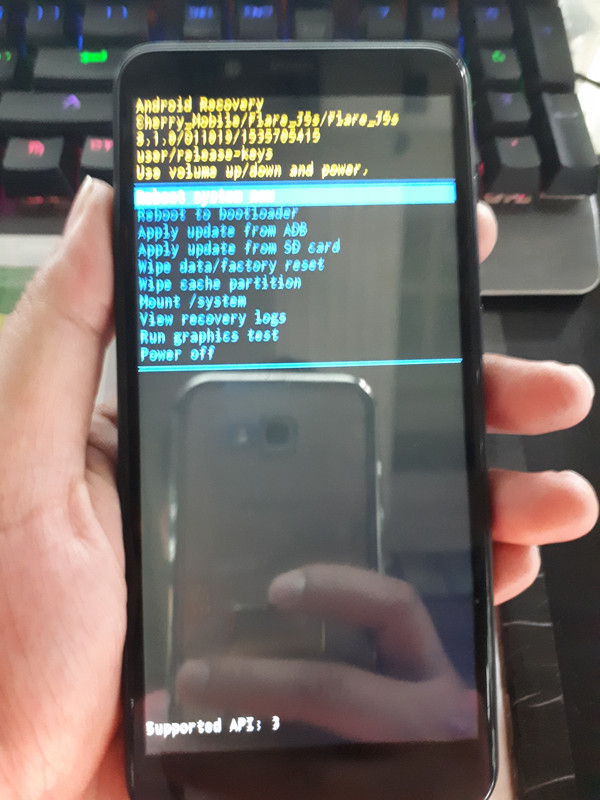

1st Hard Reset ko muna ang unit kasi naka pattern
Press Volume down and power mag rerecovery yan alam muna sunod

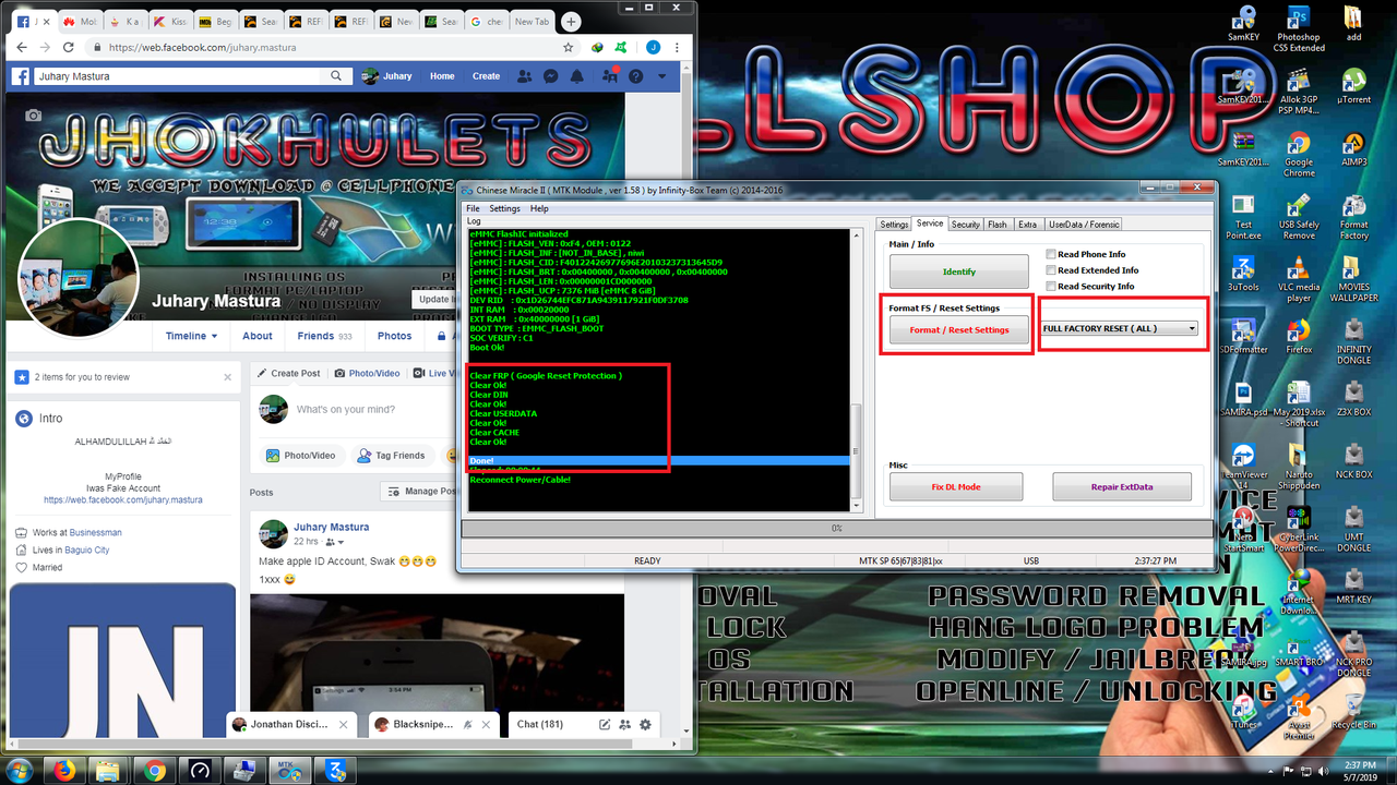

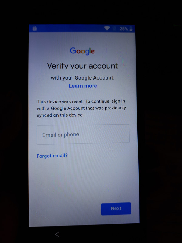

After Hard reset my GOOGLE ACCOUNT pa kaya proceed na ako sa pag flash Via InfinityBox CM2MTK
Open InfinityBox CM2MTK and set mo ito parang sa picture

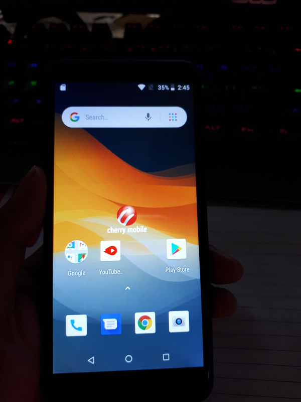

FINISH PRODUCT
