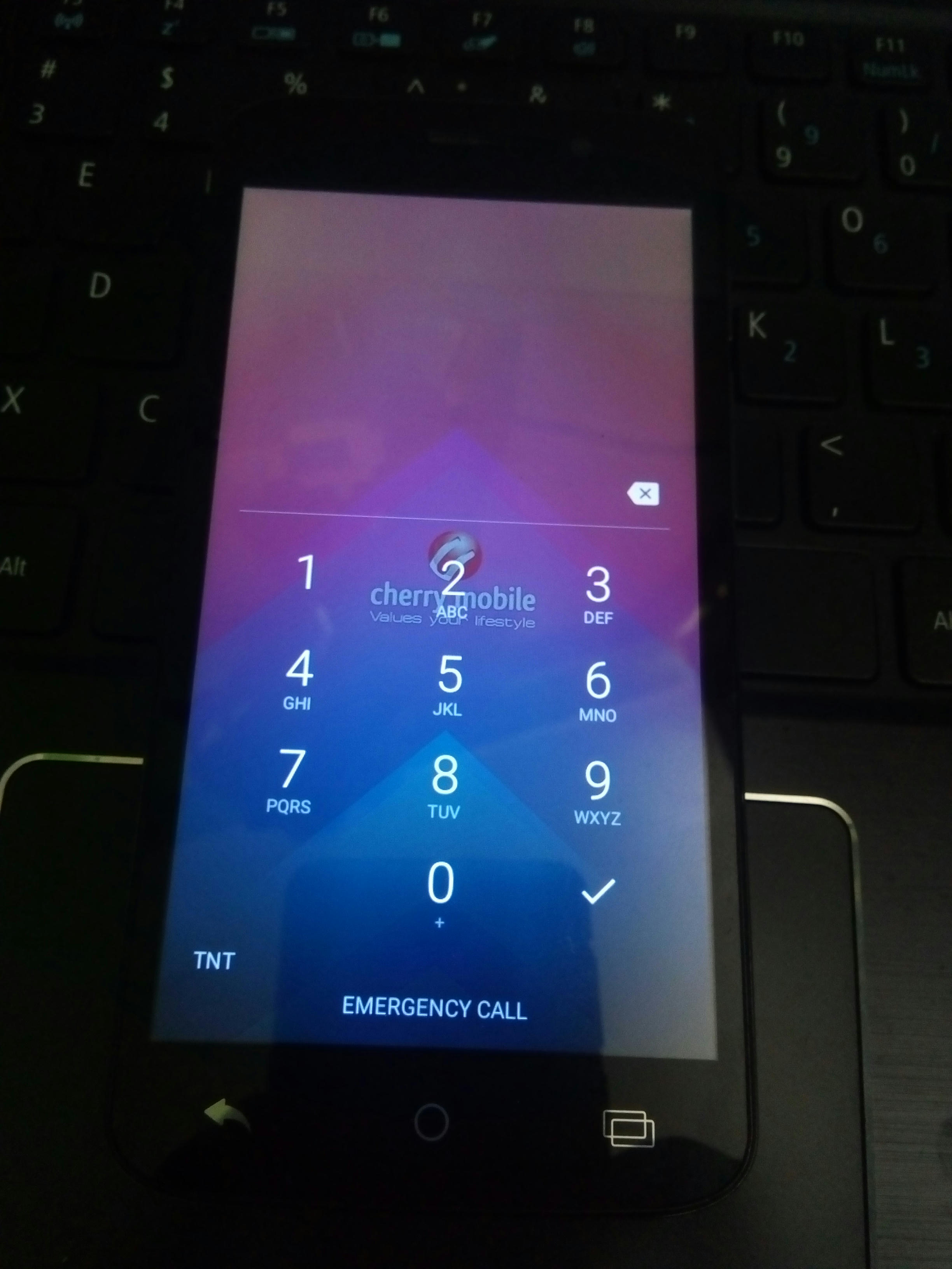

Phone History: Bigla lng ng shutdown ang phone at nung e on uli ang unit eh nagka privacy lock na..
Kaya na try ko na po e gawin ko paanu ko mbigyan ng solusyon kc wala pa ako nkita na meron nakapagpost... e2 po ss ng phone

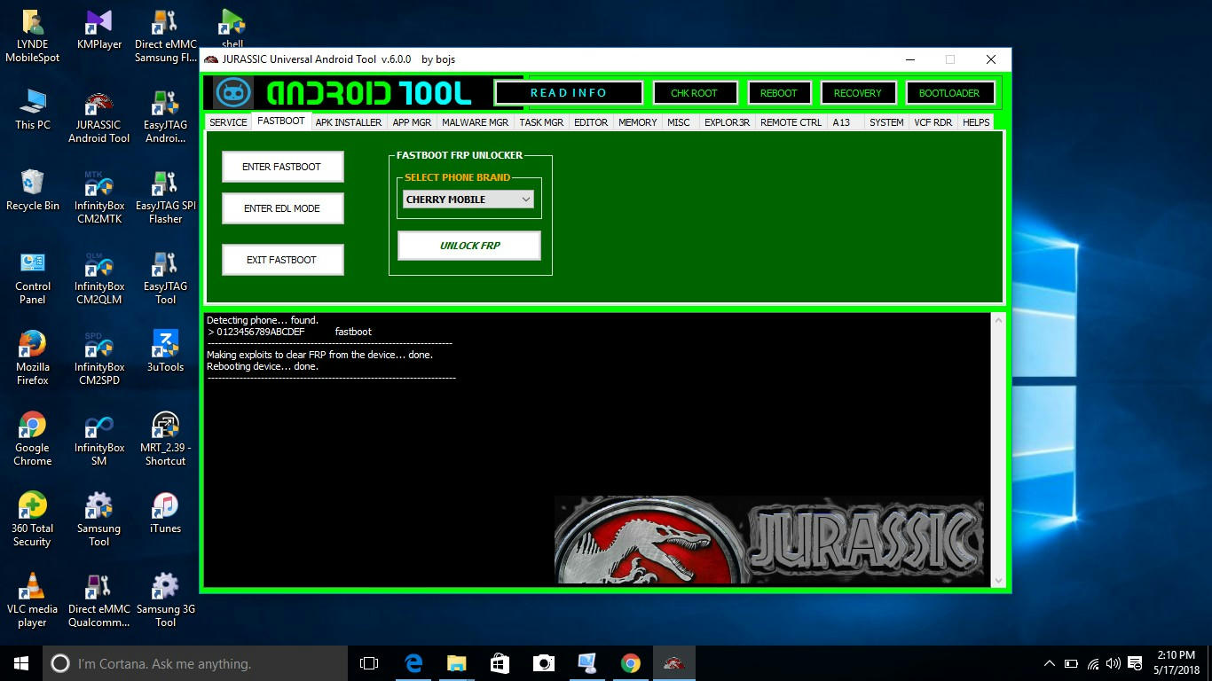

e2 po ung free software na update ni sir bojs
put the phone in fastboot mode by holding vol.+ and power and release when android pop up
and tick fastboot tab and select cherry mobile and connect urt cable to pc and unit and click remove frp...done

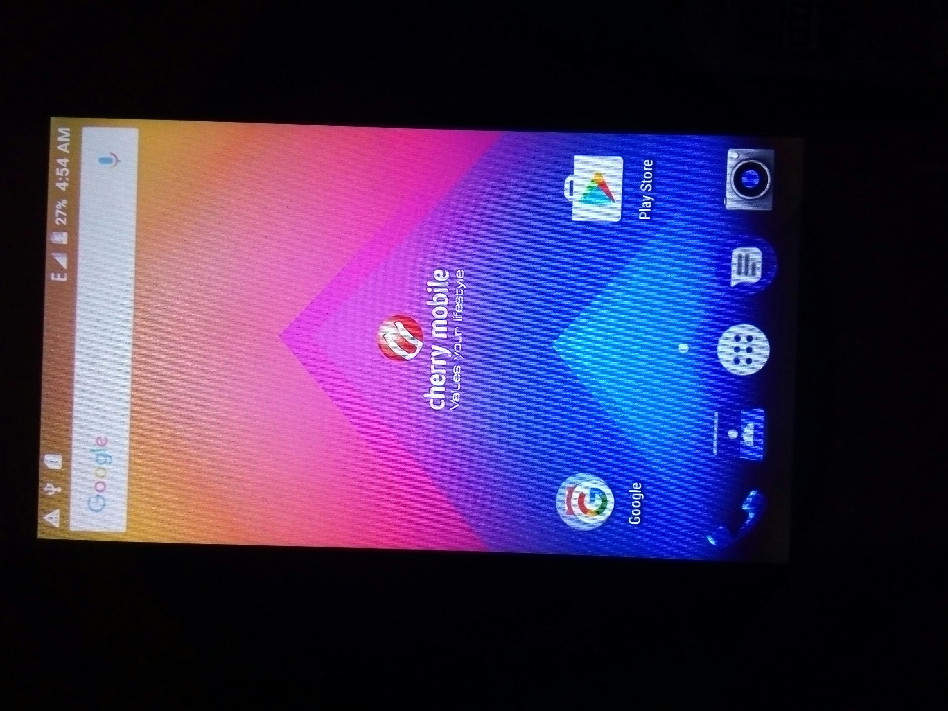

Done at magandang umaga po sa lahat..
