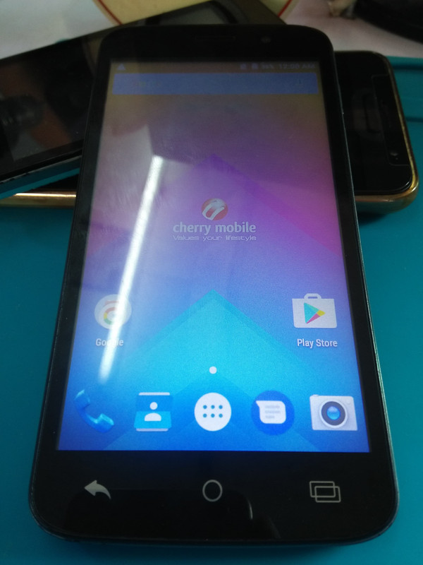

HISTORY: Bigla raw lumabas ang privacy lock sabi ni tumer.

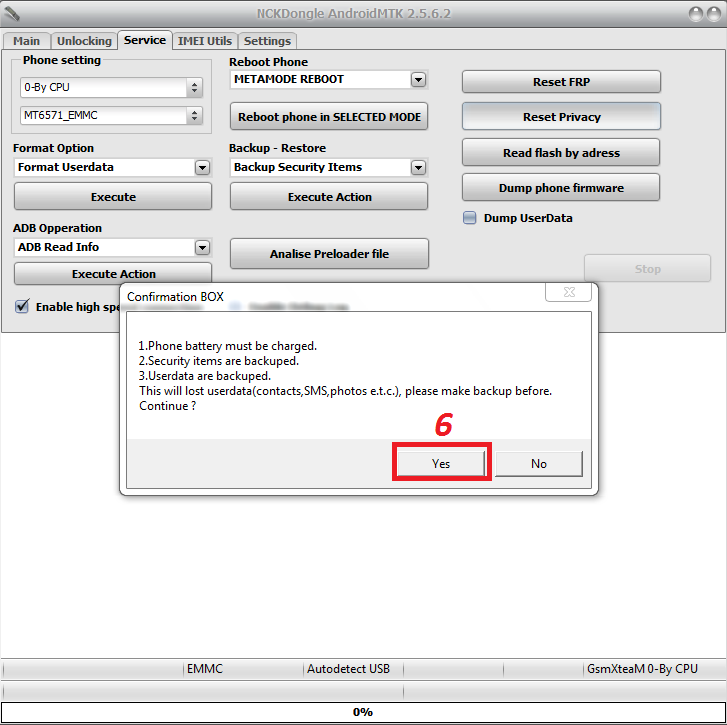

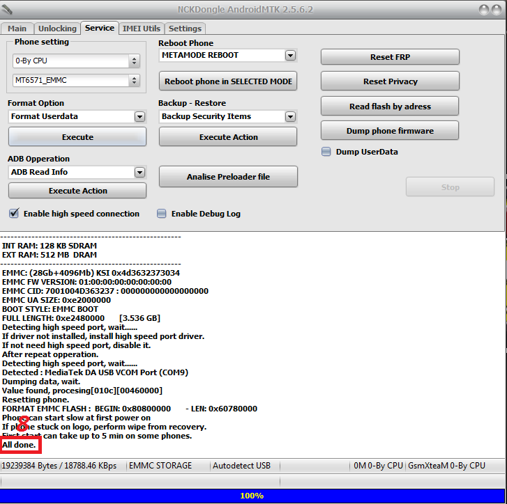

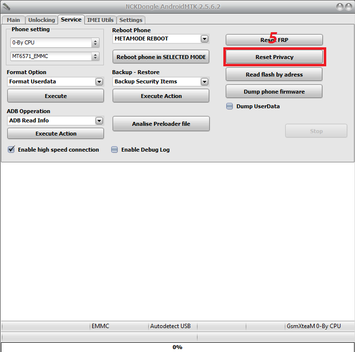

PROCEDURE:
* Open Nck crack click settings
https://forensicanthropologist.net/salary
* Click "select custom loader"
* E locate sa my computer kung saan nakalagay ang da file
https://postimages.org/
* Click service
* Click "reset privacy"
* Click yes
* Insert usb cable
* And DONE
