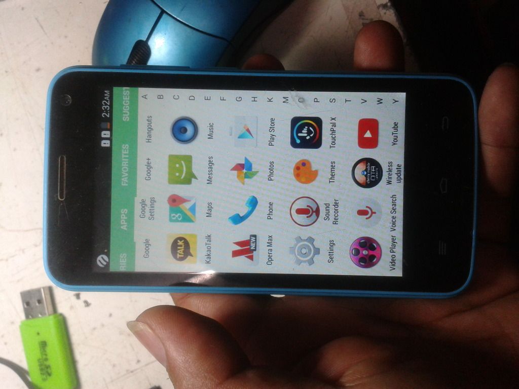

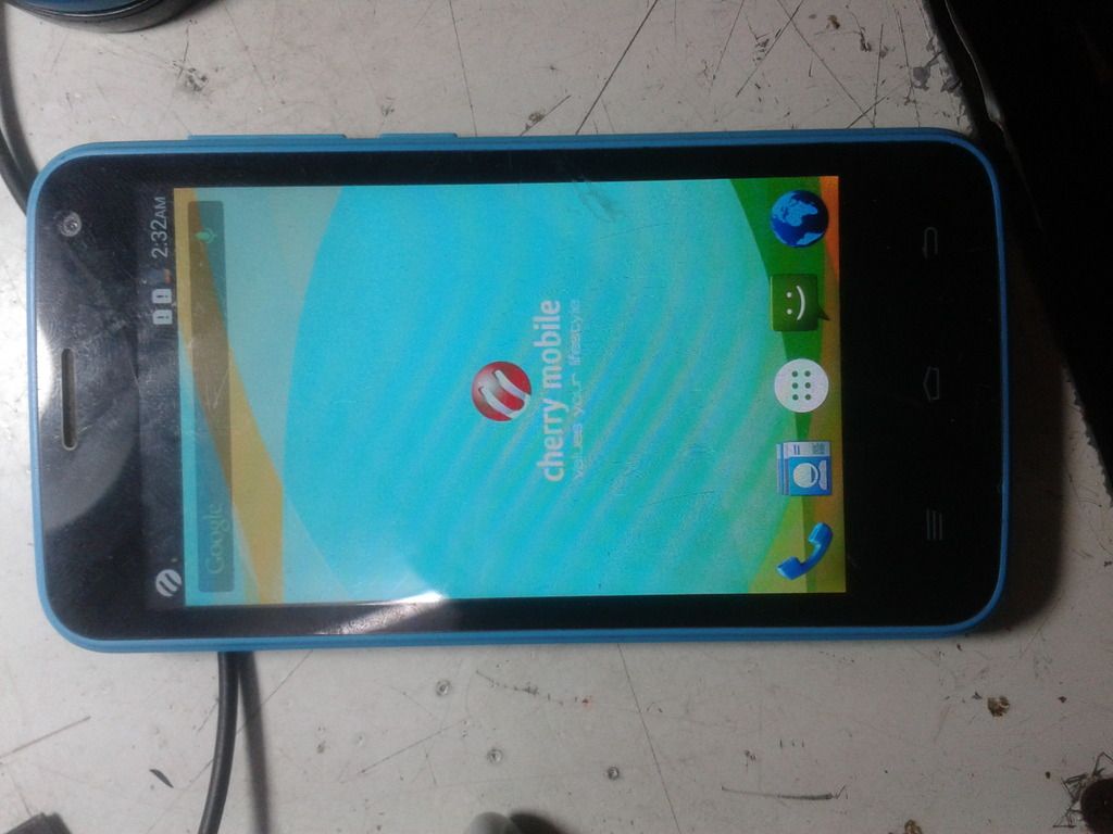

Cherry Mobile Flare Lite 2 sexy virus done sa flashing miracle crack
5
818
823
Relica14
Feb 27, 2016
181

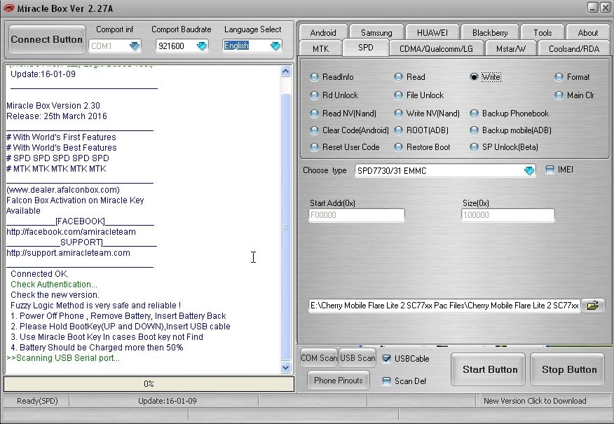

1. run miracle 2,27a crack
2. click on spd
3. choose type select SPD7730/31 EMMC
4. click WRITE
5. load firmware
6. press START button
7. power off ang unit press volume down insert usb cable.....
install drivers if needed
wait for flashing to finish....:-?:-?:-?:-?:-?
done.....
