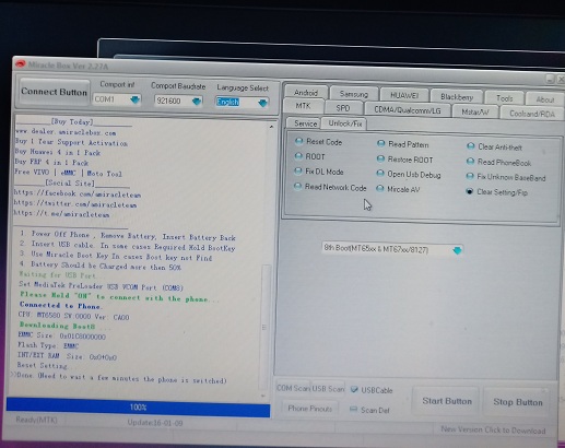

1ST SA MIRACLE NAG SUCCESS SYA PERO GANUN PADIN
(NOTE KELNGAN GAWIN TO PARA MAG SUCCESS)
CLICK MTK CLICK UNLOCK/FIX THEN TICK CLEAR SETTING FRP

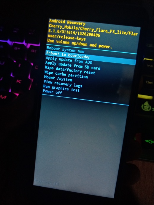

THEN 2ND OFF MO YUNG THEN HOLD VOLUME UP AND POWER BUTTON
LALABAS TO
CLICK REBOOT TO BOOTLOADER

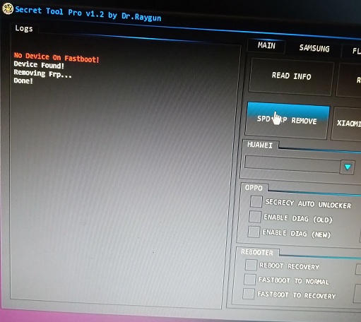

OPEN SECRET TOOL MULA SA ATING TAHANAN
CLICK SPD FRO REMOVE

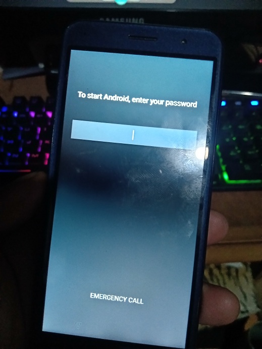

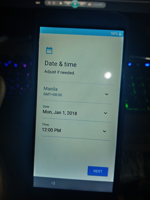

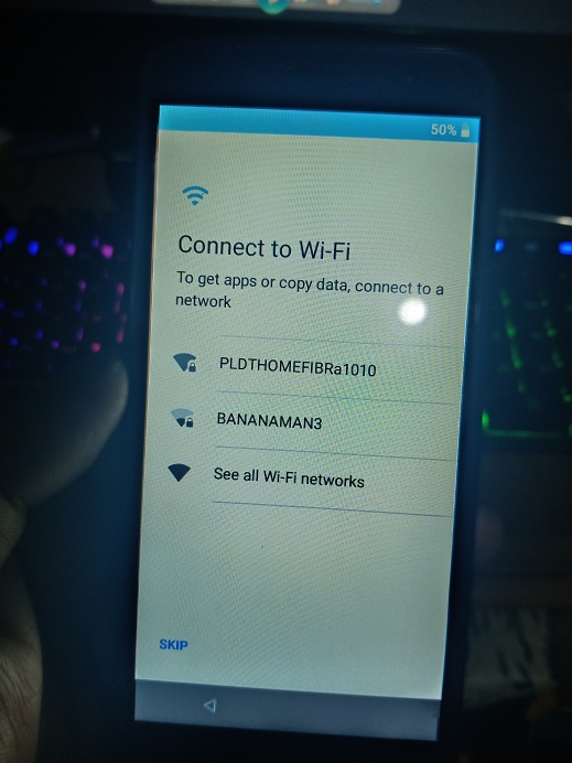

PAG OPEN NG PHONE GANITO LALABAS
SO ANG GAGAWIN NATIN HARD RESET NATIN SI PHONE

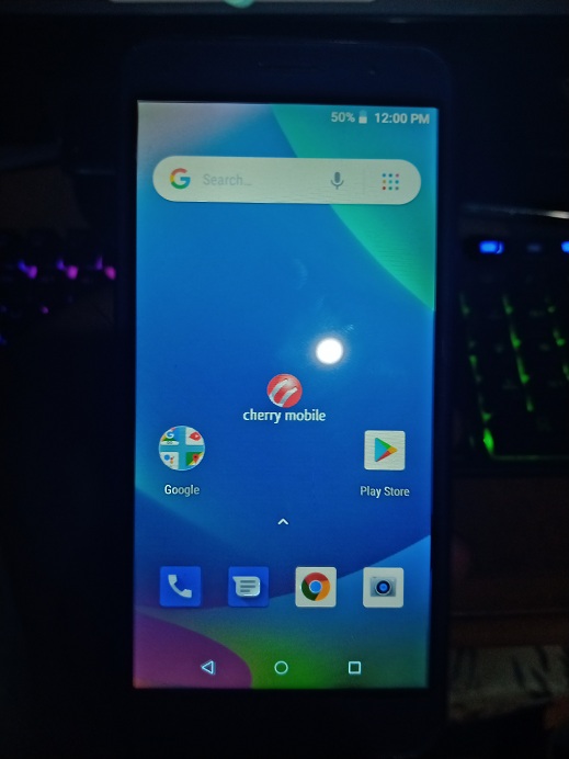

THEN AFTER THAT WAIT TO REBOOT

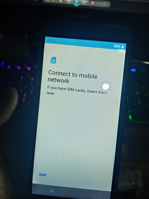

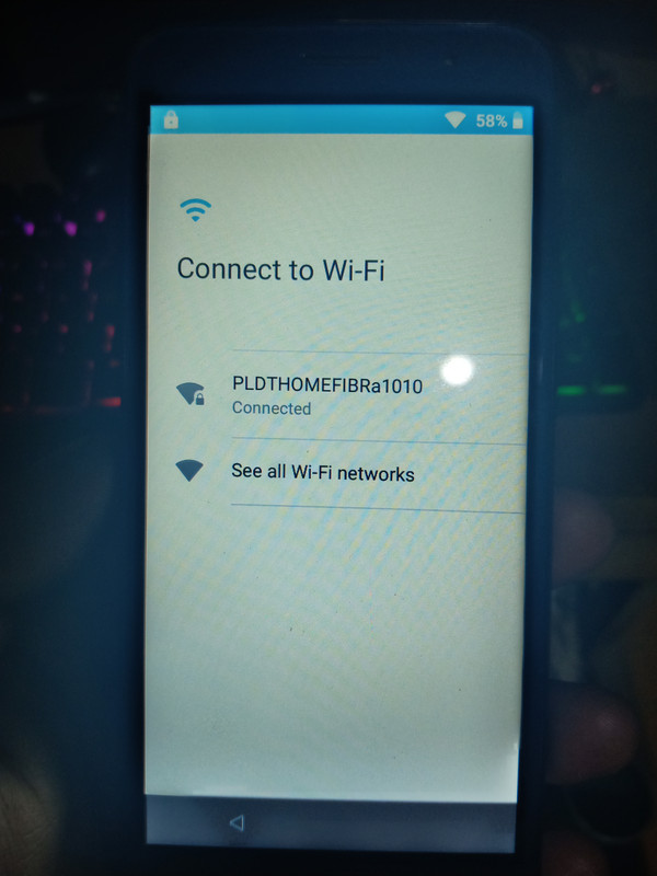

THEN SEE THE PICTURE BELLOW
AYAN O MAY SKIP NA SYA :o
PERA NA MGA KAPATID.
MARAMING SALAMAT. SANA MAKATULONG SA INYO :) :) :)
