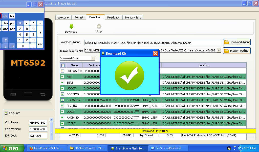

FIRMWARE TESTEDhttp://www.mediafire.com/download/5a33kz16nq0h2oq/Flare+S3+Octa+Tested.zip
password erickzon19
ito version ng flashtool na ginamit ko SP-Flash-Tool-v5.1532.00
download niyo na lang ditohttp://androidmtk.com/smart-phone-flash-tool

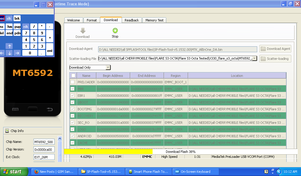

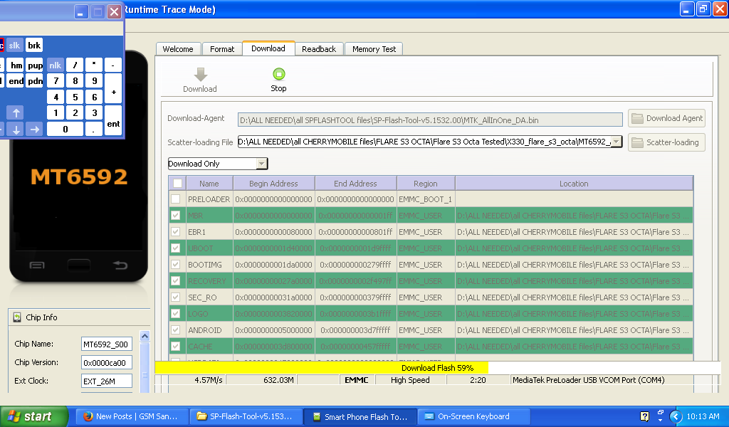

Procedure
1.Open sp flashtool and load firmware
2.Select download only and press volume down para madetect ng pc.
3.Wait until finish ok!
download only
process
done na po sa flashing
ayos ito boss kalaku sira lcd .. sa charging lang pala heheeh ;-)
