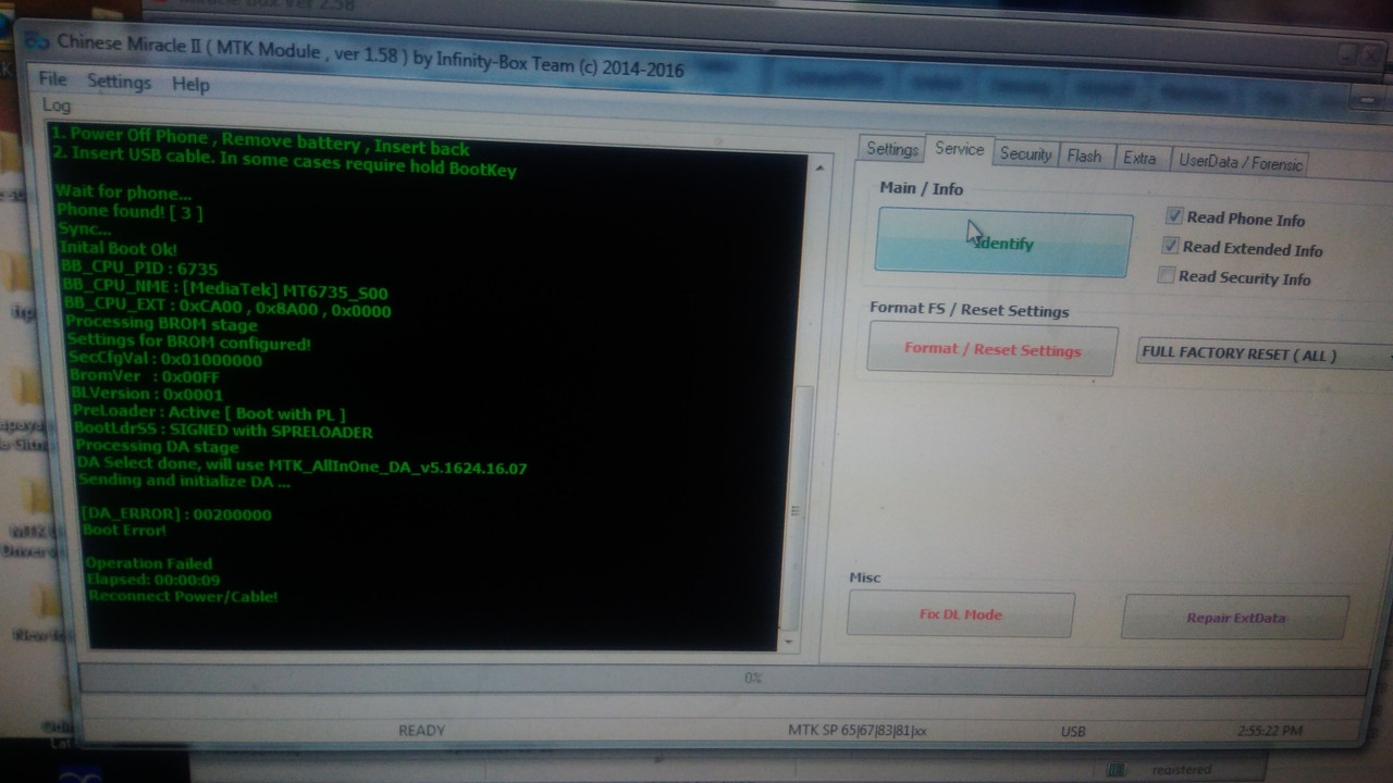

bossing theo salamat working po sakin ginamit ko ung firmware mo sa nck gmana nung una ayaw kasi may mali pala sa procedure ko need pala hold volume up pag d kasi hhold si up nagffailed

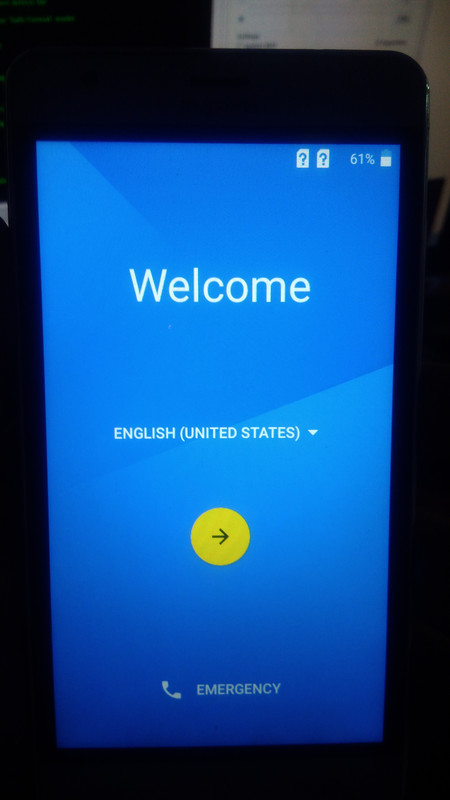

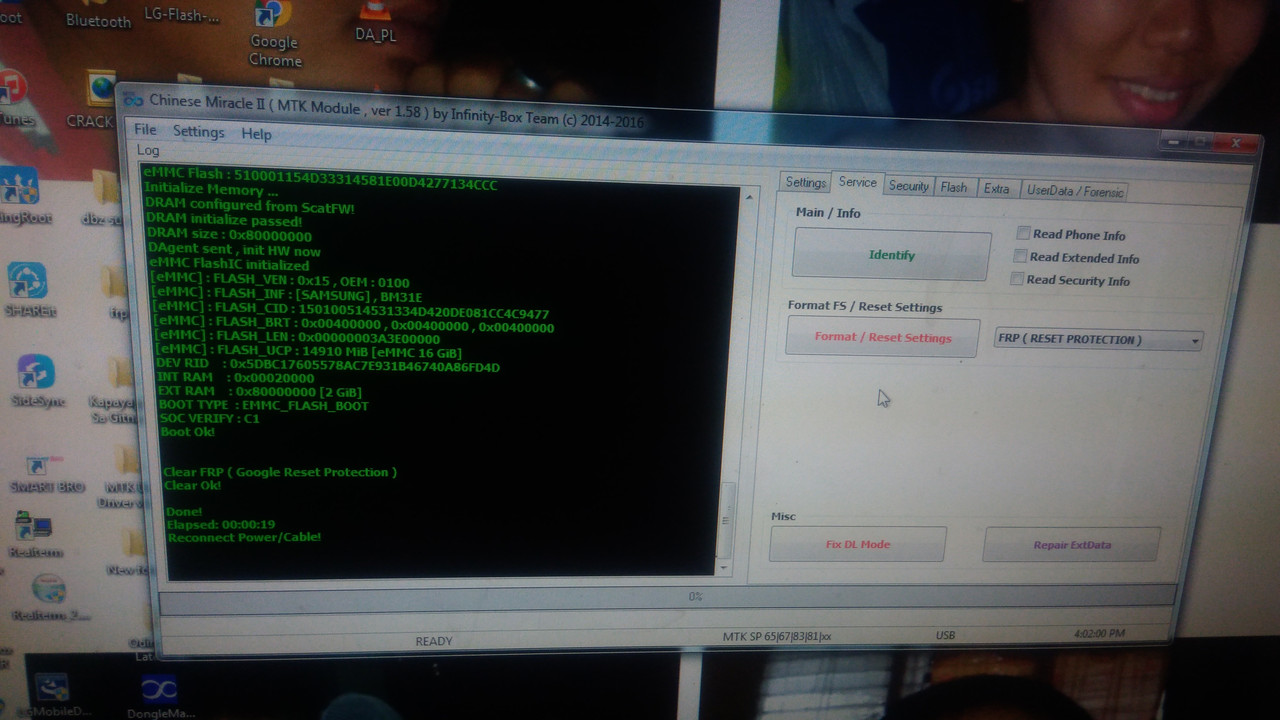

ito result ng FLARE S6 ko
Flash style: EMMC
BLOADER HEADER: MTK_BLOADER_INFO_v20
Preloader: preloader_c509_cq_7151h_n_37m35.bin
Error: S_FTHND_FILE_LOAD_FAIL
Block Size: 0x20000
Reinsert phone battery.
Battery must be charged.
Phone must be off with battery inside.
Please insert USB cable now...
Detected : MediaTek USB Port (COM30)
Phone detected...Please wait
Sending DA agent, please wait...
BaseBand CPU :MT6735M_S00
BaseBand CPU Secure Version : 05
BaseBand CPU Bootloader Version : 00
INT RAM: 128 KB SDRAM
EXT RAM: 2 GB DRAM
EMMC: (116Gb+16384Mb) SAMSUNG 0x514531334d42
EMMC FW VERSION: 0d:00:00:00:00:00:00:00
EMMC CID: 15010051453133 : 000000000000000000
EMMC UA SIZE: 0x3a3e00000
BOOT STYLE: EMMC BOOT
FULL LENGTH: 0x3a4a00000 [14.572 GB]
Detecting high speed port, wait......
If driver not installed, install high speed port driver.
If not need high speed port, disable it.
After repeat opperation.
Detected : MediaTek DA USB VCOM (Android) (COM42)
Checking data....wait!
FORMAT EMMC FLASH : BEGIN: 0x6a80000 - LEN: 0x100000
FRP Reset Done.
Wait untill phone will start charging.
All done.
