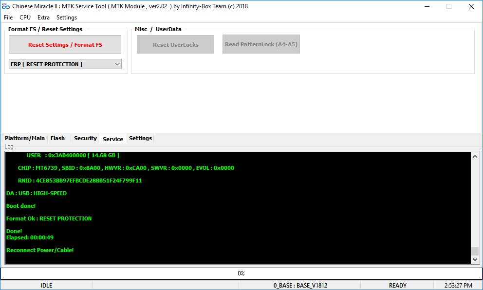

open cm2mt2
select base v1812
click identify/connect
connect phone to pc
select service
select frp (reset protection)
click reset settings/format fs
connect phone to pc
wait until done

Format Ok : RESET PROTECTION
Done!
Elapsed: 00:00:49
Reconnect Power/Cable!
select base v1812
connect phone to pc
select service
connect phone to pc
wait until done

Operation : Reset Settings/Format FS [ v2.02 ]
1. Make sure device is powered off. Power off, if need. Wait 20 seconds after
2. Insert USB cable in phone
Waiting for device connection ...
PTFN : MediaTek PreLoader USB VCOM_V1632 (Android) (COM17)
MODE : PRELOADER PORT
PORT : 17
Waiting BOOT ack ...
PRELOADER : ACK confirmed!
BROM : Init BROM
BROM init passed!
CHIP : MT6739 , SBID : 0x8A00 , HWVR : 0xCA00 , SWVR : 0x0000
TYPE : MODERN RAPHAEL
BROM : SecLevel : 0x00000000
BROM : SecMode : PLAIN [+PRL]
BROM : PRELOADER PORT
MODE : 0_base : BASE_v1812 | Manual : Disabled
AGENT : Look for suitable BootChain in DA ...
AGENT : MTK_AllInOne_DA.bin
AGENT : Found MT6739
AGENT : MTK_DOWNLOAD_AGENT
BROM : Sending 1st DA ...
BROM : DA sent
BROM :Transfer control to DA ...
DA : AGENT started!
DA : SYNC
DA : MODE : PRELOADER
DA : EXT_RAM initialized!
DA : BOOT to 2nd DA ...
DA : 2ND stage confirmed!
DA : SYNC with DA passed!
DA : Receiving HW info
SRAM: 0x00020000 [ 128.00 KB ]
DRAM: 0x80000000 [ 2.00 GB ]
EMMC: 150100523331424142004C2DFC85C237
EMMC: VEN : SAMSUNG | OEM : 01 | DEV : R31BAB
EMMC:
BOOT1 : 0x00400000 [ 4.00 MB ]
BOOT2 : 0x00400000 [ 4.00 MB ]
RPMB : 0x00400000 [ 4.00 MB ]
USER : 0x3AB400000 [ 14.68 GB ]
CHIP : MT6739 , SBID : 0x8A00 , HWVR : 0xCA00 , SWVR : 0x0000 , EVOL : 0x0000
RNID : 4CE853BB97EFBCDE28BB51F24F799F11
DA : USB : HIGH-SPEED
Boot done!
Done!
Elapsed: 00:00:49
