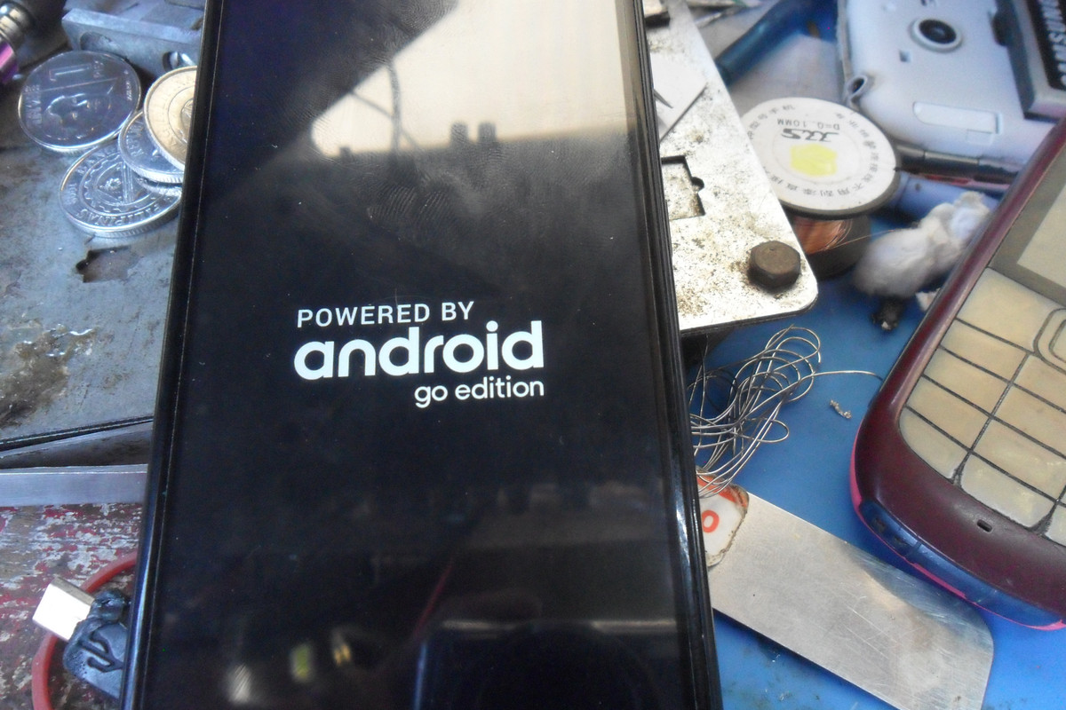

cherry mobile flare s7 prime hang on logo
closest gas station open now

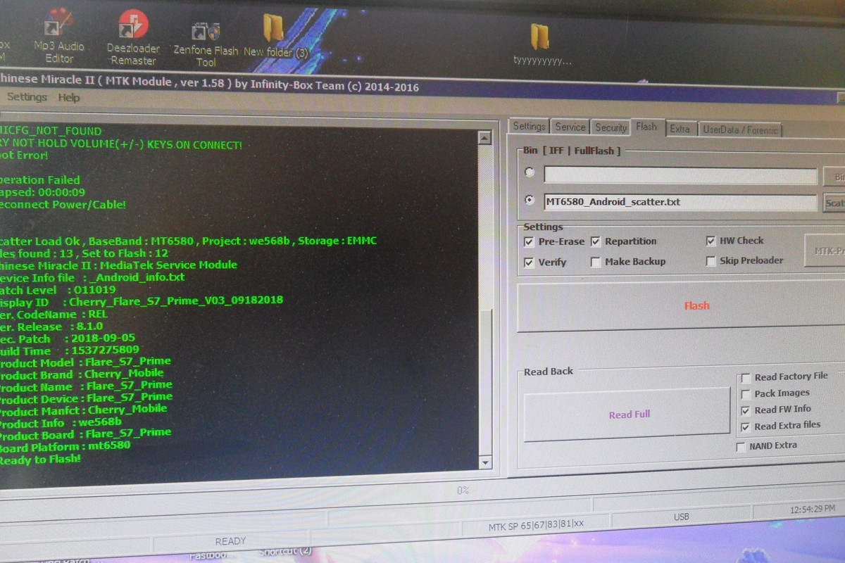

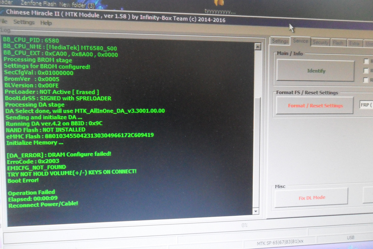

open cm2 mtk v1.58
setting mtk chips 65xxx
tick service
full factory reset all
hold volume down to boot key
salpak usb cord
suntrust bank locations map

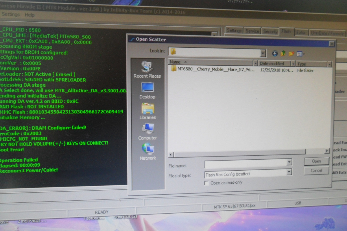

dahil DA error siya

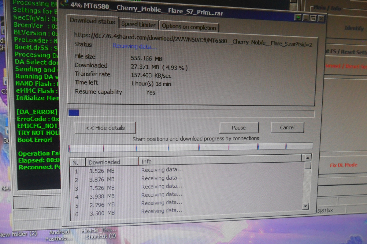

hanap ng fw
https://www.4shared.com/postDownload/2WWN5tVCfi/MT6580__Cherry_Mobile__Flare_S.html
samntalang maghing ng fw download
try natin e tricks
via kamay
press hold power button+ volume down
rare boy and girl names
open unit

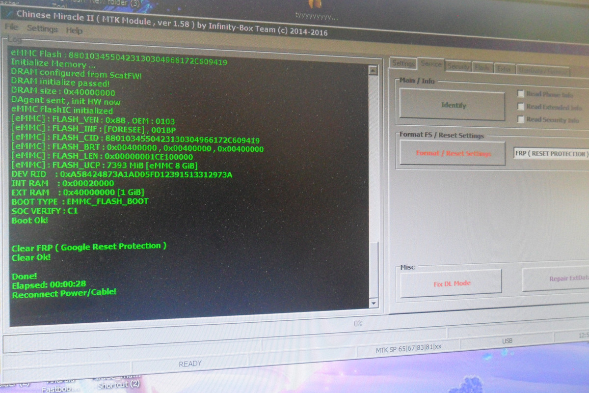

nako naka FRP yata
balikan natin si cm2
load scatter file
select frp reset
hit format
power off ang unit
hold volume down

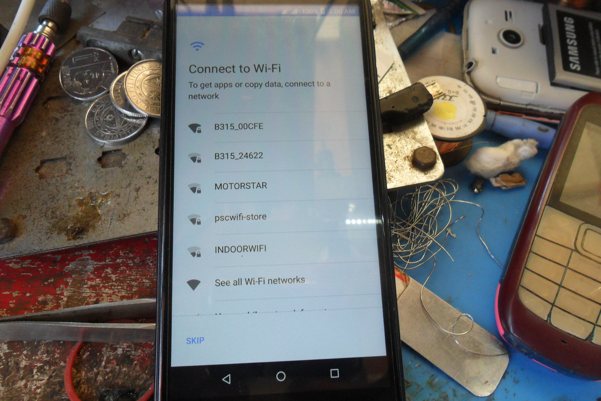

lincoln repeater location
where is the nearest fuel station
finish product

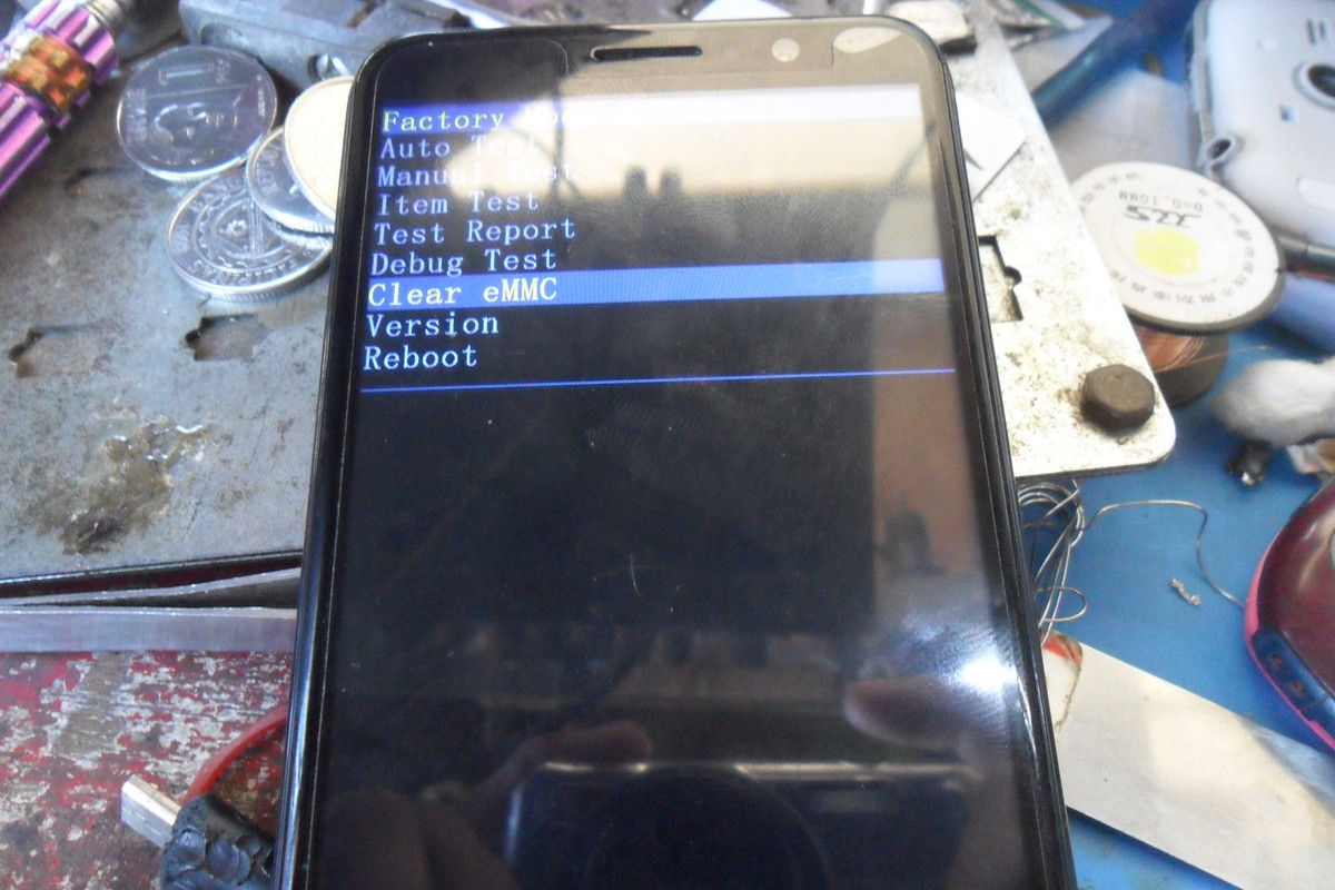

hanap ng fw

power off ang unit
hold volume down
