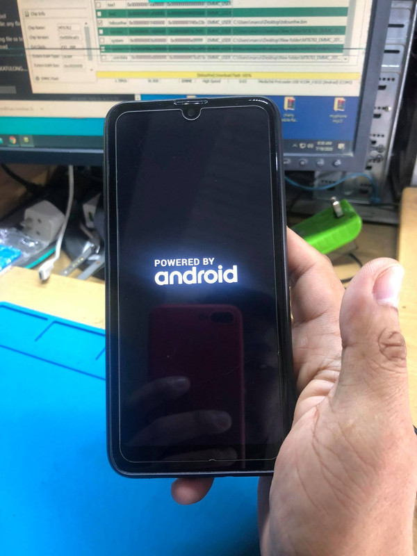

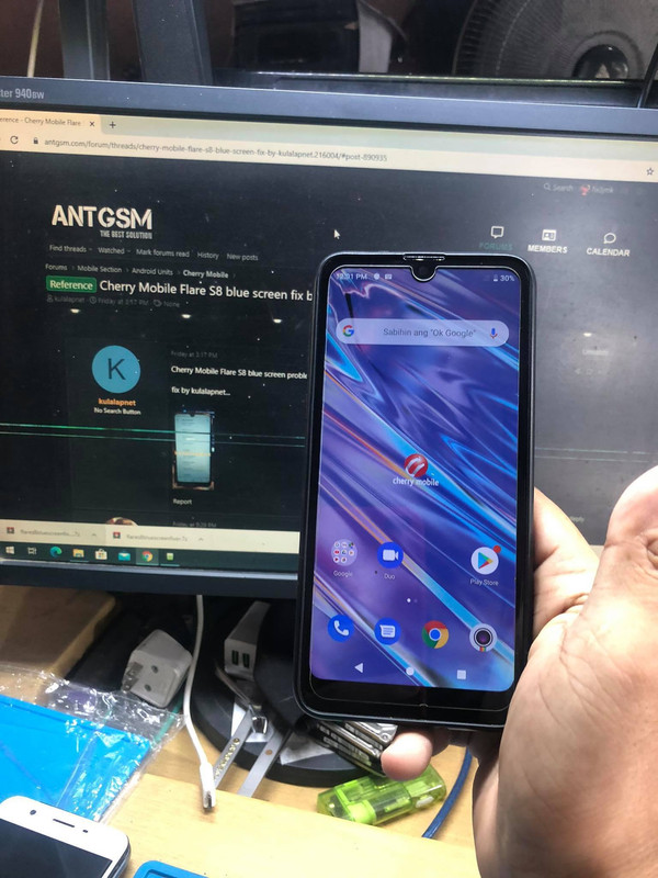

update ni tumer flare s8 hung-up na lng sa logo.. flash ko agad hndi ko na back-up kasi daming nka subok na tested, pero after ko flash bluescreen my tunog pero no display.. try ko mga tested firmware same problem pa rin.. kaya try ko
open spflashtools
load ko firmware ni boss renz102611.. FIRMWARE pero uncheck ko lahat
load ko nman teksunhw ni sir kulalapnet.. teksunhw file password: antkulaps
press download...
result
