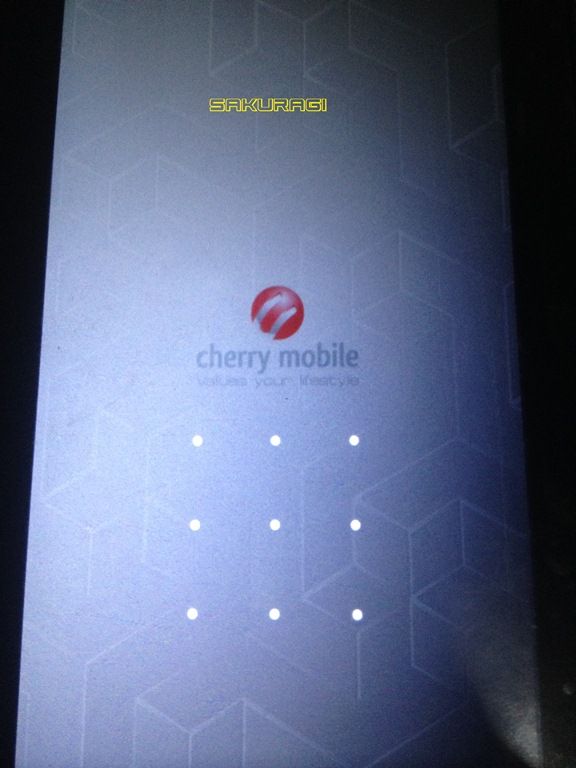

Pattern nakalimutan
Action taken:
try ko kung may HR- Negative

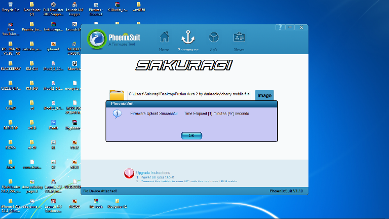

kaya proceed na agad ako sa flashing using phoenix suite
hanap muna firmware buti may nakita agad ako, sabi tested daw tong firmware na to kaya try ko agad:
https://mega.nz/#!aVclmCKJ!bAPz1s_yfNv1X24VXI0C44pyRhSJA3Ky668o4tMs28k
Result: White Screen ang unit:bash:
pasensya na di ko na kinuhanan ng screen shot

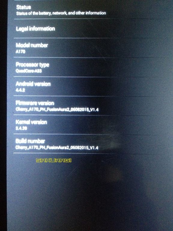

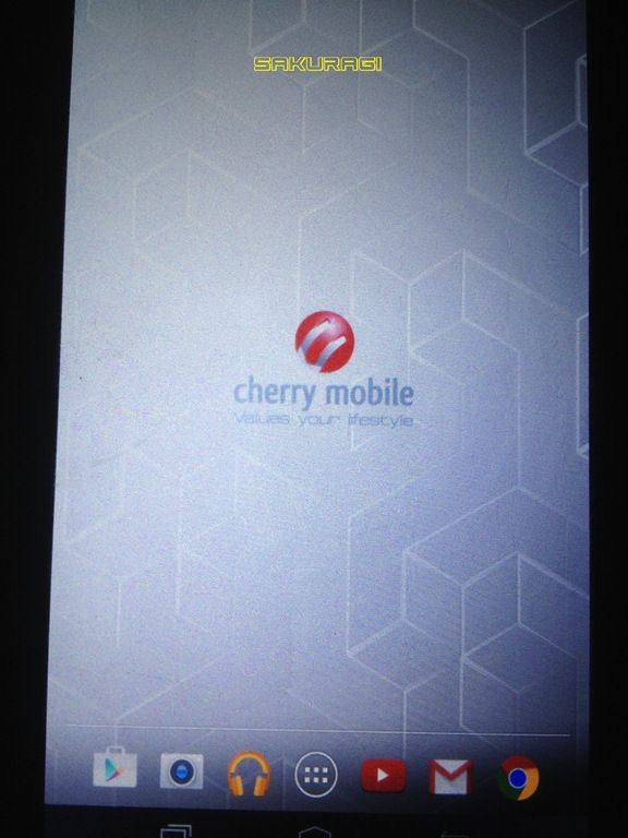

Tested Stock firmware:
http://www.4shared.com/rar/wu_n95Cgce/Fusion_Aura_2_by_darktecky.html
Password: darktecky214
credit kay Darktecky
Flashing
Done
