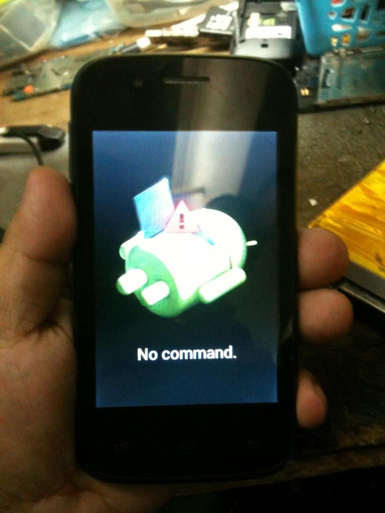

HARD RESET (Cherry Mobile Garnet)
Action Taken
1.Una Po Ay Nagtry Ako Sa Volume Down + Power At May Lumabas Select Ko Clear Emmc Na Tulad Sa Ibang Model
Pero No Luck At Nagrestart Lang.
2.Then Nag Try Naman Sa Volume UP At Power No Luck Parin
3.Try Via Wipe Using Adb Tools No Luck
4.Try Ko Sana Sa Dragon Pero Kinabahan Ako Ayaw Mag Complete Info Pero Detected As MTK
5.Eto Na Man Nakita Ko At Naging Success Press Volume Up & Power Button Then Connect Sa PC Para Lumabas Recovery Mode...
Tested Procedure
"Press Volume Up & Power Button At The Same Time Then Connect To PC Via Usb
Then After Android Logo Appear Press Power
Then Select Wipe Data Using Volume Down Then OK Using Voume Up"
Screenshot

Tested Procedure
